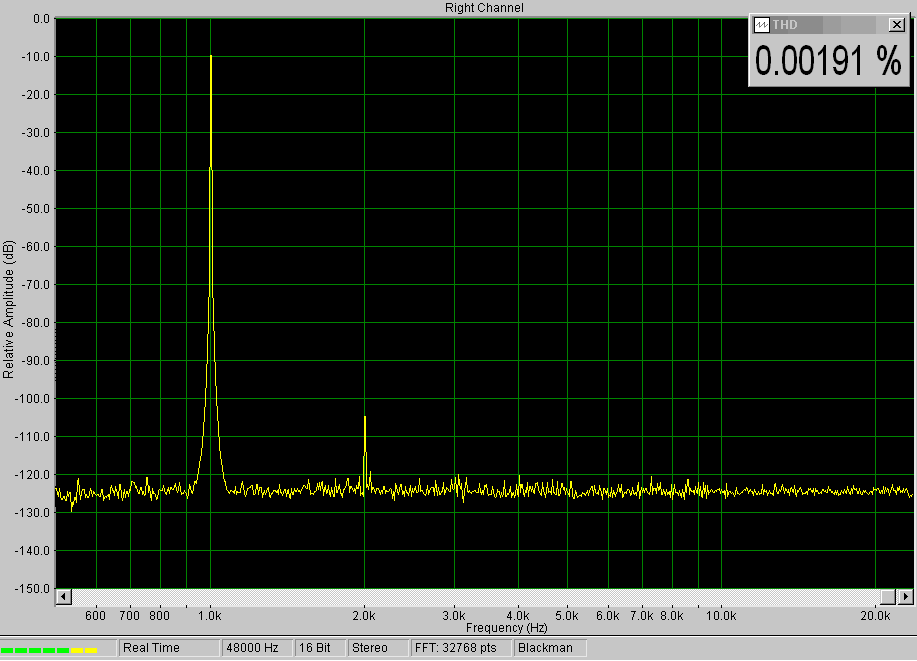

Why? VAS buffering results in better voltage drive of output transistors, less VAS loading and lower sensitivity to imperfect matching of output transistors. Output transistors are non-linear impedance load for VAS.
I guess he means the r-loading to the vas. R-loading the buffer should not have any effect, as the output impedance of the buffer is already quite low.
You can get rid of a very great amount of the unlinear load to the vas by closely matching the driver transistors. This removes the higher order even harmonics that were visible in measurings.
See attachment for version with matched drivers. (JFET-version with MJL0281/0302 as op devices) ~1W into 8ohm.

"You can get rid of a very great amount of the unlinear load to the vas by closely matching the driver transistors"
very neat trick !

Hi Mike,
You have right! I mean the R-load of the VAS. Your results looks quite nice!
