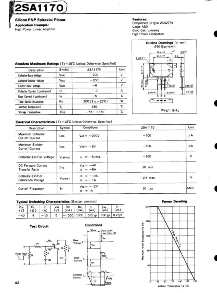

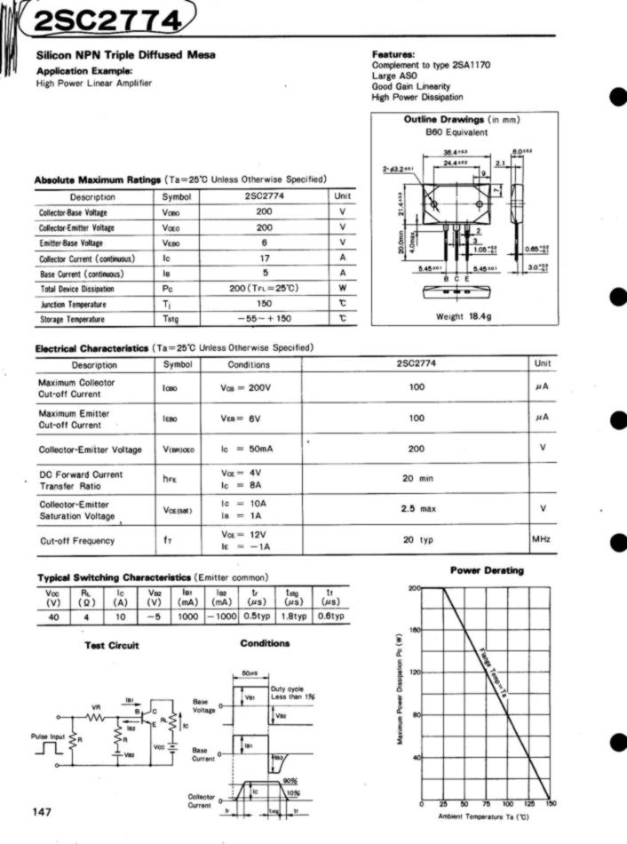

Blubbervill, i don't see problems using these Sankens, except maybe the hfe-rating. The sheet only says min 20. Output-BJTs for symasym should have at least ~100. And you might get into mechanical problems with the mt200 case.
Mike
Mike
Hi Mike,
Sankens normally have higher gain, but they may require a higher bias to get into their "happy range".
-Chris 😉
Now that may be the case (no pun intended).And you might get into mechanical problems with the mt200 case.
-Chris 😉
Sanken fits
Mike, thanks for your comment.
I don't know the real hfe of the Sanken. They where selected 4 pairs per channel +/-43V, but I can't remember the parameters. It's to long ago and I have lost my projectfiles. There is only one board left which was used for testing. Driver was MJE 350/340.
The cases of the Sanken fits perfectly when I slide the 15030/15031 some mm to the left and right corner of the board. May I do that?
But thats not the point. I ordered 2 pairs of 3281/1302 for testing.
Thats what DIY is for. Having a lot of fun and get a perfect device.
Maybe nearly perfect.
