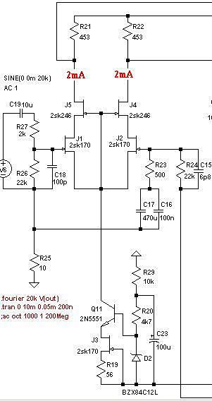

If I have 40v,can R31 and R32 be adjusted so the voltage is 36v at the pre stage?
No.
You could use a cascode pair to lock the drain voltage at some lower value, say about 10 VDC source - drain. This would have a number of positive effects. The distortion should be reduced as a side effect.
-Chris
Edit: I should expand on my two letter answer. You could drop the voltage and even regulate it lower. The result would be wasted dissipation in the output stage for nothing as you just reduced the power output. The voltage amp can only generate drive up to the supply rails less a few volts each way.
Ok,not the way to go then.
Would a 2SK117 be an option?It can take some more voltage than 2Sk170.
If not then this is the way then...
I mean without J3,as the original schema.
Maybe use 2sk 389 (LSK389)in cascode?
Hi Ryssen,
I am more comfortable with BJTs in this position. Jfet transistors will not give as defined a voltage here. Having said that, some people may get them to work. I would want to nail the drain voltage right down so we don't have any secondary drain - source voltage dependent variations.
-Chris
