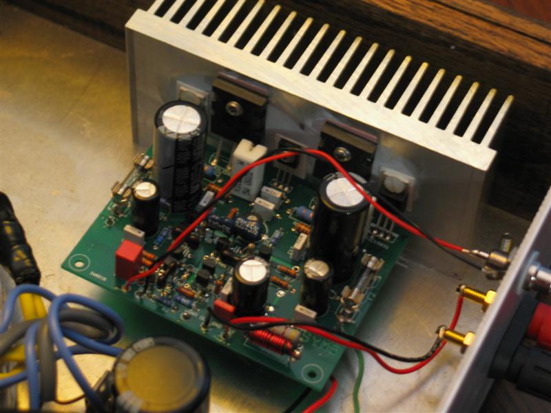

finally gave it symasym a try. just grabbed the gerbers off the site and fabbed as not much more to have some made than for me to reload on etchant and copper etc, plus i hate the drilling. probably unload the remainders.
nice sounding, i like the clearness and transparency. bass clean and defined. not slamming my speakers low end but very good quality sound and goes deep as needed.
thanks mikeb
thanks mikeb
