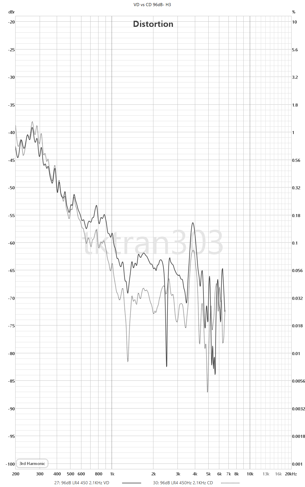

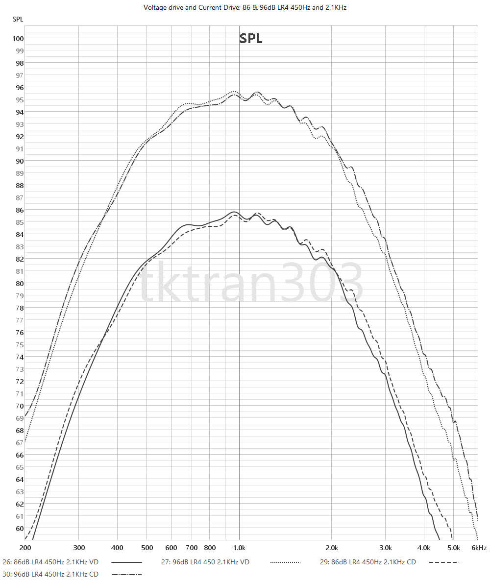

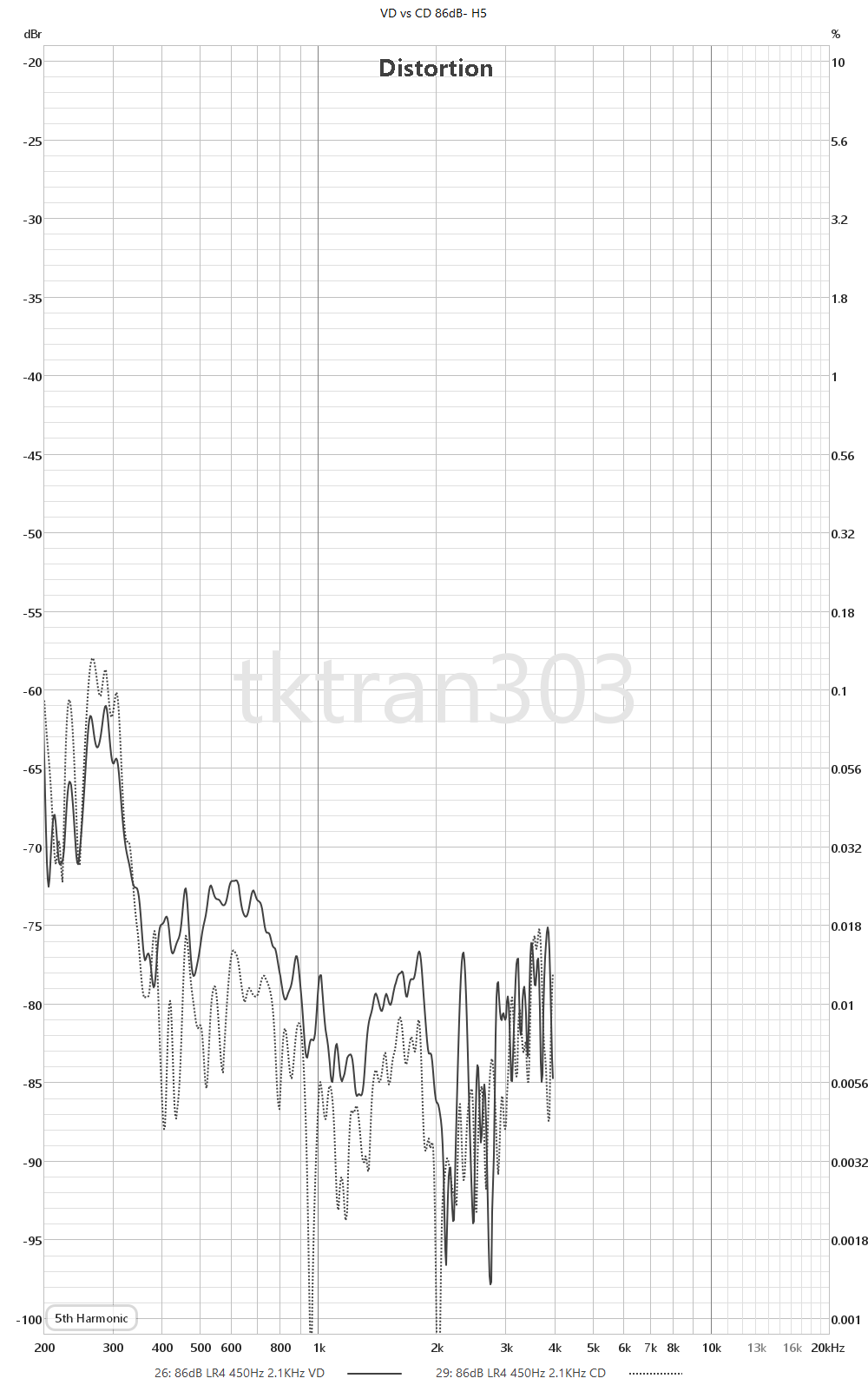

NEXT UP:

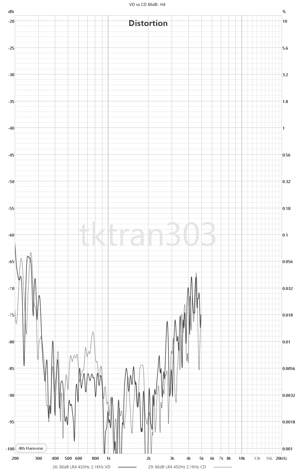

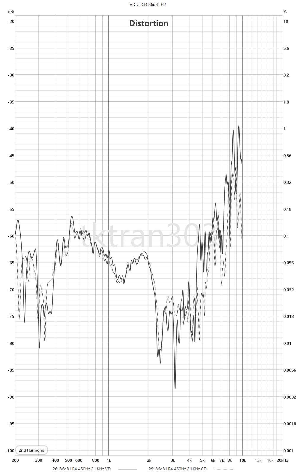

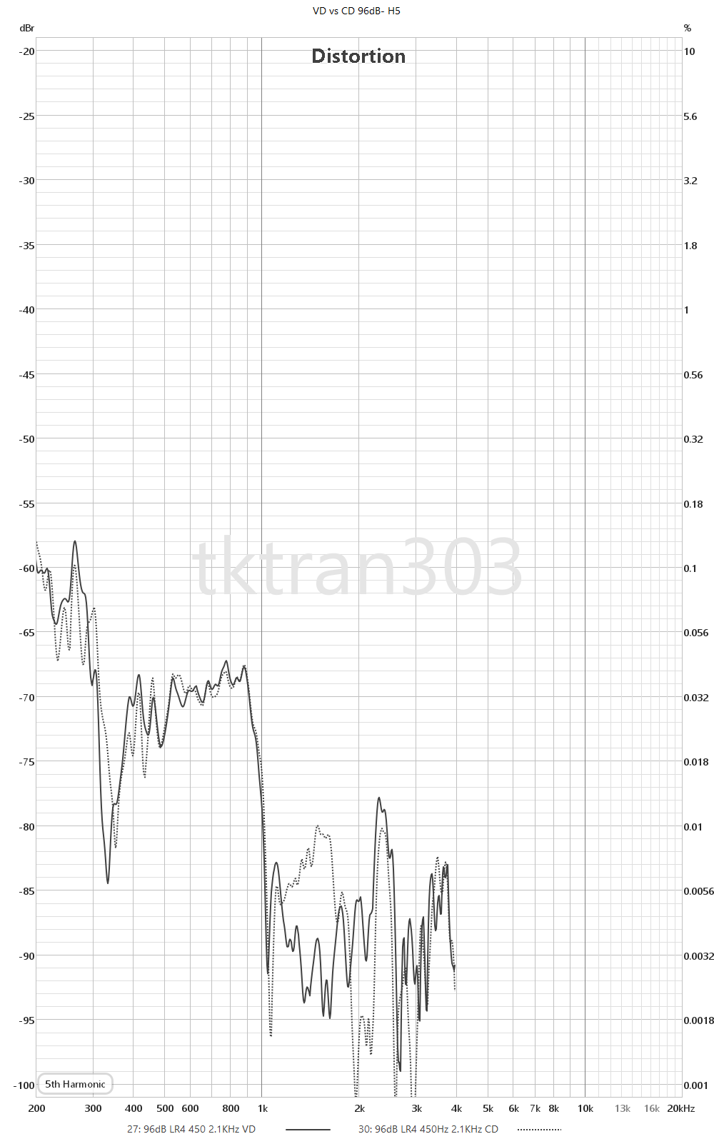

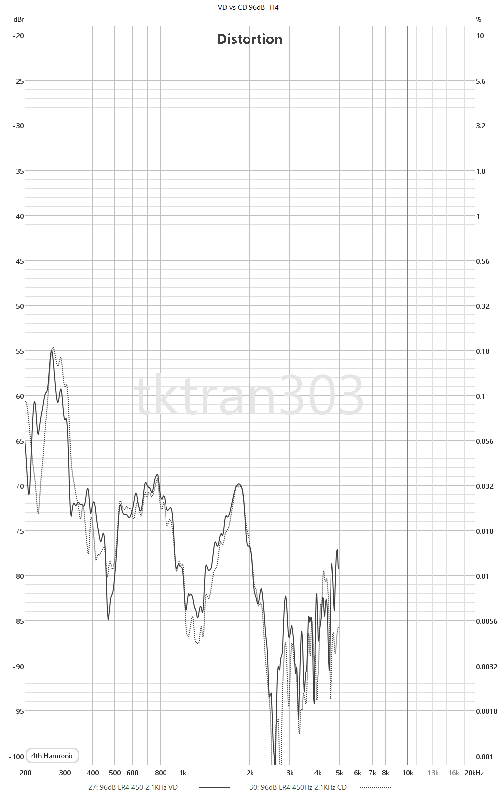

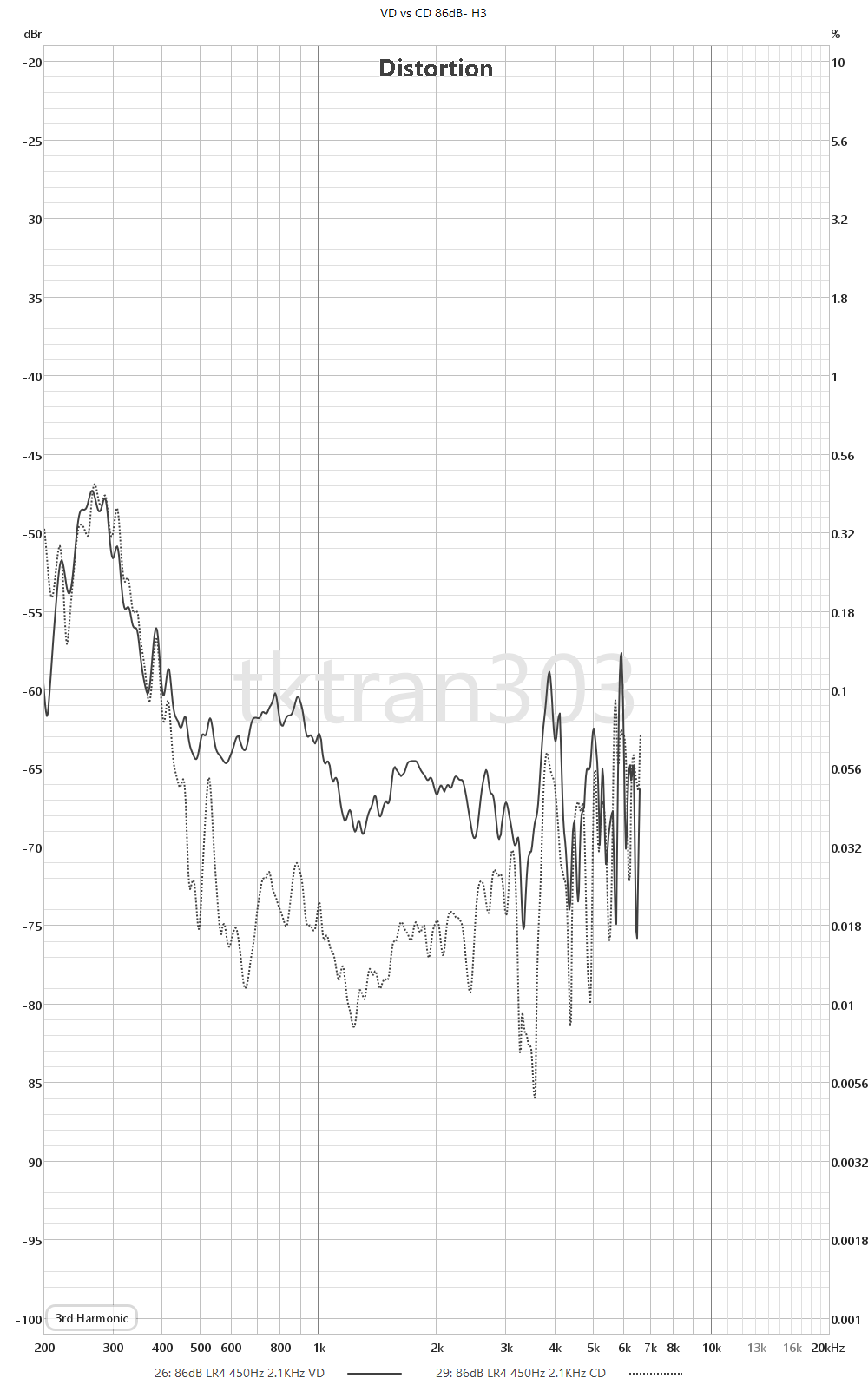

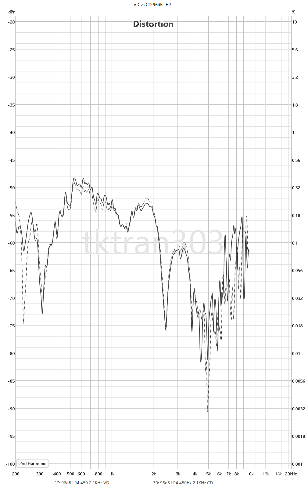

KEF Reference 1 META
(2022 release) A veritable post COVID bargain at only at £7500 / $8999 / AU$15,000
The audiophile press love it
This time I will cut to the chase, but if you are uncertain about how to interpret these graphs please refer to this post
Comparison at 86dB
Comparisons at 96dB
Test conditions:
B&K 4191/2669/2690 mic @31.6cm, SPL shown for 1m
Audient iD24 audio interface
Hypex UcD400 mono amplifier
clean Mac mini (2024, M4); REW 5.40β80

There are ways to reduce H3- current drive, or copper sleeve ?
