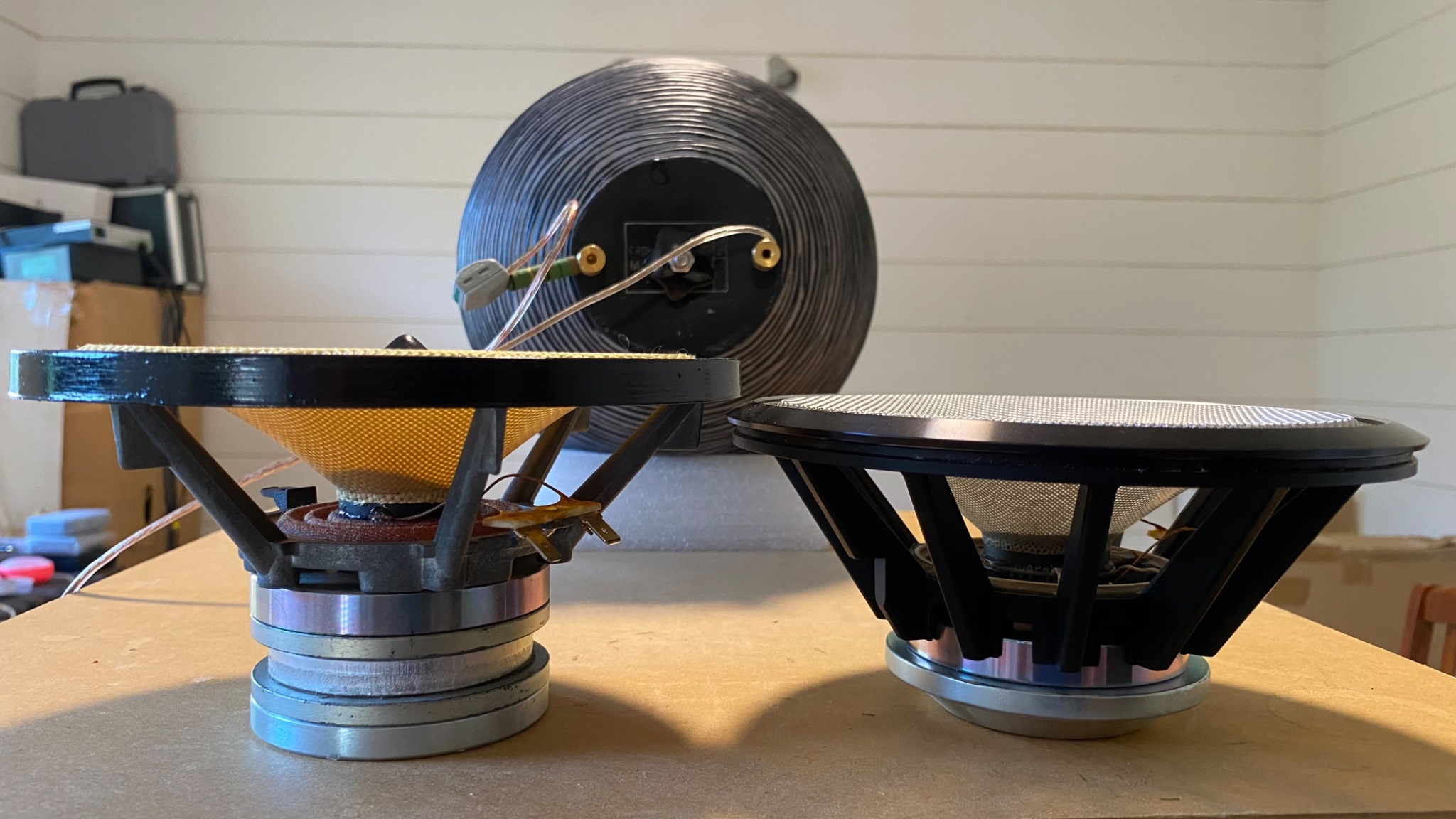

LEFT: B&W 6" FST midrange from 801D4 (2021)
RIGHT: B&W 6" FST midrange from B&W Sound System (2014)
Spheroidal enclosure in background, with Eagle branded non-inductive resistor, 27 ohm, 10W series resistor.

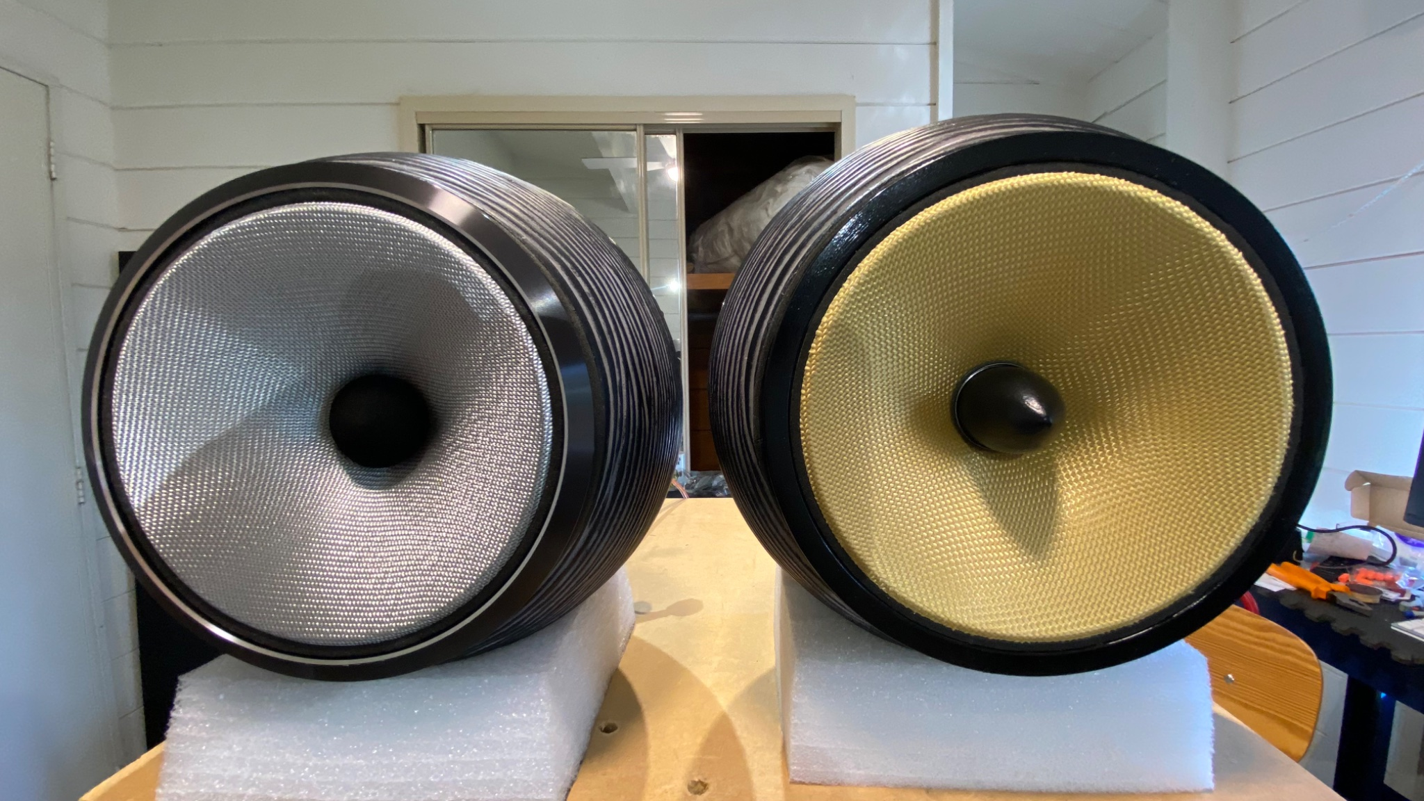

Here's the front view- showing both mounted in spheroidal enclosure:

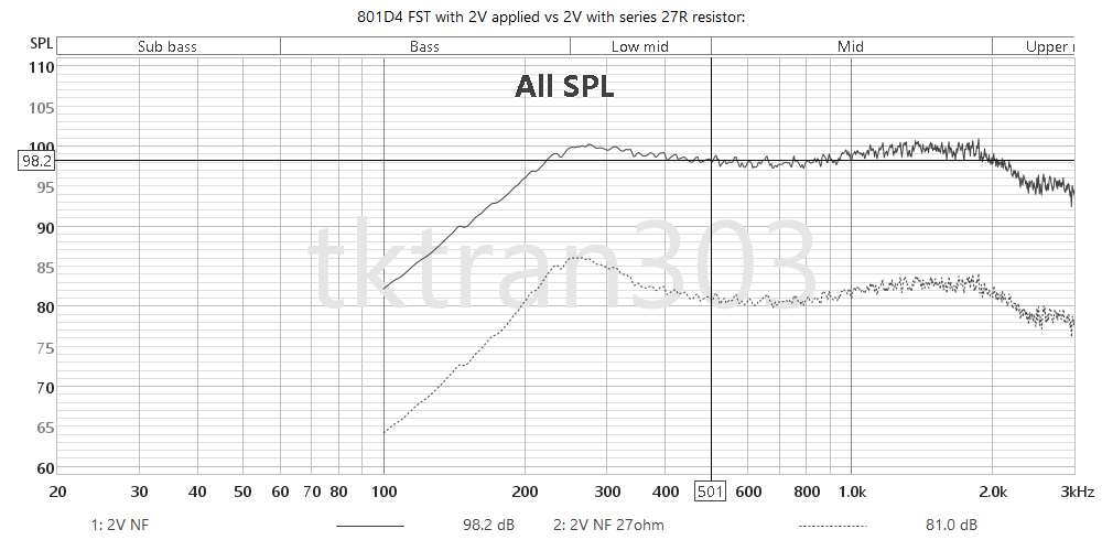

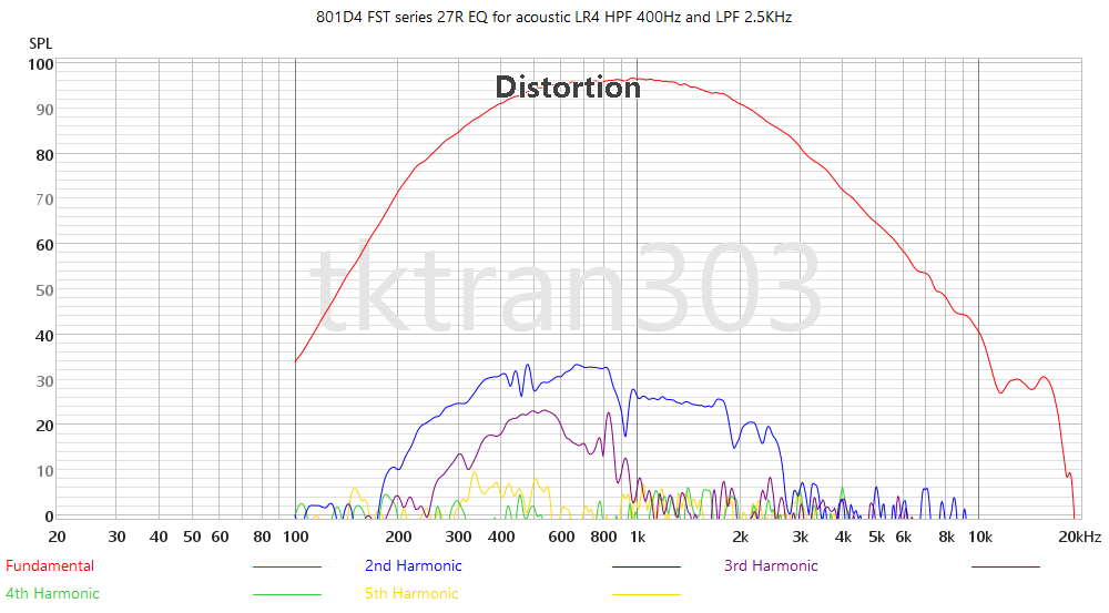

Let's start with the 801D4 6" FST (Left), and we apply an exponential sine sweep at 2V.
That's a "low distortion" driver, except for what's happening below 400Hz. You would be forgiven for that, after all, this is a midrange, and design for use above 400Hz
Let's connect the resistor (as pictured above) in series with the positive terminal of the speaker. For convenience, this is done externally, but of course there's no difference if it's done internally, after the (non-magnetic) binding posts. Here I show it in black and white, to help delineate differences:
Looks like we do lose a lot of voltage sensitivity (17dB!) And there seems to be a peak around 250Hz.

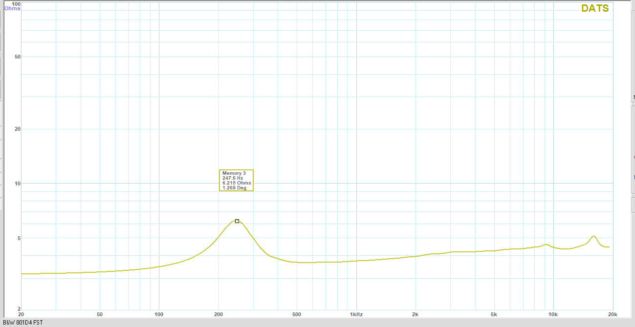

Here's the impedance sweep of the driver, in free air:

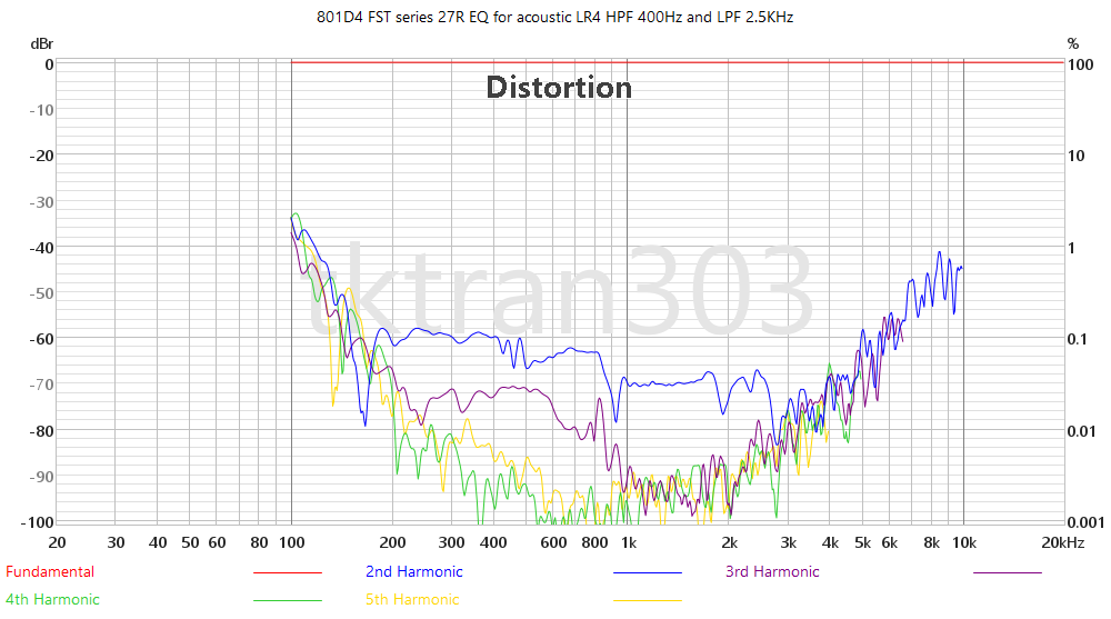

But we need to compare apples with apples. Now now we apply some EQ to correct the frequency response changes caused by the 27 ohm series resistor.
Ahah! As we say in Australia, now we're cooking with gas!

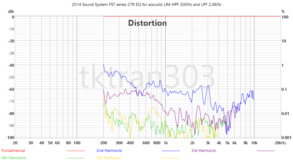

Let's add some EQ, like you would do in a speaker:
Can we view this another way, that some of friends prefer:
How does that compare to a 96dB "standard" that some of our friends, eg. @bikinpunk likes to measure at.
Here's a 6" FST, as used in the 800 series 4 centre channel: appropriately named HTM81:
What do you think? Does "current drive" have any merit/promise?

Similar process and measurements with the FST from the 2014 B&W Sound System without commentary​

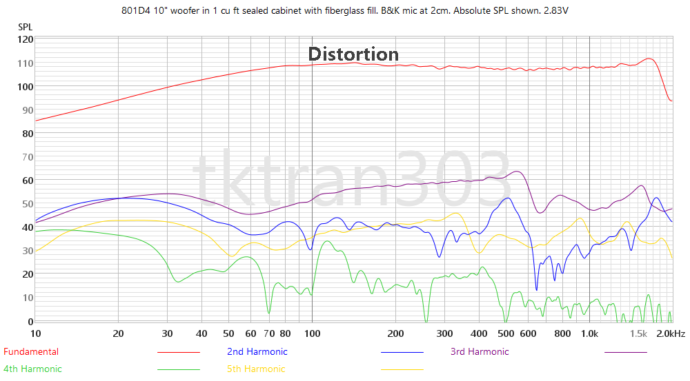

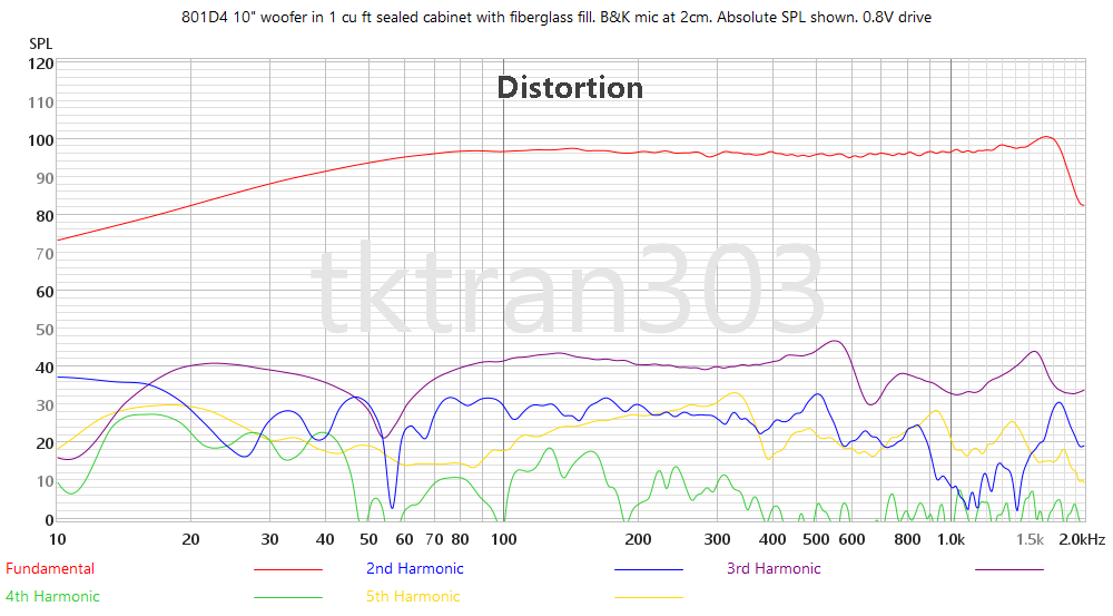

Here is a 10" woofer.
Free air impedance trace are below:
Is this a small woofer? It's a 10", as used in this speaker: (801D4, parallel in pairs, ported)
But just one, and placed into a 1cu ft sealed test cabinet with, say, medium fiberglass fill. *
The mic is in the near field, with the wide open (1000ms). Absolute SPL shown (no correction for distance applied)
Here's a few levels, first voltage driven, then with a couple of 20 ohm 10W resistors in parallel = 10 ohm, 20W continuous power handling.
Attempts to EQ the "current drive" amplitude response as closely to the the voltage driven counterparts.
It’s about +/- 1dB for most of it, which I think is useful enough. We’re really interested in only below 150Hz, as you say, but I though I would include higher, so we can see the increasing imprecision of nearfield measurements (fuzziness increases as increases)
Voltage driven at 0.8V ~75dB @100Hz @1m (2pi)

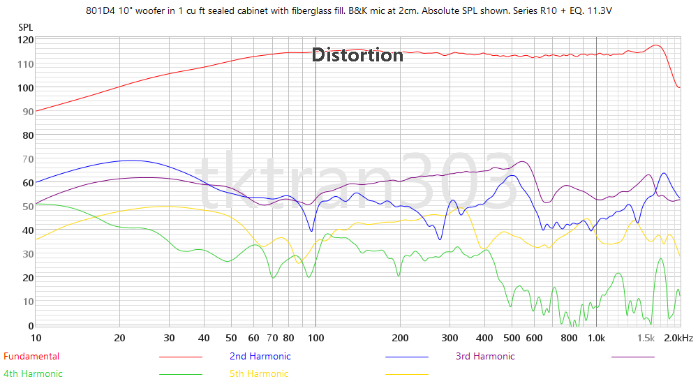

Insert the 10R resistor, EQ for same response, then feed it 1.42V to match the fundamental:
Now 2.83V: 86dB @100Hz @1m (2pi)
EQ and "current driven"
5.65V voltage driven: 92dB @100Hz @1m (2pi)
Current driven:

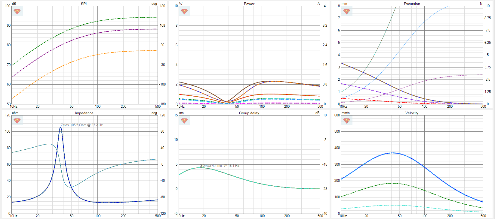

VituixCAD2 simulation with 6-pack showing simulation at 0.8V, 2.83V and 5.65V in voltage drive mode.

Conclusion: The use of a series resistor (or a simulted one) would still allow some damping around fs while showing significant distortion reduction. This could be interesting for the use of low-Q drivers in closed boxes.

Hi, you can play around with this in VituixCAD enclosure tool, there is the Rs field in the filter tab.
Electrical damping is lost quite fast as yoibstart increase Rs, so if you need electrical damping use series inductor instead.
You could also replace electrical damping with mechanical, which you can experiment with VituixCAD enclosure tool as well. If you add the Rs, try how much you need to increase enclosure size, add damping material, and possibly make the box leak, to restore similar Q. Design your box with the particulsr series impedance, doesn't have to be zero as it is by default on all simulators.
