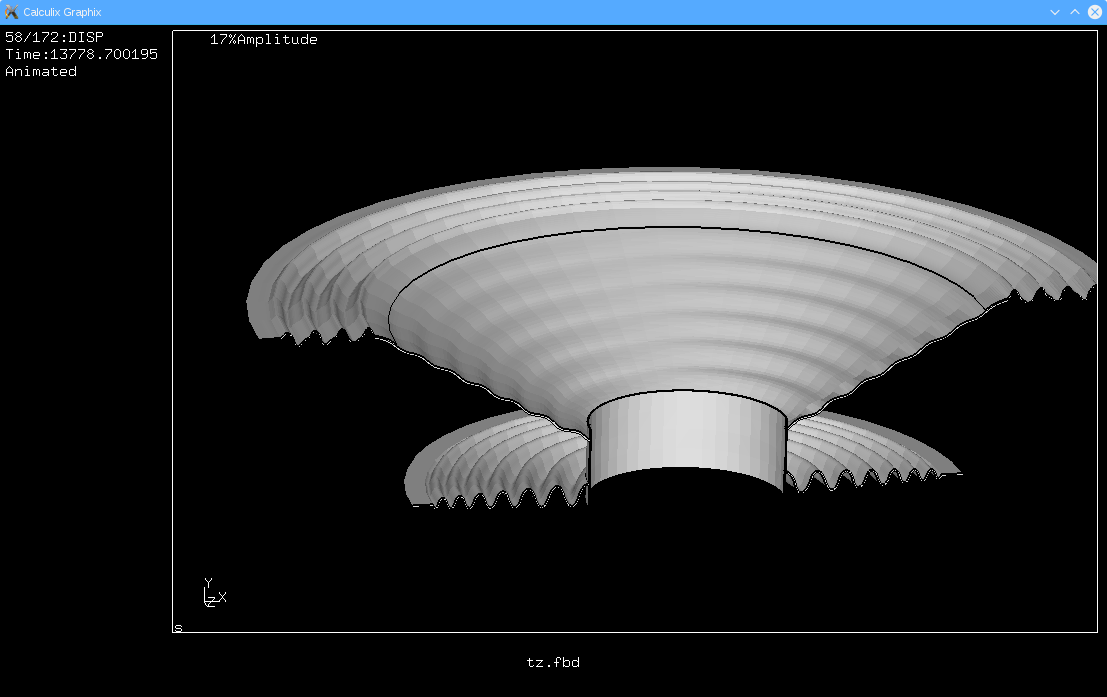

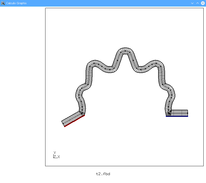

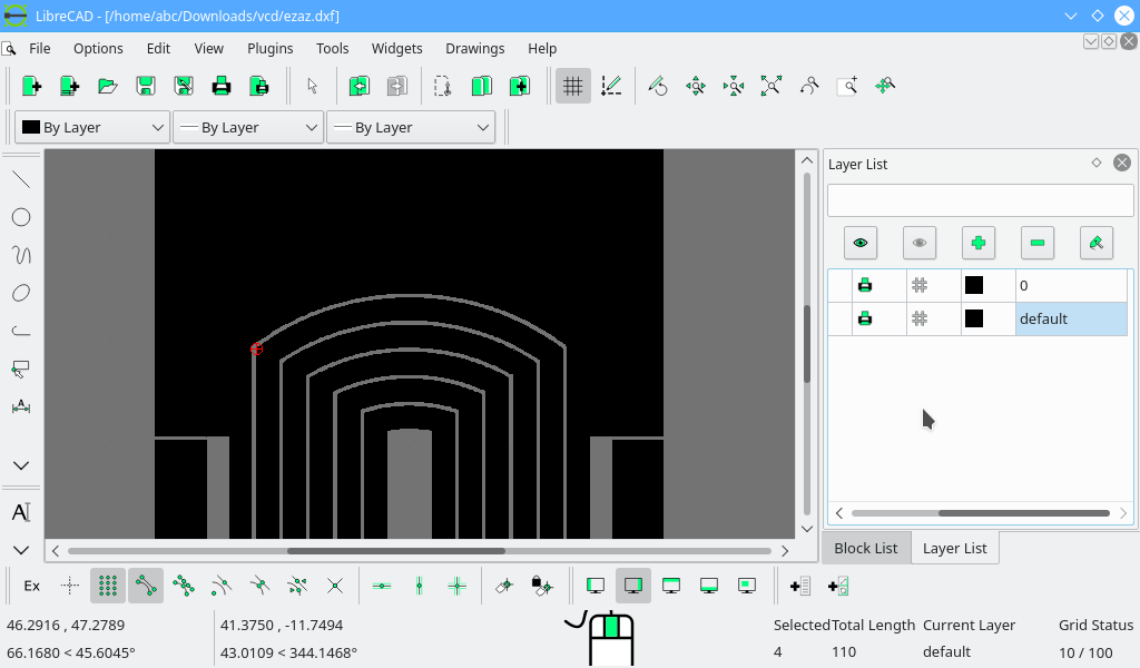

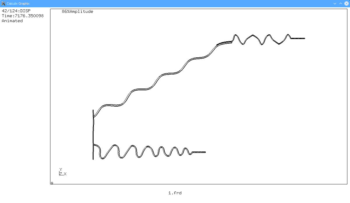

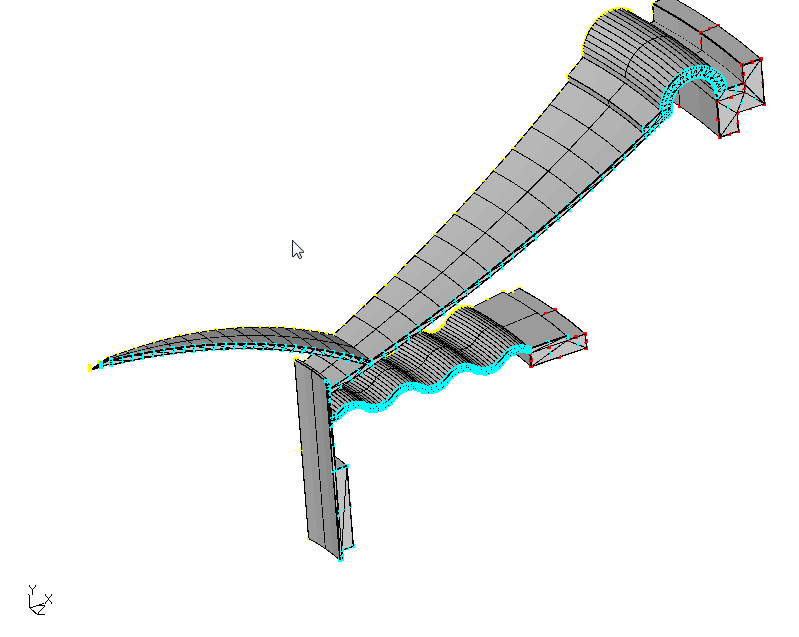

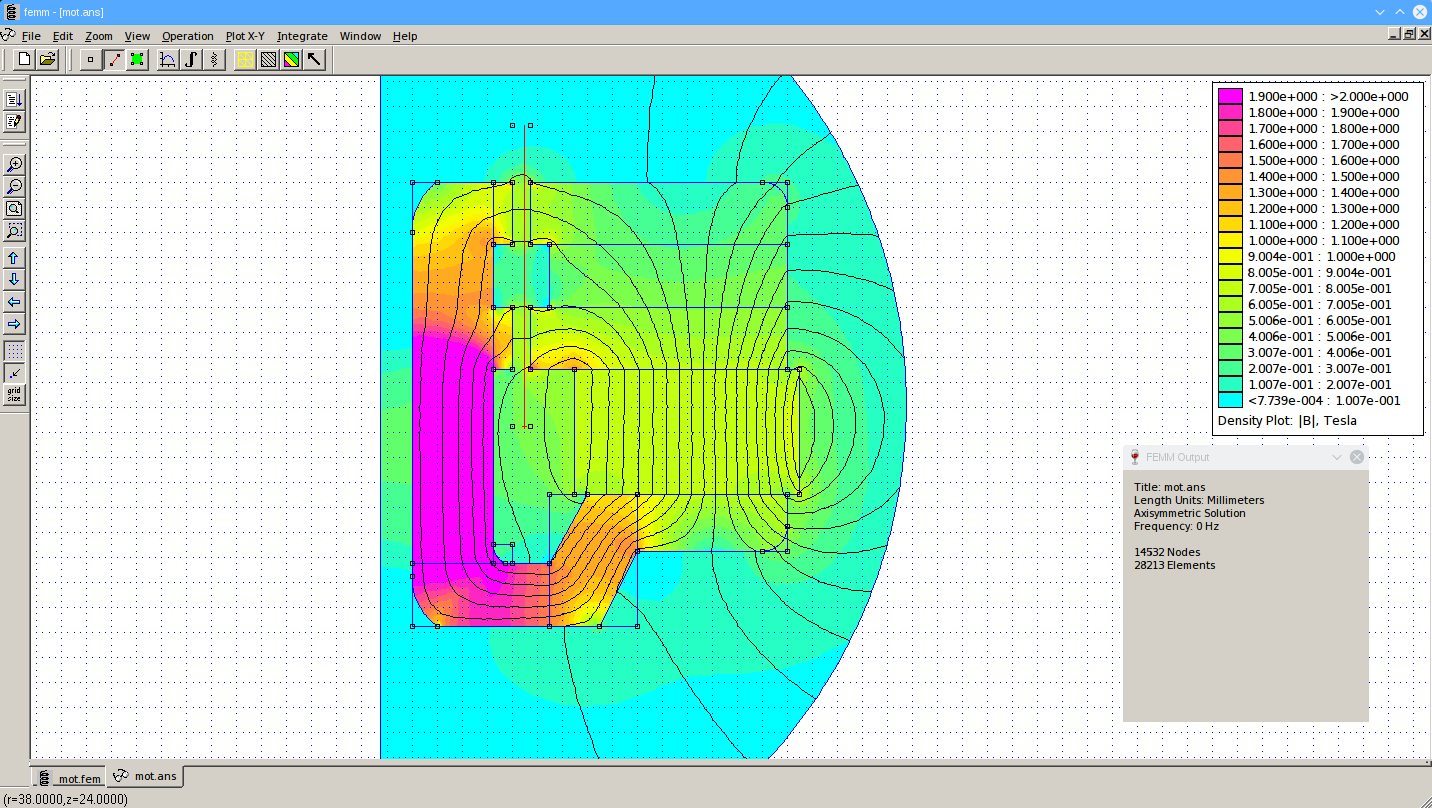

I use custom software. We have compared it regularly against COMSOL. What is custom about our software is the wrapper. We use FEMM4.2 for the magnetics, and Calculix and Z88 for different parts of simulating a cone or the spider.Do you have access to COMSOL?
A legitimate COMSOL license is prohibitive to pay for as a small company. We've been running our software since 2018 and designed nearly a hundred drivers since then. Our simulations come out very close to the real article. And we have save the butt of a few errant COMSOL designed drivers as well.
With a bunch of research to create our software we found some interesting information regarding simulations on the Opensource software versus COMSOL. With attention to the input details the answers are identical. The math behind the scenes to create the simulation is identical. The only difference is that FEMM 4.2 simulates in 3D but displays in 2D.

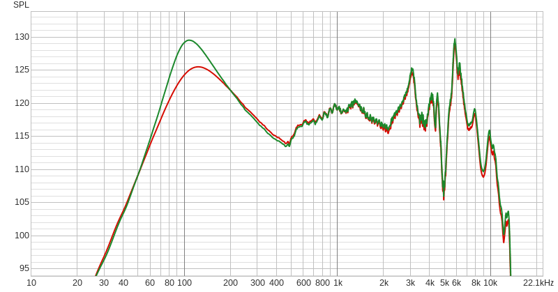

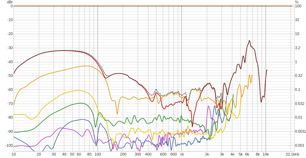

You've probably already seen this, but Purifi has demonstrated reduced distortion with the PTT6.5X04-NAA-08 via increased drive impedance (series notch filter). The paper cone version does seem to have somewhat higher distortion overall through the midrange; perhaps motor nonlinearities don't dominate in that particular driver?Current drive seems to have no effect on the PTT6.5X04NFA.

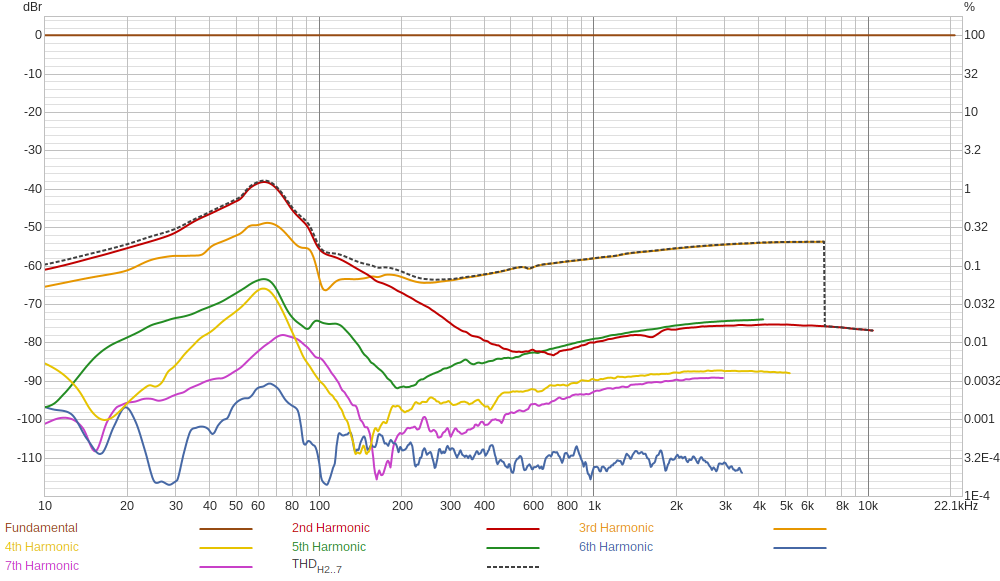

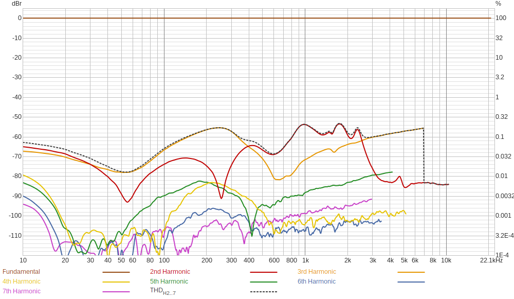

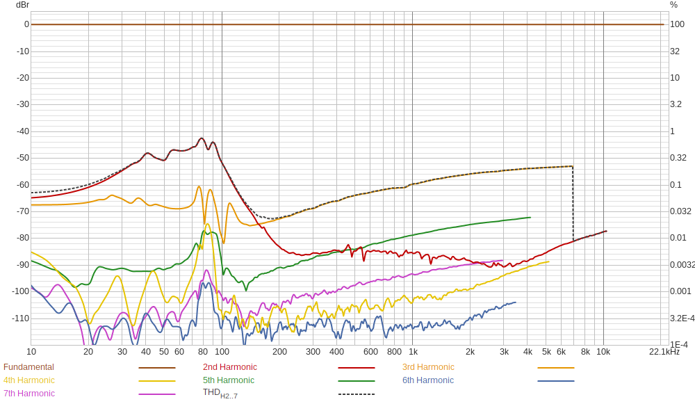

I did a couple measurements of a woofer with a copper sleeve (buyout Tymphany AULA02014-0006) showing the effect of source impedance. The amp is a simple LM1875 chipamp with variable output impedance (originally designed for electric guitar use) and the mic is a cheap cardioid dynamic.
Low driving impedance (about 9Ω):
High driving impedance (about 70Ω):
These are with "Use harmonic frequency as ref" selected. Corresponding frequency responses (uncorrected; LF boost due to proximity effect):

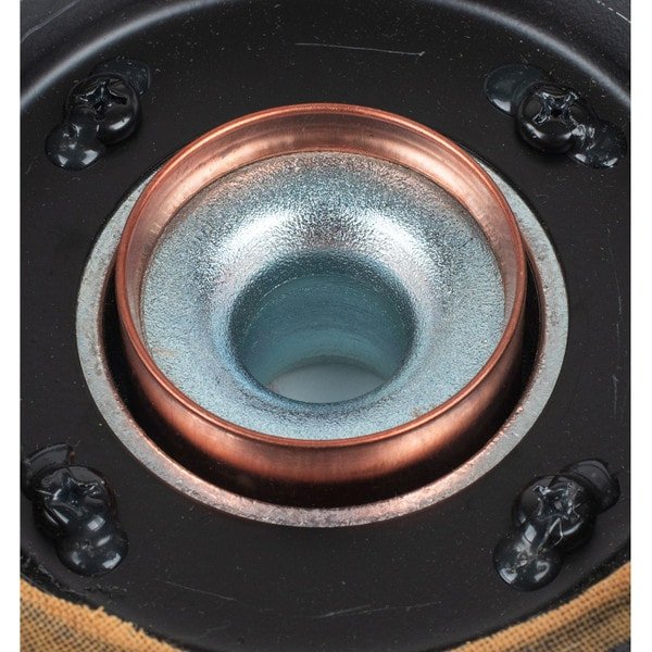

Here's a photo of the pole piece, taken by Parts Express:
There seems certainly an improvement with the AULA02014-0006.
My hypothesis is now that the thickness of the copper sleeve may be factor.
To verify this, other drivers with thin copper sleeves could be tested eg. SB17NAC, MAN061.80

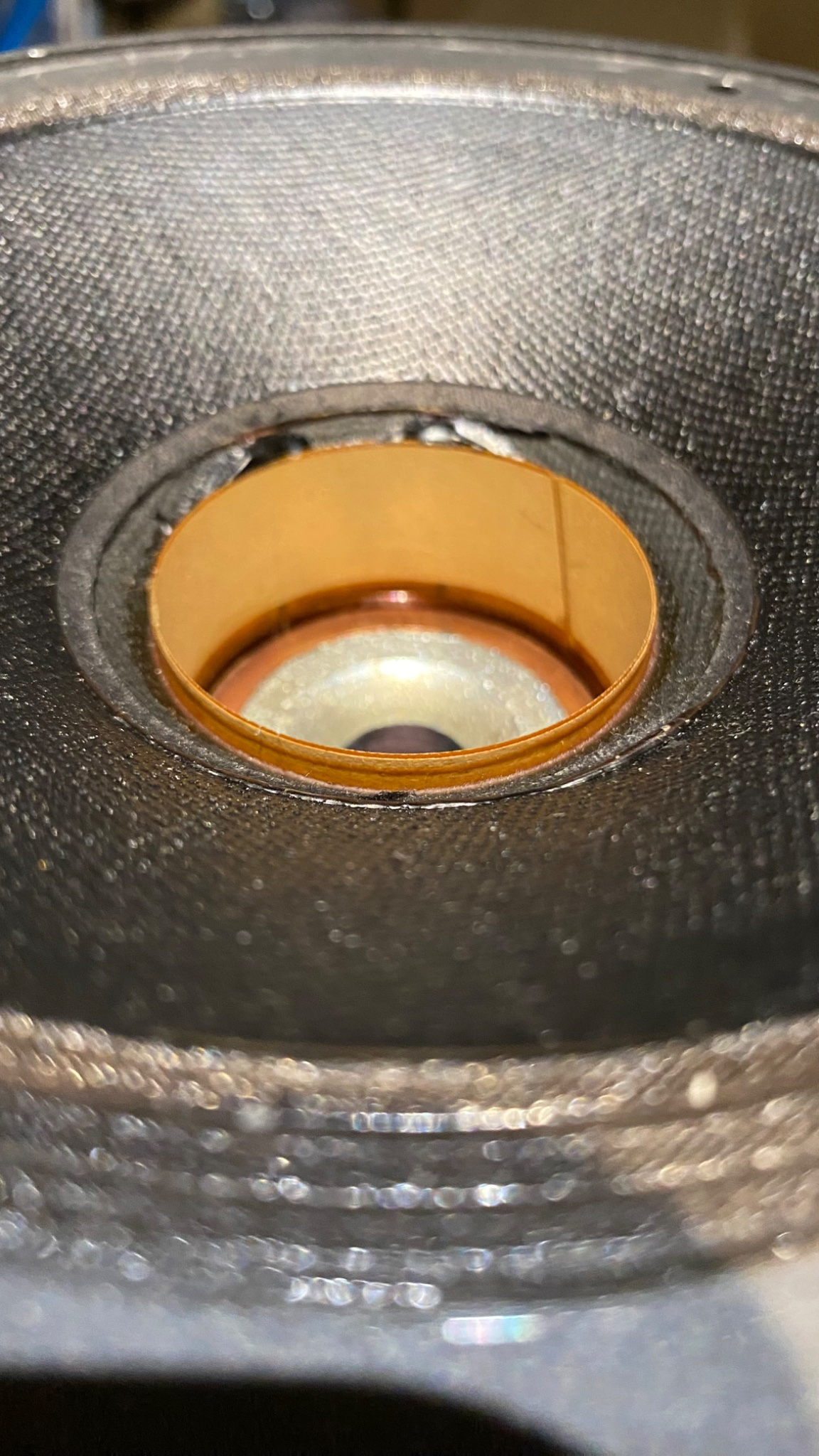

100% On a woofer anything less than 0.5mm is almost non-effective where you want the inductance compensation.My hypothesis is now that the thickness of the copper sleeve may be factor.
What is getting missed is that your motor design from the beginning will have a determining factor on your drivers distortion products.
I attached on paper that discusses this. There are a few more if you guys are interested.
High quality coaxial? If you want help you can drop me an email.And it all started because we started building our own coaxes when we couldn't find anything in the marketplace that was top flight true midrange coaxial.
Seems probable to me. The sleeve in that driver seems thicker than most (from what I've seen), but still nothing like the Purifi woofers.My hypothesis is now that the thickness of the copper sleeve may be factor.

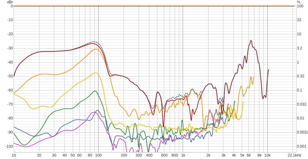

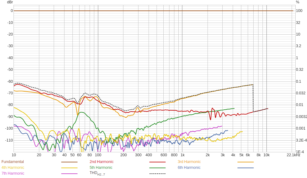

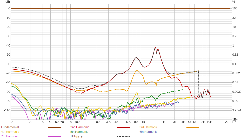

I also did some basic current distortion measurements which may be of some interest. These were done using the headphone output of a Behringer UMC1820 through a 100Ω 0.1% metal film resistor, so the drive level is fairly low.
2mH air core inductor (to show approx. measurement limits above ~200Hz):
AULA02014-0006:
Eminence Deltalite II 2512:
Old Eminence OEM 12" AlNiCo guitar speaker (model #52-8B, made in 1974):
Woofer from an old Definitive Technology ProMonitor 100 (simple shielded ferrite motor):
Celestion CDX1-1446 (ferrite HF compression driver):
Celestion CDX1-1747 (ferrite HF compression driver):
The 3rd through 5th harmonics in the AULA02014-0006 measurement have a low pass characteristic, which I'm guessing simply shows that the copper sleeve is more effective at higher frequencies. The Deltalite II 2512 has a neodymium slug magnet, but no shorting rings or sleeve (as far as I know).
It appears that the bigger magnet and higher flux density in the CDX1-1747 vs the CDX1-1446 makes a significant difference in the level of the odd harmonics, at least at this drive level.
Wow. That looks like a SB17 or SB15? Is the basket bolted to the top plate with screws rather than rivets? Can you get to them without damaging anything but the contact cement? One could add a more solid shorting ring or even a compensation coil there.There seems certainly an improvement with the AULA02014-0006.

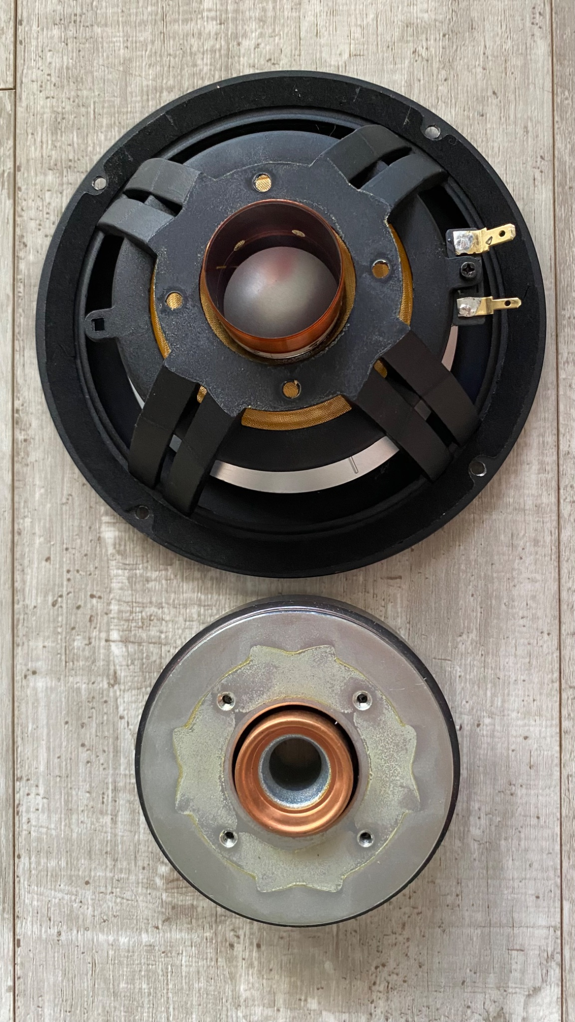

Same thing with the PPT, can you remove the basket simply by unscrewing it? Not that I'd know what to improve on that motor.
Lastly, I'm still in the dark as to what you meant by this:
"b) A driver with one (or two) air cored inductor in series will show some improvement. The level of improvement may depend on the total series resistance and how much it linearizes the impedance."
The air core should not have current distortion unless it can vibrate mechanically or there is some iron nearby. Do you think this was the case or are we seeing the limitations of the amplifier? If so, why would it increase below 100 Hz?Seems probable to me. The sleeve in that driver seems thicker than most (from what I've seen), but still nothing like the Purifi woofers.

SB17
The first Philips and the 20 year old Mr. T are my friends, respectively.
Eric,
Without having to take apart (and reassemble) a transducer to inspect the motor (not recommended), I have a suspicion that the driver with the flattest impedance response benefits the LEAST from current drive.
