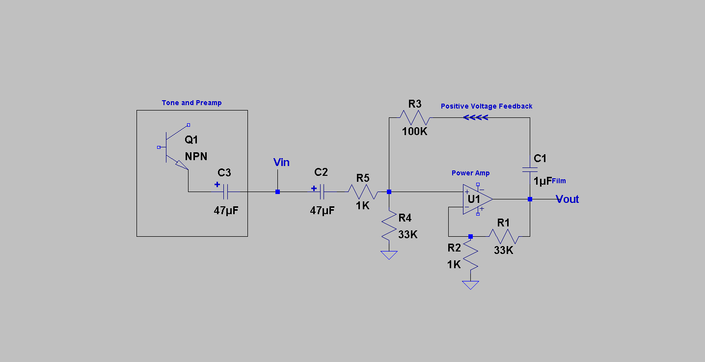

Hello Sk8Ter. I studied the schematic of hk 430, and came up with the attached proposed PVF scheme. Please note:
1. The 1 uF coupling cap from Vout to the 100 K PVF resistor. Without it, any DC offset at Vout is expected to be a problem. I recall that you had suggested in an earlier post using 56K instead of the [more cautious] 100K.
2. The base of the non-inverting bjt diff amp of power amp is an ideal point to inject PVF. Because the 1K input resistor has its other end terminating in the low output impedance of the preamp buffer; and/or like AC ground.
Tips: Start with the volume control at minimum, and select an FM station [mono rather than stereo] for later comparison at the loudspeakers.
1. The PVF connections are accessible on the amp board. Use the clips gizmo I showed in an earlier post to hookup. Connect the cap and the 100K resistor to a 3-terminal Euro connector, and then tuck'em safely in a plastic med bottle.
2. Hook up the PVF network before the amp is turned on. Otherwise one or more fuses will blow when done post turn on.
3. Push the loudspeaker switch on and measure DC offset without any load.
4. The load at the speaker terminals needs to be at this point 2 X-mas light bulbs connected in series; which have a net ~7 Ohm cold resistance. Both will blow if there's a malfunction or oscillation.
5. If all's well, connect 1 light bulb in series with a 4 -8 Ohm loudspeaker. Play some music at low level.
6. If all's well connect 2 light bulbs in parallel [1.5 Ohms cold], and connect the net light bulb fuse in series with the loudspeaker. Play some music at low volume.
7. Finally, connect the loudspeaker; preferably 8 Ohms to start.
8. Must repeat the above steps when the PVF resistor is lowered to a value less than 100 K. The risk of oscillation and blown fuses will rise quickly.
A comparative subjective assessment is now possible. The Balance knob turned fully clock/anti clockwise will be useful to compare the two channels with and without PVF. Listen for the relative level noise, and hum etc..
Hope all will go well.

Thanks I will give this a shot asap....some reservations...will the 1mf cap be enough? I mean will it limit low freq somehow??

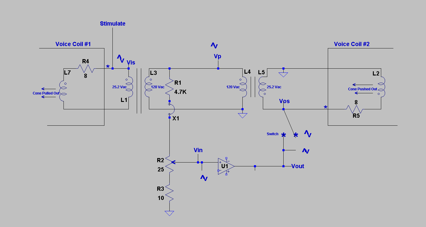

Applications of Positive Voltage Feedback
I have two applications for Positive Voltage Feedback [PVF]. I refer you to the thread in this forum entitled Class aP amplification for the first one. Its last 6 posts detail it. Please note that I had made a typo error in the base schematic which I corrected in the last post.
Here's background for the second application. It shares the same base schematic as the first one. It tackles the problem of standing waves [from bass energy] which Nelson S. Pass had already solved in US 4,899,387. I had a past thread in this forum entitled diy US 4,899,387 which successfully studied its application. However I had trouble [due to oscillation] with the system using a Dual Voice Coil [DVC] Subwoofer instead [or replace the function] of the electret microphone-woofer system of the patent.
The schematic of the DVC system under study is attached. Its objective is to attenuate bass energy at a corner in the listening room. Upfront, here is the conclusion of the study: Given music which is played by a regular amp and loudspeaker, rich in bass, and impulse bass, the same piece of music sounded different with and without the system engaged. The change was in the spectral balance of the perceived sound; due to less bass.
The system has an enclosed DVC subwoofer, one power amp, and two iron core power transformers connected as shown. The transformers can also be replaced with one power toroid with two primary and 2 secondary windings. The negative feedback loop around the power amp is inherently present; but not shown. The power amp has s a PVF loop around it via the power transformers. This system is still prone to oscillation; but docile to some extent.
In the next post I'll explain its works and adjusting it.
Here's how the system described in the attached schematic works. Each voice coil is shown as an 8 Ohm resistor in series with a certain inductance. Let's begin with voice coil #1 at the left part of the schematic:
1. An arbitrary vacuum is presented to the surface of the cone. It pulls it a certain distance forward or out of the enclosure towards the observer..
2. The voice coils are attached to the cone. The motion of the cone generates an output electrical signal [Vis] which is depicted as the rising part of a sine wave. It is acting like a microphone.
3. The voltage [Vis] is stepped up in the left transformer to get Vp. Vp is next attenuated via the resistor ladder for presentation to the non-inverting input of the power amp which has a voltage gain = 27.
3. The power amp's output voltage [Vout] is in phase with the output signal Vos at the 25.2 Vac winding of the right transformer which is loaded by voice coil #2.
4. As an example, Vout of the power amp was made equal to Vis [in a prior tweaking step] by adjusting the level control pot [25 Ohm] at its input.
5. Close the switch at Vout. The rising signal at Vout across voice coil #2 pushes the cone forward or out of the enclosure. This "push" generates a rise in pressure at the cone's surface which nulls or attenuates the vacuum which had been imposed on it. The cone does the second duty of a normal woofer
6. The cone must continue to move in the same direction as that originally imposed on it by the vacuum. It must not sit still; as it'll behave like a wall surface.
7. All of the depicted sine signals in the schematic are in phase. A positive voltage feedback [PVF] loop around the power amp is explicit.
8. One can also use an arbitrary rise in pressure at the cone surface instead of a vacuum. The cone is asked to move towards the inside of the enclosure. This disturbance is simultaneously augmented by the power amp which actively pulls in the cone via voice coil #2; keeping it moving in the same direction effected by the stimulus. A consequent vacuum thus emerges at the cone's surface to null or attenuate the offending original pressure stimulus.
I'll show the steps to tweak this system in the next post.

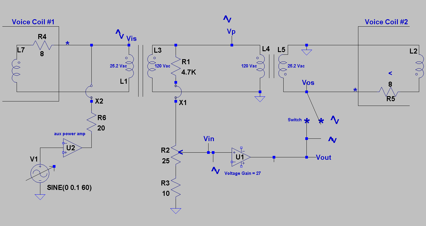

The attached schematic was used to adjust/tune the system shown in post #91. The bottom left view shows a sine signal generator with an adjustable output level feeding an auxiliary power amp. This amp's power output was sent to Voice Coil #1 via a 20 Ohm power resistor. It energized coil#1 so as to simulate exposure to a signal from a standing wave [sw]. Here's the process:
1. Minimize the 25 Ohm pot at the input of power amp with positive voltage feedback [call it A; Vg =27].
2. Open switch at the output of power amp A.
3. Send a power output signal [60 Hz] to Voice coil #1. Its level was measured with an AC multimeter; say equal to 30 mV. The subwoofer hummed.
4. Dial up the 25 Ohm pot such that Vout of power amp A is ~30 mV.
5. Close switch at at Vout of power amp A so as to connect it to Voice Coil #2.
6. Measure the voltage drop across VC1, and fine tune its level to a minimum of 30 mV. This is bootstrap condition. The loudness of the audible hum did not change much.
7. An SPL meter registered ~1/2 dB drop when VC2 was energized; at a distance of ~1 foot from the cone of the woofer.
8. VC2 had a lower voltage drop across it relative to 30 mV. It was adjusted up to that value with the 25 Ohm pot.
9. The adjustment made in point 8 also increased the voltage drop across VC1.
10. In general, the initial stimulus voltage drop across VC1 of 30 mV was readily increased to 60 -75 mV by dialing up further the 25 Ohm pot. There's clearly positive voltage feedback around power amp A
11. System stayed stable. But a nuisance 60 Hz signal grew in amplitude to 20 mVp-p [on scope] without a stimulus signal to VC1.
12. Any further increase of voltage drop across VC1, showed signs of a low frequency oscillation. It seemed to me that the oscillator piggy-backed on the stimulus signal by reproducing it.
NB:
1. Still a difficult system to work with. It is not as effective in suppressing standing waves like that patented by Mr. Pass. He recorded a minimum 6 dB decrease in SPL. I recorded this same behavior of this DVC sub system [drop ~1/2 dB] in the older thread of this subject entitled: diy US 4,899,387.
2. A cut of music rich with low bass sounds different with and without the system engaged.
I have one more schematic to show with a bit of analysis.

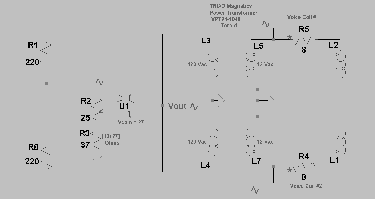

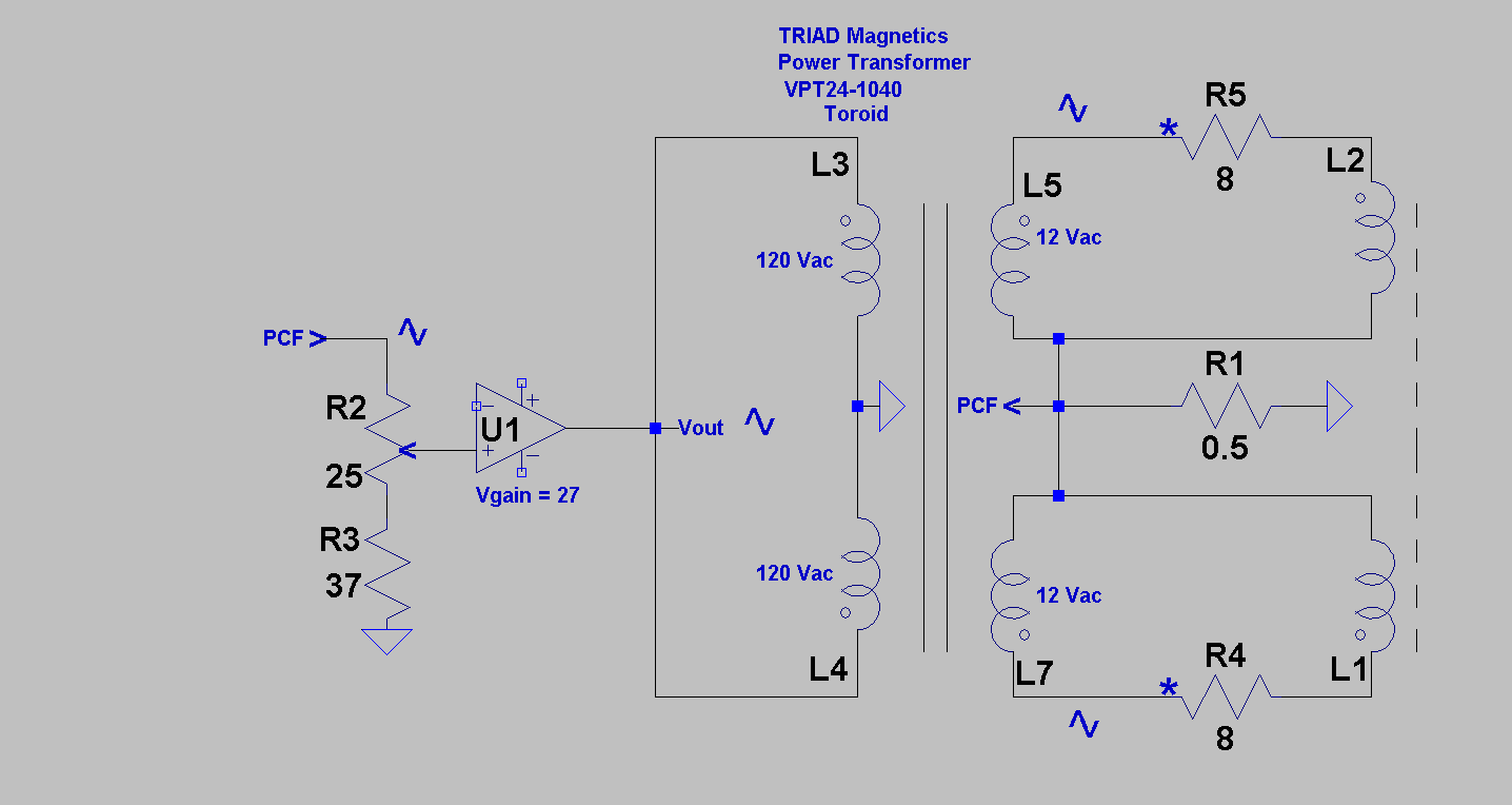

Hello lhquam. I've been experimenting with the symmetrical system of the left schematic. It interferes with sound in the room corner. It may fit #2; but I'm unsure, so I'd call its feedback voltage instead of current.
The right schematic [not tested; just written] is most probably #1 or using current feedback.
Note the transformer is now a single power toroid; instead of 2 shown in a past post. This symmetric approach does not distinguish one voice coil as a mic, and the other as a driver.
I will show the detailed schematic of the left system which includes tuning etc..

Where are the inputs?
In the left circuit the feedback is the voltage(s) sensed across the load, thus making it (positive) voltage feedback.
The right circuit shows (positive) current feedback.
In post #97 the 2nd use of the term "current feedback" I was referring to was voltage feedback into a low impedance node of some form of difference amplifier, such as the source node of the F5 JFET stage. Texas Instruments has an Application Report about this type of "current feedback": http://www.ti.com/litv/pdf/sloa066.
Thanks lhquam for the ti link, and your clarification.
Where are the inputs. Each voice coil is a dynamic microphone [input], and an output driver. Here's how it works for the attached circuit with PVF during music play from an independent stereo loudspeakers inundating the room with sound waves.
1. Let the cone of the DVC subwoofer be pulled out of its enclosure from a sound wave with a vacuum characteristic.
2. The resultant rising positive output signal from each voice coil [depicted], is sent to the power amp via the 220 Ohm resistors.
3. The two signals are summed at the top of the 25 Ohm pot which feeds the non-inverting port of the power amp.
4. The output [Vout] of the power amp is stepped down; such that it generates in each voice coil an in-phase power signal of equal amplitude to the parent which induced it in the first place.
5. Here is the net value: The power amp enables the cone to become "more compliant" relative to a state of its non-involvement. Thus, it easily pushes the cone out to generate a positive pressure [by convention]. This positive pressure adds acoustically to the vacuum from the parent stimulus and diminishes it in real time.
