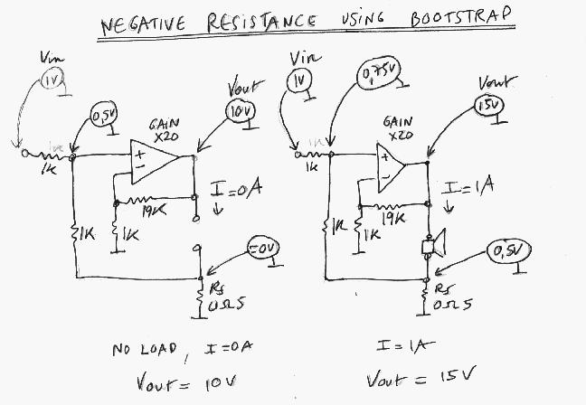

Current positive feedback can be easily implemented :
http://www.diyaudio.com/forums/mult...ear-their-resonant-frequency.html#post1786574
Without current in shunt Rs, the amp input voltage is divided by almost 2.
When there is some voltage across Rs, the amp input voltage is increased by the bootstrap action (positive feedback).
So the whole circuit has more voltage gain at the frequencies where the driver has low impedance and less voltage gain around its resonance.
The apparent Q of the driver is lowered.
Beware that the inductive component of the voice coil resonates with the capacitive component of the motional impedance.
It's all engineering, nothing magical.
And simulators can easily model it.

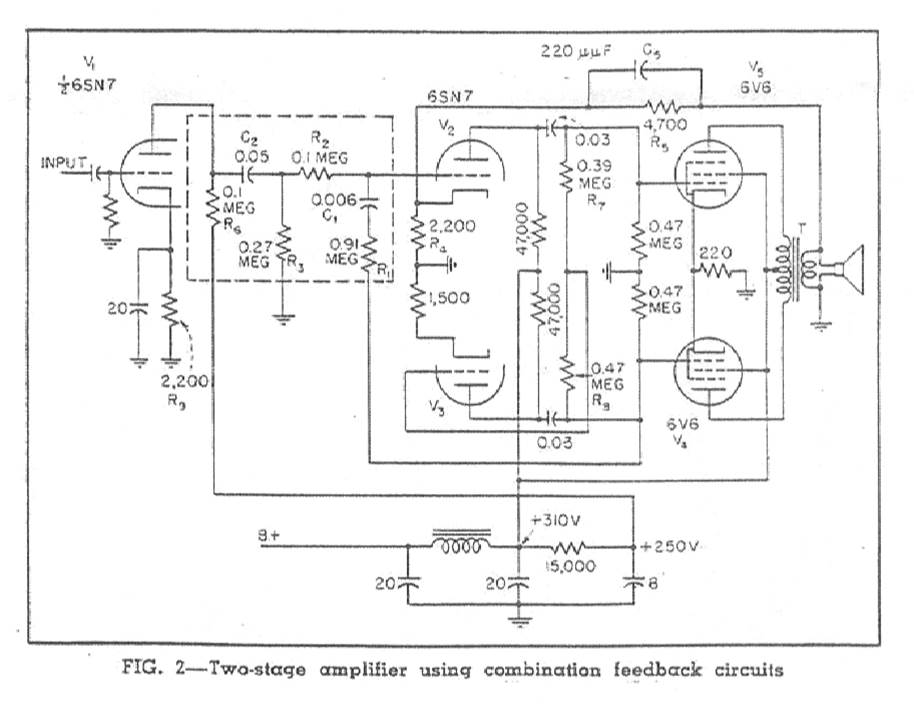

Fully agree Nelson. Cordells error correction (Hawksford kind) as well as my own experiments in the paX amp are based on positive feedback. Not familiar with those others you mention but I have an idea how that would work.
Actually I took out a Dutch patent on an error correction scheme, many years ago, which made me very proud, until someone at an AES convention pointed out to me that it was based on a combination of PFB and NFB first described by a guy named Welwyn about 1920 or thereabouts...
You live and learn.

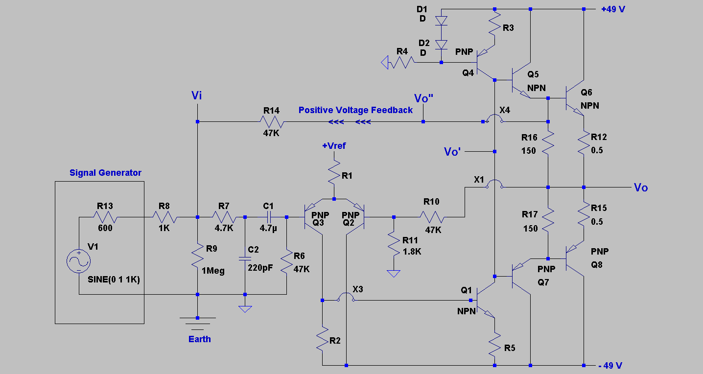

Hello forr. Thanks for the schematics. I will use them to experiment with Positive Current Feedback [PCFB] as part of this thread. And maybe later on use NFB, PVFB and PCFB simultaneously in the amp.
The attached schematic details the following changes:
1. The output stage of the power amp is made up of independent bjts which assemble 2 complementary Darlingtons. Positive Voltage Feedback [Vo''] is shown to emanate from the emitter of the first NPN bjt in Darlington. It can also start at the emitter of its complement.
2. Vo'' can also be the power output Vo. I chose the indicated Vo'' so as to distance it from the loudspeaker interface which is solely dedicated to NFB.
3. Note the value of the Positive Voltage Feedback [PVFB] resistor is 47 K which is the same value as that for NFB.
4.The 47 K PVFB resistor must be terminated to common with an equivalent resistance of less than 1.8 K which is the value of the resistor at the inverting port of the diff amp.
5. As I slowly and carefully increased the value of the 1K resistor, the scope at Vo showed the birth of the imminent and possible oscillating signal [50-60 Hz].
6. I purposely exceeded 1.8 K equivalent resistance at the non inverting port. The power amp was stable without load, and loaded with an 8 Ohm power resistor. The amp's special fuses immediately blew when I attempted to connect the loudspeaker which shrieked, and scared my %&#*.
In the previous schematics, PVFB started at Vo' which is a high impedance port and terminated in a summing junction. It may be called Schade PVFB akin to Schade NFB.
I'll show in the next post the scheme I am using to safeguard the system from damage due to oscillation.

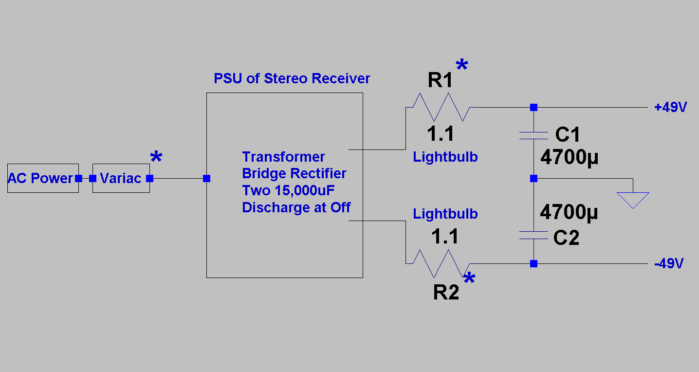

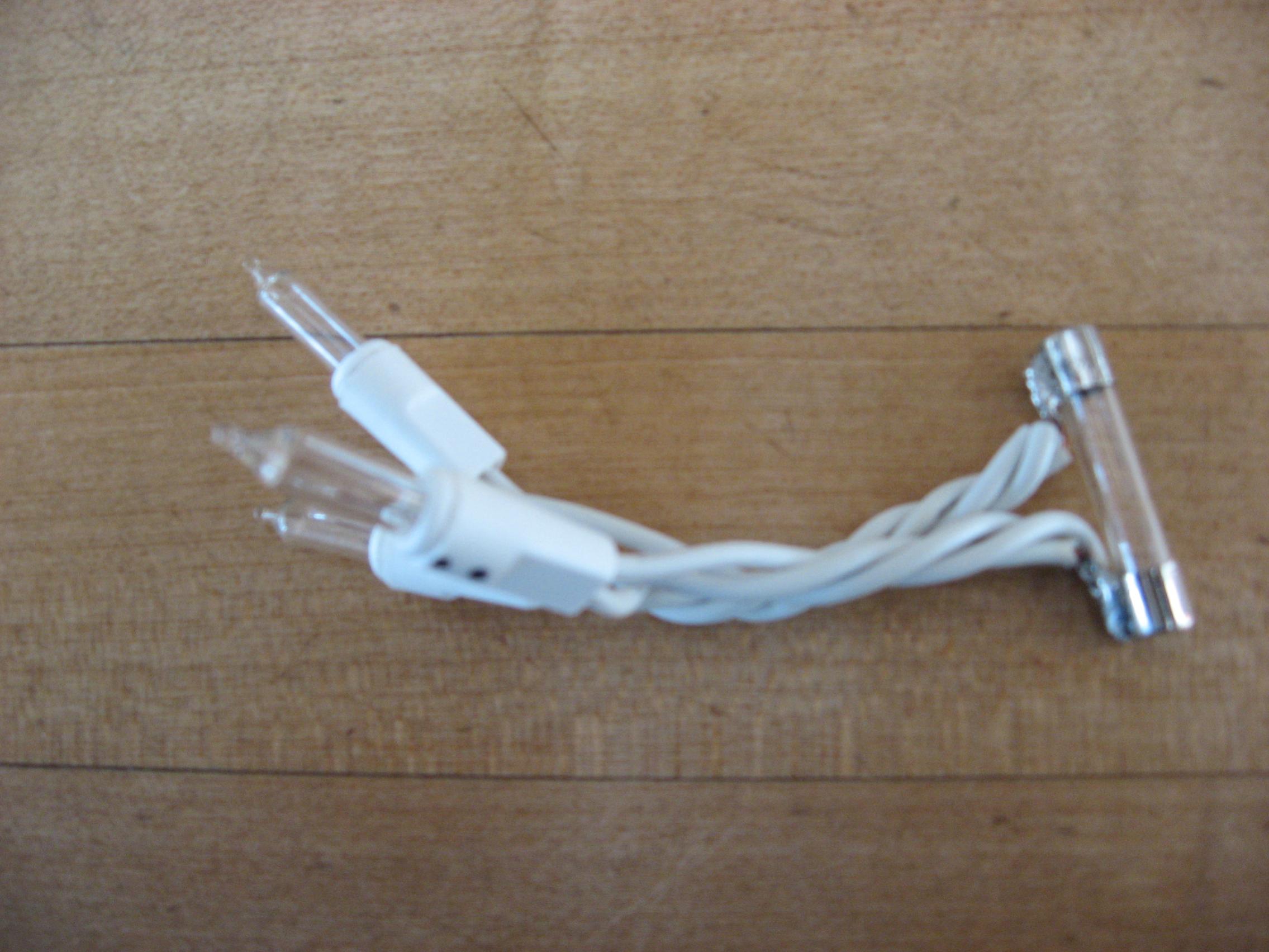

Thanks forr for your advice. I have been using the approach in the attached schematic to safeguard the system. It was adequate, and predicted oscillation; provided the changes in the resistor values in the PVFB circuit were small, and Vout was monitored on the scope for the birth of oscillation.
1. The essential components are the variac, and the light bulb fuse which I show in the adjacent photo.
2. The light bulb fuse uses 1-3 X-mas light bulbs which are soldered across a blown regular fuse. Each light bulb can handle up to 120 mA before it blows.
3. Under stable operating conditions, each light bulbs glowed faintly; handling the ~80 mA idle current per power rail.
4. On start up, and without a load at Vout, increase the voltage of the variac as one eyes the light bulbs. A problem will exist if the lights get brighter, stay bright, and/or blow. The problem must be resolved.
5. Idle the stable amp for a time. Connect an 8 Ohm load power resistor.
6. Disconnect the power resistor. Carefully and slowly connect the loudspeaker.
7. The system is safe if the extent of PVFB is a maximum of ~80-90% the value of NFB. This extent is basically the ratio of the equivalent resistance/impedance at the non-inverting input to 1.8 K at the inverting input of the diff amp.
8. Oscillation is assured and sudden at the ratio of PVFB/NFB=1 or higher. This blows the light bulbs, and is heard loud and clear from the loudspeaker.
