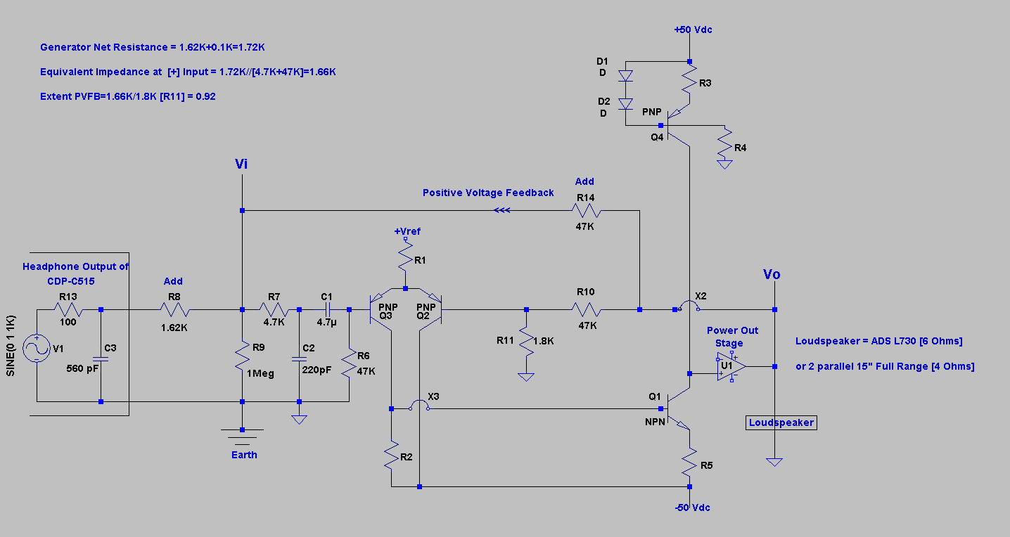

The attached schematic is the current state of the Class AB power amp infused with positive voltage feedback [PVFB]. Note the refinements:
1. PVFB and NFB emanate from the same universal power output Vo. Other power amps with topologies that are different from this amp are likely amenable to this treatment with successful results.
2. The extent of PVFB is 92% the value of NFB as calculated at the top left part of the schematic. The signals which are offered to the diff amp are mostly similar; and this invokes the maybe term of common mode, and its impact.
3. A 3-way loudspeaker, and a full range dipole loudspeaker sounded great and satisfying with this modified power amp.
4. The scope showed a 20 mVp-p 60Hz hum. The tweeter of the 3-way loudspeaker buzzed faintly. The origin of this noise is unknown, and/or signaling the onset of oscillation.

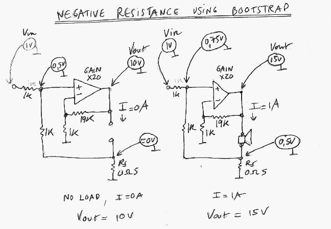

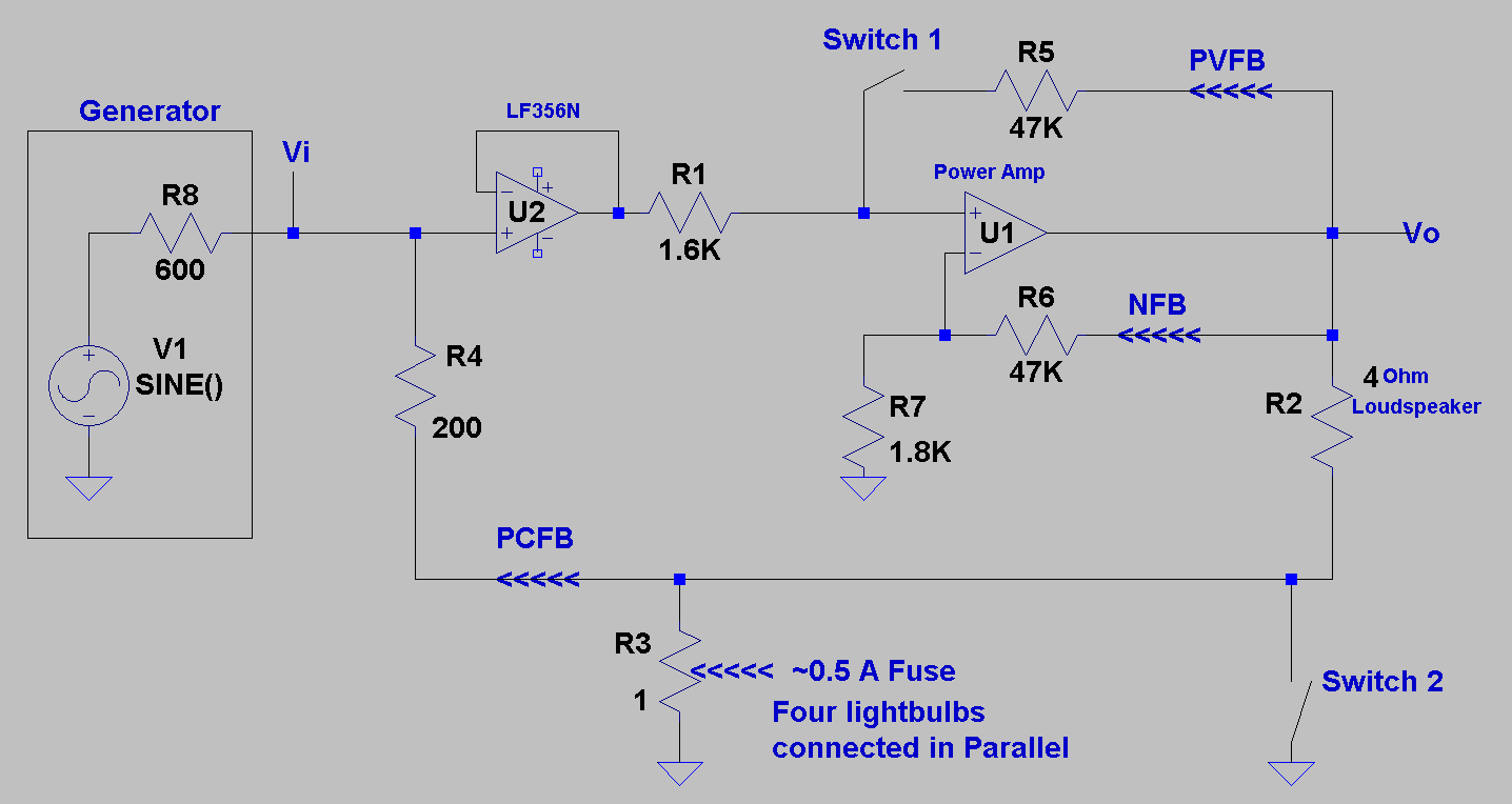

DIYer forr showed the left schematic in Post #42. It uses the standard NFB [for a closed loop voltage gain = 20], and an additional Positive Current Feedback [PCFB]. It worked with the power amp under test [Vgain = 27] as expected. A side effect of PCFB in my application was a decrease in the output voltage of the parent. This loss which is/maybe trivial can be readily restored by increasing Vi from the driving preamp, or by the application of additional Positive Voltage Feedback [PVFB] to the non-inverting port of this power amp like I described in previous posts.
The right schematic shows an approach for the application of PCFB. Please note the following:
1. The 1 Ohm resistor which senses the current flowing through the loudspeaker is a fuse made from four [Xmas] tiny light bulbs [LB] connected in parallel. I thought this special fuse will be more interesting to use than a plain resistor or a regular fuse. Because its 1 Ohm cold resistance will increase [due to heating] with current passing through it, and thus increases the extent of PCFB.
2. Closed Switch 2 across the LB fuse [no PCFB]. and generated a power output voltage of Vo [1 KHz] which I viewed on the scope and measured with a an AC multimeter.
3. Opened Switch 2 across the LB fuse [injected PCFB]. The parent power output voltage increased by ~0.6 dB.
4. Switch 2 allowed me to do a sequential A/B comparison when I used a CD music source instead of a signal generator. The two systems sounded different with a preference to that with PCFB.
5. With PCFB engaged [switch 2 off], I injected Positive Voltage Feedback [PVFB by closing Switch 1. The system was louder[expected from previous posts], sounded different from the other two, and was fully agreeable.
6. The 3 power amps described above were stable against oscillation.
7. The system with PCFB only was very quiet at idle using ADS L730 3-way loudspeaker. It became perceptibly noisier [expected from past posts] with the additional PVFB.

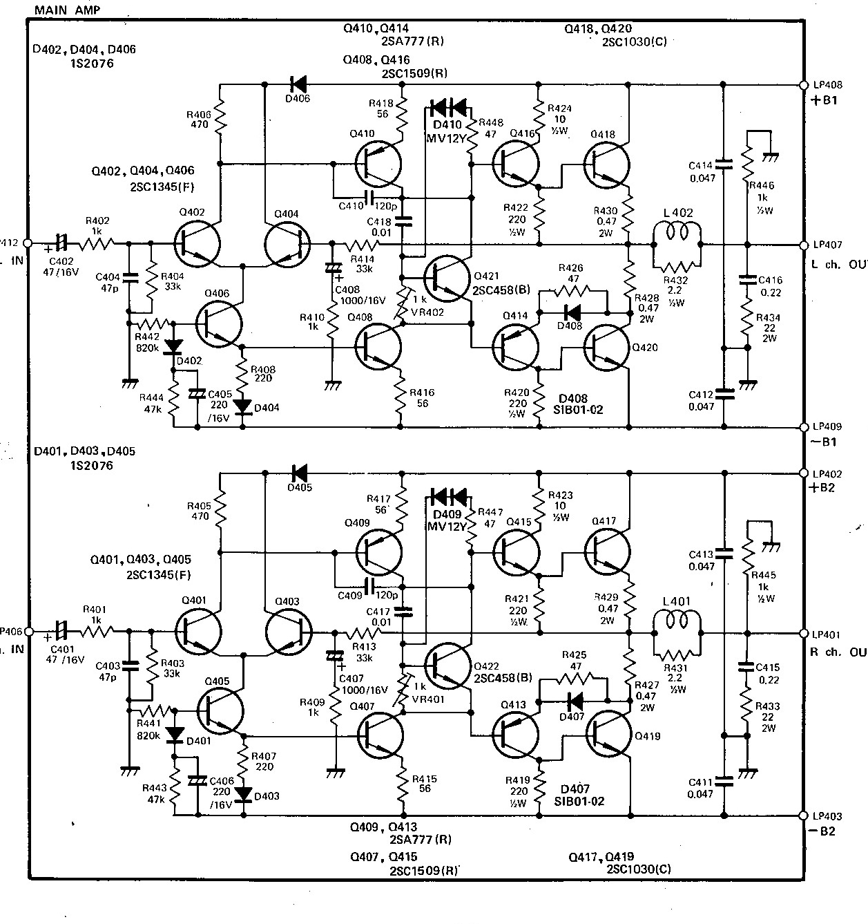

Hello Sk8Ter. The hk 430 is 1976 vintage. It delivers 25 wpc/8 Ohms. Interestingly, it has independent bipolar PSUs [maybe +/-30V] for L and R channels. Please follow this course of action [I use] to safeguard the amp's power output stage, and the loudspeaker during tweaking/experimentation.

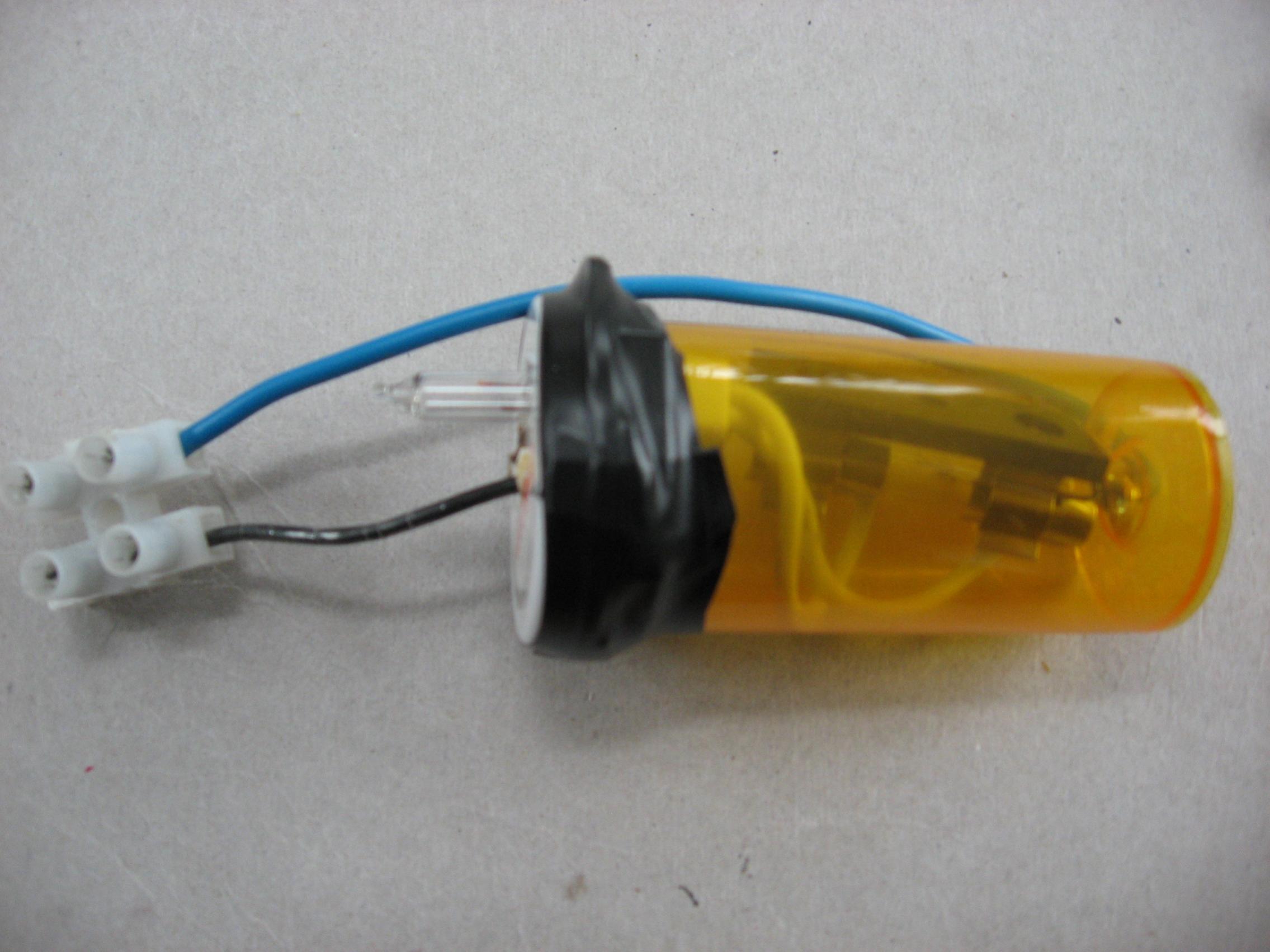

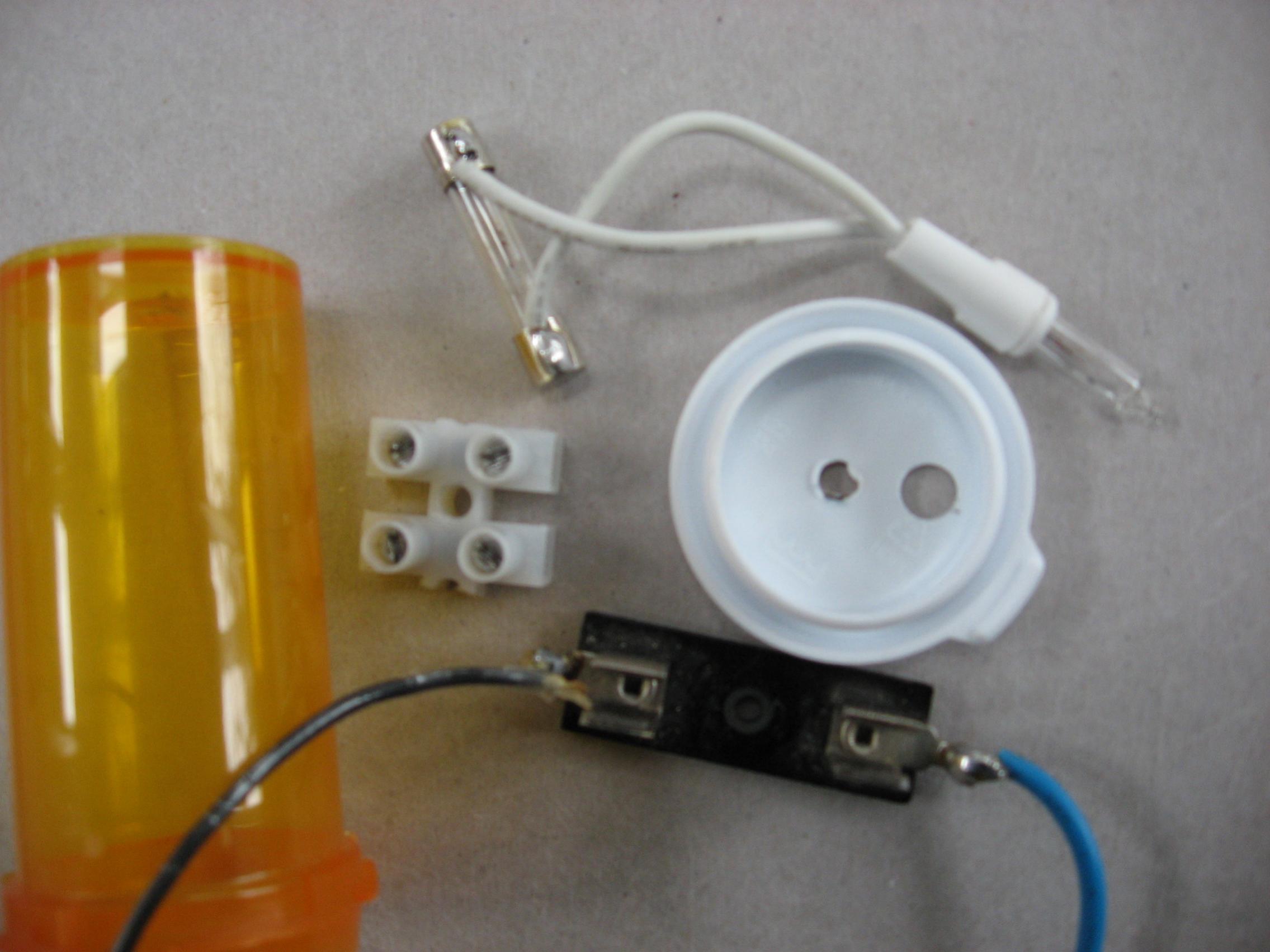

1. Need a variac.
2. Work with one channel only. The other is the comparative reference.
3. Construct 2 light bulb fuses. The attached photos shows one fuse which is disassembled and assembled for ready to use. Must see the light bulb and its brightness as a diagnostic, at idle and during tweaking.
4. Break the B+ power rail wire originating at the rectifier board and insert the fuse in line. Ditto for the B- power rail.
5. The amp's power output to the loudspeaker has a 3A standard fuse. Remove it and replace it with a 0.25A fuse.
6. The power output has an on/off switch to engage the loudspeakers. Keep it off.
7. No load is to be connected yet.
Powering up.
1. Plug the 2 conductor AC power cord of hk in variac.
2. Most probably, the phono circuits have an external connector labelled "phono ground". Ground/earth it.
3. Turn power switch on to hk
4. Slowly increase the variac voltage while noting the status of the light bulbs.
5. The idle current per power rail is quoted at 50 mA. Both light bulbs will slowly brighten, and level at a variac setting of 115Vac. Has idle changed after 40 years?
6. Each bulb will blow at ~120-150 mA in the event of a pre-existing malfunction or a rich bias.
7. Idle the channel under test for a time; periodically noting the light bulbs.
Turn off. Do either of the two options:
1. Turn off switch at variac set at 115 Vac; granted it has one.
2. Slowly decrease the variac voltage to zero Vac, and switch it off.
Repeat the above protocol many times to gain confidence it is reproducible before we move to the next step.

Lightbulbs used as sense resistor - won't this encourage runaway feedback? I'm not so sure that would be "interesting". Depends on your definition of that, and love of the magic smoke.
