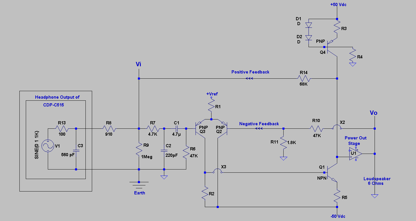

The following is a simplified schematic of a Class AB power amp using positive feedback [PF]. It is in addition to its standard overall negative feedback [ONF]. Here is its description starting from Vi and moving right to Vo:
1. The input stage is a common diff amp. It drives the second last voltage amp [LVA] which is an NPN loaded with a PNP constant current source.
2. LVA has a high voltage gain, and a high output impedance. Its output is Vo'.
3. Vo' is buffered by a pair of complementary Darlingtons. Each idles at 80 mA. Their output is Vo, and drives a 3-way loudspeaker [ADS L730]. .
4. ONF is returned to the BJT's base of the diff amp which is the inverting input. ONF gives an amplifier voltage gain of 27.
5. PF emanates at Vo' and is channeled via a 68K resistor; terminating at Vi which is the non-inverting input of the diff amp.
6. The non-inverting input circuit of the diff amp is detailed; because it is an integral part of the extent of PF that is used.
The music source is the headphone output of a SONY CDP-C515.
1. Its schematic shows it is a voltage source [Op Amp] with a 100 Ohm series resistor.
2. Another 910 Ohm resistor was added [externally] in series with the headphone output. It protects the headphone amp.
3. The net series resistance of 1000 Ohms [to the left of Vi] with the 68 K PF resistor establish a certain value for the extent of positive feedback.
This amp is very quiet at idle, and does not oscillate. This system's music sounds great from top to bottom. The bass is awesome..really.

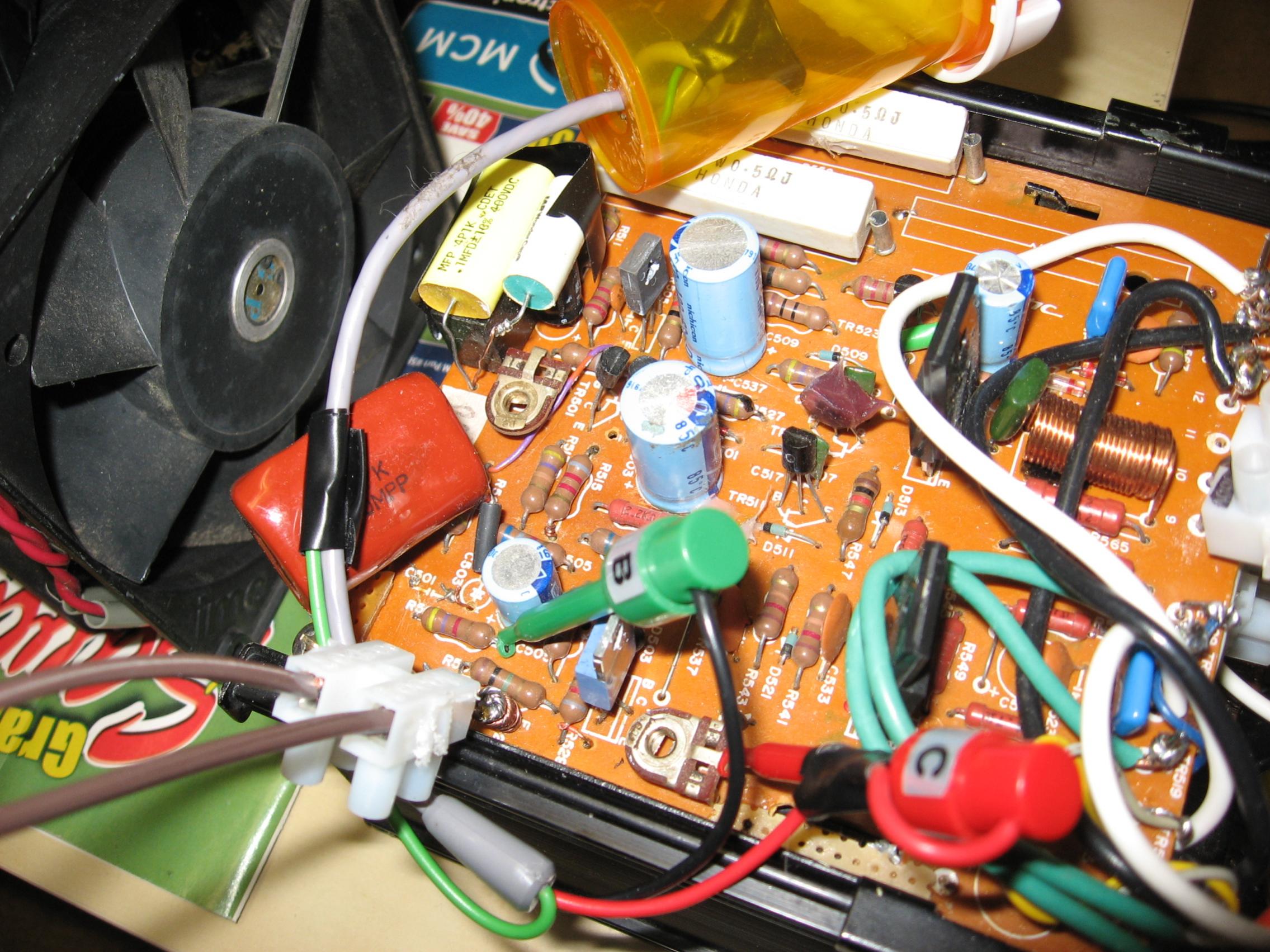

A photo of the amp's board side shows the locations which connect [via clips] the external 68K PF resistor which is housed in a pill container.

Is it positive feedback, or could it be described as feed forward?
What performance characteristics are changed when you add in that 68k?
Why are you in Pass Labs?
Ans 1. The loop from Vo' to Vi in the schematic of Post #1 is most probably positive feedback, and not feedforward compensation [FFC]. FFC is explained in many articles on the internet. Its circuits are different, and have unrelated objectives.
Ans 2. The closed loop gain of the parent and the modified amp stays at 27. Vi increases after closing the Vo'-Vi loop to ~double its parent value.
Ans 3. I am familiar with DIYers in the Pass Labs Forum from interactions in past and present threads. The DIYers have shown recent interest in positive feedback after the successful introduction of F7 and it many schematic clones by DIYer lhquam. This thread can instead be in Solid State or in Everything Else Forums; provided its presence in the Pass Labs Forums fails preset criteria for its inclusion. I'll leave this issue to the Moderators.

The amp oscillated when the 1 K input resistor floated; because Vi quickly became equal to ~1/2 Vo'; which was excessive feedback.
The pos feedback factor depends on the source impedance - it is just the ratio of the 68k to the source impedance. As long as you have a low source impedance, the pos feedback factor (from the 68k) is low, the neg feedback factor dominates and the amp is stable.
With the source impedance becoming larger the pos feedback factor increases and when it approaches the neg feedback factor, instability starts to set in.
It is an interesting approach but you should put in an input buffer so you can set the pos feedback factor independently of the source impedance, and make sure it is always lower than the neg feedback factor.
