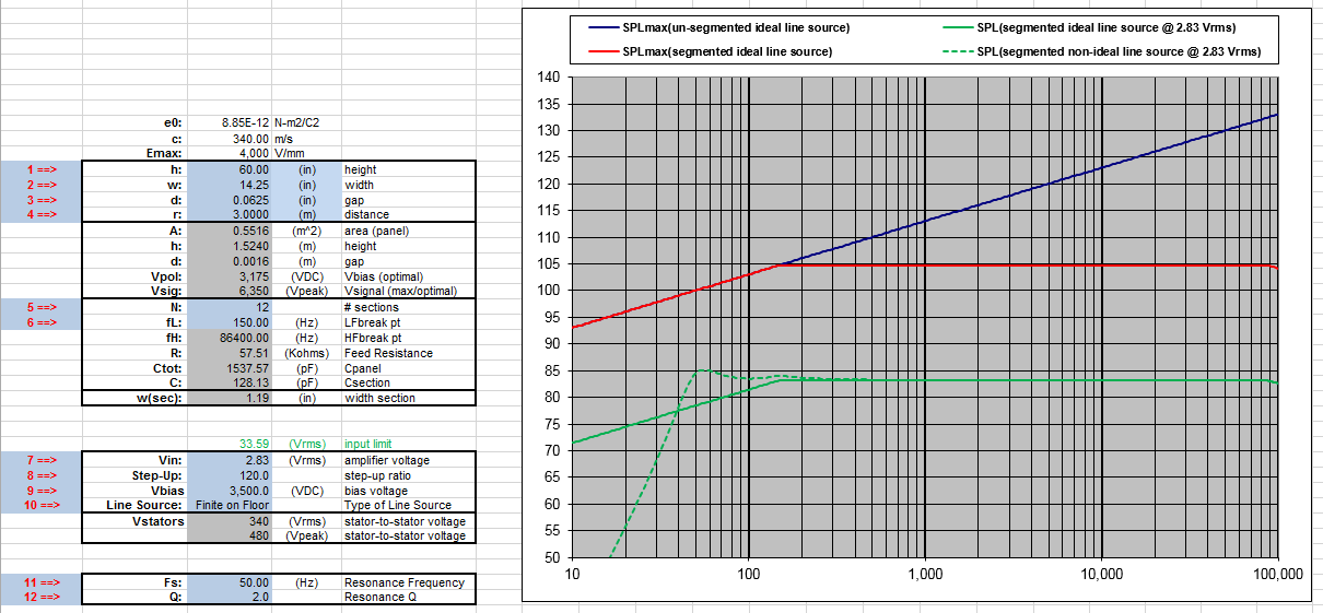

Here is Version 3 of the spreadsheet.
The following functionality was added based on feedback from users:
1) Added ability to choose units for the dimensions
2) Added inputs for transformer step-up ratio, input voltage, and bias voltage
- among other things this will allow you to easily determine sensitivity @ 2.83Vrms.
3) Added selection for line source type(ideal, finite, finite on floor)
4) Added ability to model diaphragm resonance effect on response

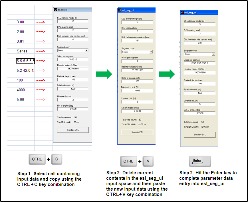

5) Added calculations for parameters to model response with calculator esl_seg_ui
- see attachment below for description of how to copy and paste segment parameters
As with previous version, each TAB is protected so you don't accidently mess up one of the formulas. There isn't a password though, so you can easily unprotect each TAB and change or rearrange things as you see fit.

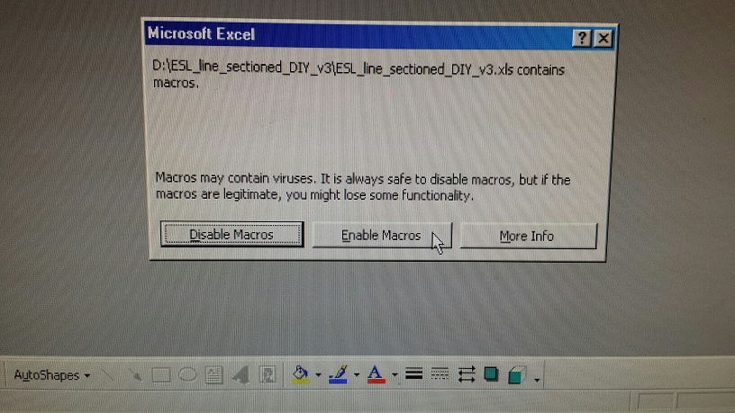

Oh, I almost forgot, this version uses a short macro code to populate the esl_seg_ui parameters. So when you open the spreadsheet, be sure to enable Macro content when prompted.
Niceeeeeee. an update! i dont get thbe 5 5 5 5 5 you wont get an error anymore when leaving the resistor values blank ?
EDIT aha i see its a excel sheet. thought it was the esl gui 🙂 but great work anyhow! i always have problems having excel sheets to work proper somehow. remember the stacked sheet you gave me ? i could open it but it never calculated new values or plotted 🙁 might be my excel is to old ? oh i got excel 2003 ...... that might be a problem i guess haha
I have Excel 2000 installed on one of my old test computers. I checked and both spreadsheets work fine, so should work with your Excel 2003. Remember the stacked sheet (ie multi-diaphragm) calculator requires the use of higher math functions so you need to have the Analysis Toolpak Add-In installed and active. If you are unsure about it, a quick web search for "excel 2003 analysis toolpak" will find you plenty of details on how to install and select/activate. The spreadsheet posted here does not require the Analsysis Toolpack. When you open it you should get a prompt to enable the macro. Once you click "Enable Macros", you should see the parameter input section and plot.

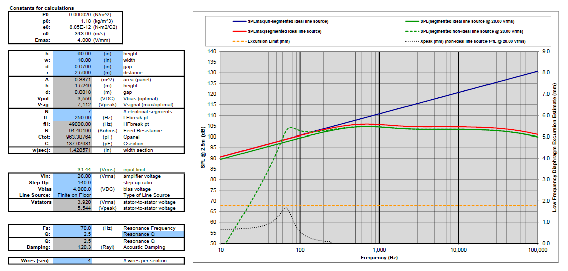

Here is Version 4 of the spreadsheet.
  • Parameter values now auto convert when you switch units.
  • Damping section has been expanded to allow specifying either resonance Q or acoustic resistance of damping mesh.
    Whichever parameter you specify, the other is calculated and displayed.
  • An estimate of peak diaphragm excursion is plotted for frequencies below fL where the entire diaphragm area is uniformly driven.
  • Response curves are now continuous rather than straight line approximations connecting the break points.
    Many thanks to golfnut for his math wizardry in deriving and simplifying the equations.
  • Added input to specify number of wires per section to use for the esl_seg_ui import data.
As with previous versions, each TAB is protected so you don't accidently mess up one of the formulas. There isn't a password though, so you can easily unprotect each TAB and change or rearrange things as you see fit. Changing any blue input cell, will re-protect the main input TAB.
Let me know if you have any questions or if something doesn’t seem to be working properly.

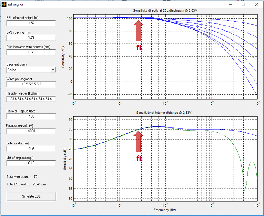

I need a sanity check on my interpretation of the LF break point and it's correlation to the crossover frequency in a hybrid application:
Is it correct to say that the LF break point is effectively the upper frequency limit of the last segment in the transmission line (i.e... the last wire group(s) in the series)?
If so; the crossover frequency should be lower than the LF break point; else the crossover would chop off the signal above the upper limit of the latter wire group(s) in the series.
Did I get that right?
Lastly; can you recommend some general guidance as to where the crossover frequency needs to be in relation to the LF break point (or visa versa)?

Unfortunately you will find "Numbers" does not handle the VBA code properly.
You should be able to use Version 2 of the spreadsheet just fine though as it has no VBA code.

…the crossover frequency should be lower than the LF break point; else the crossover would chop off the signal above the upper limit of the latter wire group(s) in the series. Did I get that right? …can you recommend some general guidance as to where the crossover frequency needs to be in relation to the LF break point (or visa versa)?
Sounds like you got it right. Basically fL is the frequency at which all segments or groups of wires have achieved their maximum SPL contribution. The last segment is the last to have its output rolled in, but the final octave shows all segments reaching there maximum output pretty much together. The upper plot in the esl_seg_ui window shows the magnitude of the voltages applied to each of the individual segments by the ladder resistor network. You can see that at fL, all segments are receiving full voltage, and the response has started to follow the -3dB slope of a dipole line source ESL. So, if you set fL lower than fX(crossover frequency) you will just be throwing away sensitivity.
General guidance is to set fL = fX, or at most fL = fX * 1.15.
If your diaphragm resonance is undamped and within 1.5 octaves of fX, you will see some response lift at fX from the resonance. So, you could move fL up in frequency by as much as a factor of 1.5 and gain 1 - 2dB of efficiency while retaining the response level at fX. Of course with resonance so close to fX you would need to use a notch filter in combination with the crossover to avoid over driving the diaphragm at resonance. I seem to recall you already having experience with this.
Found what I was thinking of: Thinking about a segmented wire stator ESL - Post#186 & #187
