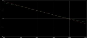

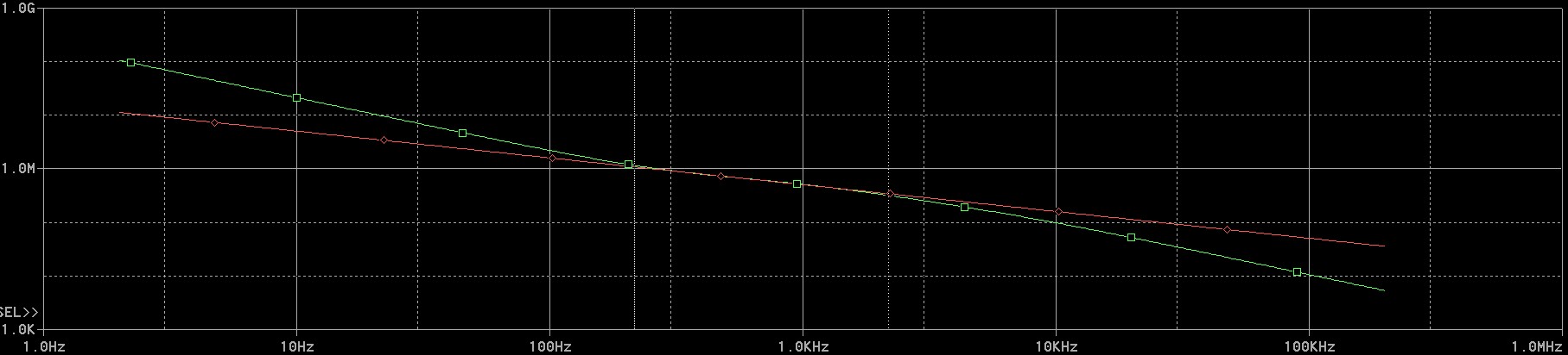

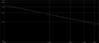

Kenneth,

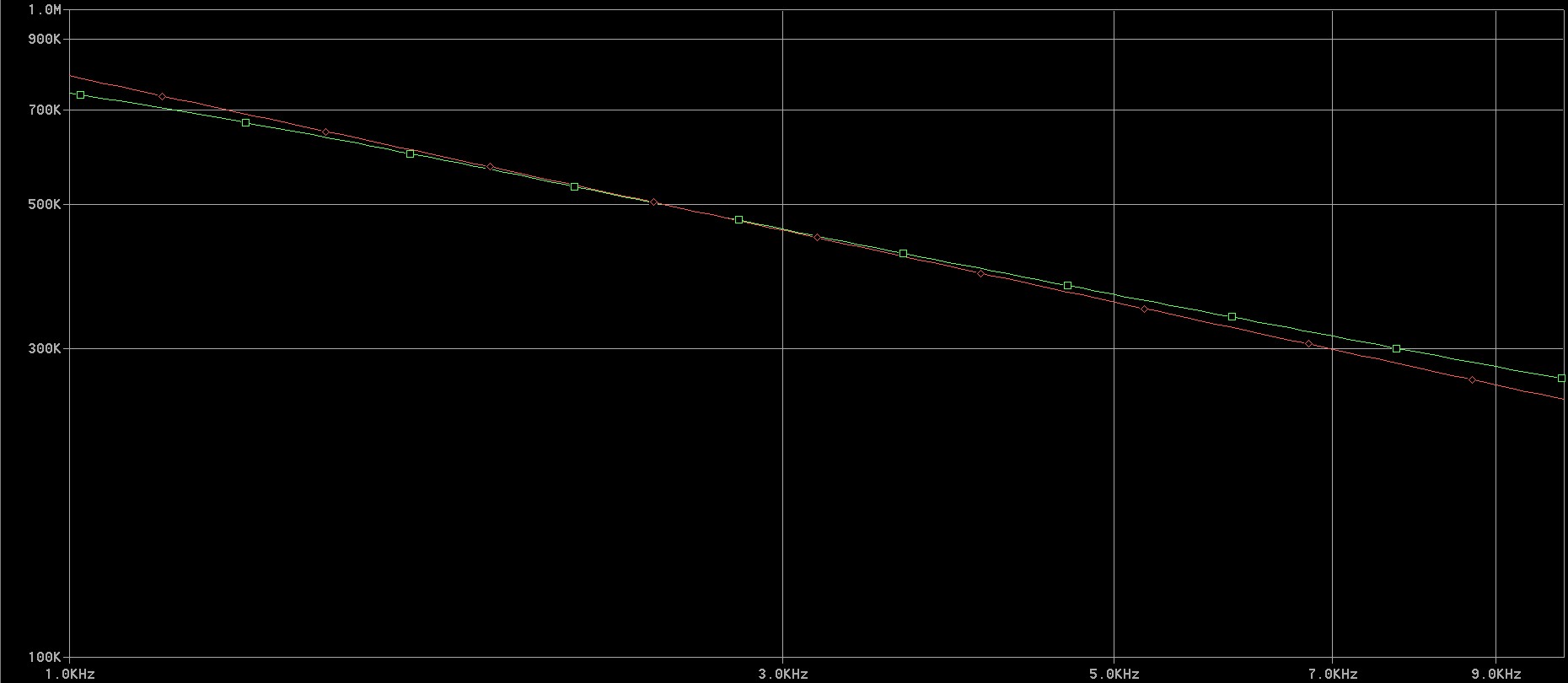

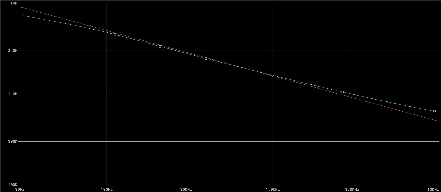

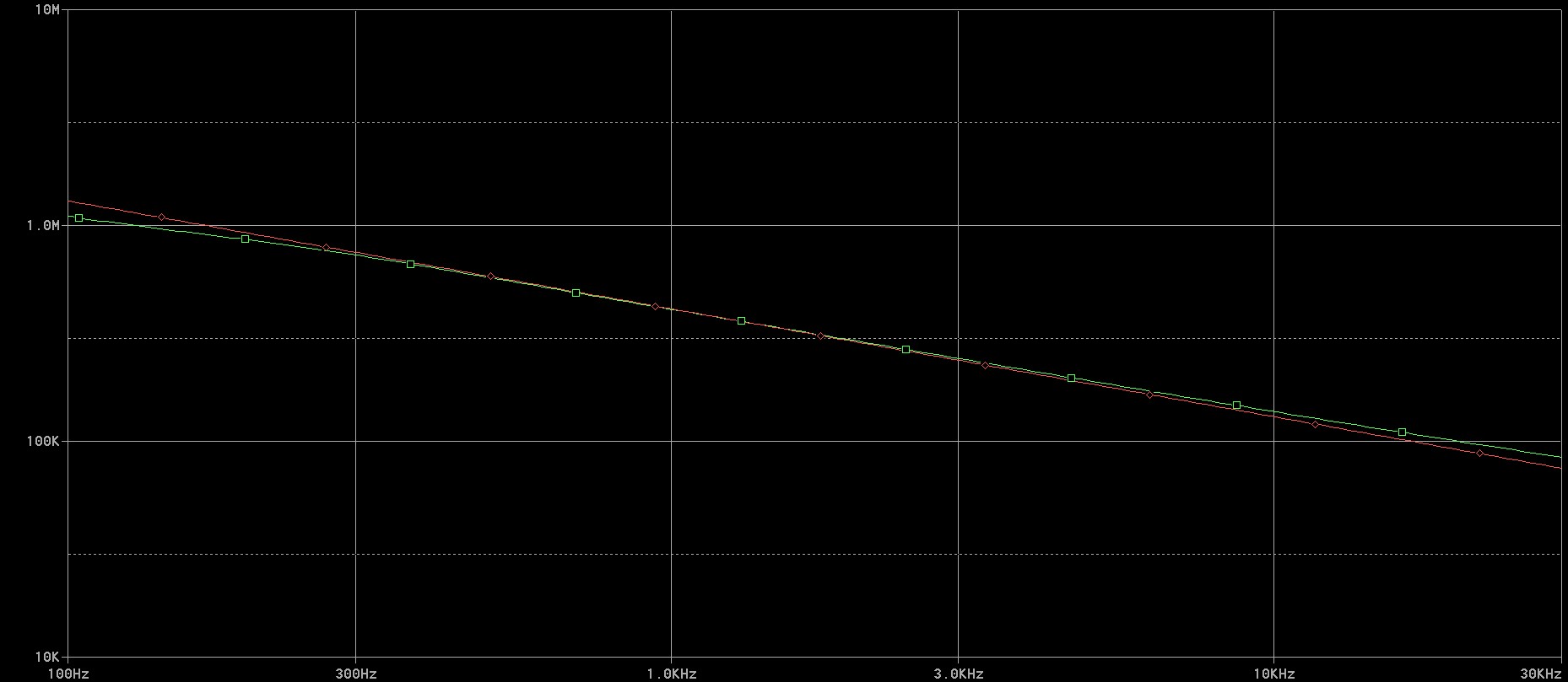

if it's all impedance wise 20 sections per panel half is relatively good.
Below are calculated plots magnitude of impedance vs frequency @ 20,40,80 sections.
It really unfortunate that the resistance per cell has to be quite high at low ladder length.
Alex

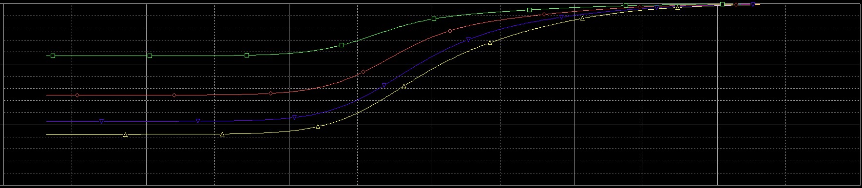

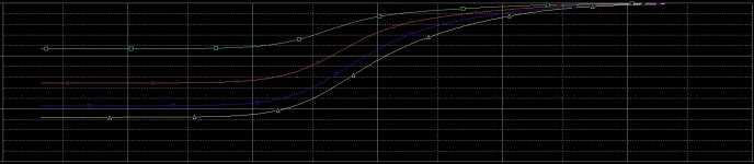

3. Time dealy of the line does not depends on frequency. Or is it?
Let's assume we applied step to the input (central strip). This step will appear on each tap (more or less distorted) with the dealy depending on propagation speed of a given line.
I have to read the original - that's my verdict.
Thanks,
Alex

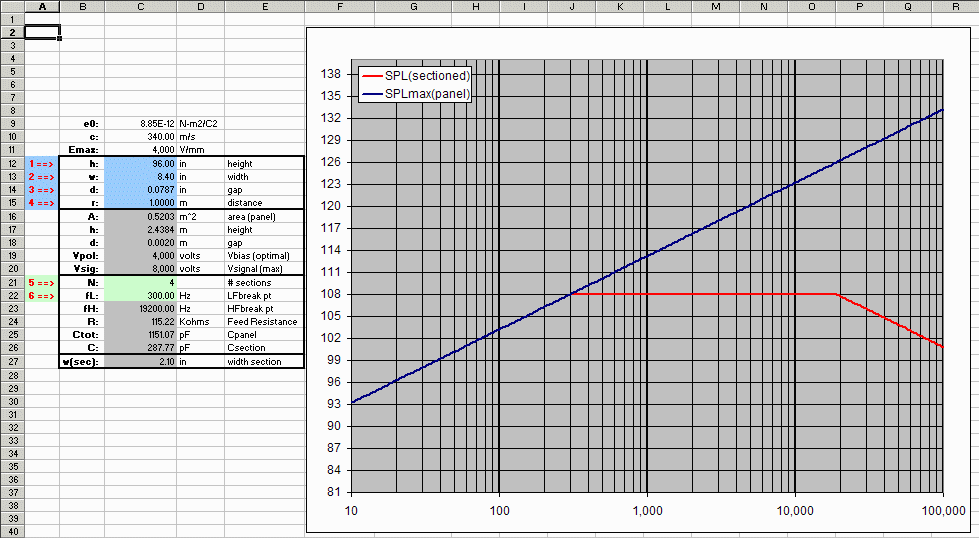

I find that a hybrid ESL running the ES portion from 300 Hz to 20 KHz only needs 4 sections for a flat response through the pass band. If the sections are to be kept no wider than 12 mm...I end up with unrealistically narrow panels (4 x 12 mm = 48 mm). Is this just meant to imply that while four sections are the minimum needed for flat response from 300 to 20000 Hz, many more sections are needed if you want to span that range with zero-free polar response and reasonable sound levels? Or am I simply missing something?
I think kavermei already addressed this question, but I thought I'd add a few comments. Yes, 4 sections is all that is needed to achieve flat on-axis response from 300hz - 20kHz. But, like you said, if you want to use a minimum section width of 1/2" and only 4 sections, you won't have much panel area, so your ESL won't be very loud.
When designing a panel, I'd suggest starting out by:
1) defining the largest panel(height & width) you can live with. This will give you the highest sensitivity and maxSPL.
2) Then, pick your LF breakpoint. With area already defined in 1), this also sets the max SPL for your design.
3) Figure how many sections you need to reach beyond 20kHz.
4) If your sections are already 1/2" or whatever you deem "small enough" then you are done. Otherwise, increase the number of sections until you get there. Your high frequency extension will be much higher then needed, but the leakage inductance of your transformer will most likely cut of the HF response at not much higher than 20kHz.
Another option is to only use the "small enough" section width on the first few sections of the transmission line and then increase the size of the section after that. If you look at the frequencies fed to each section you can see that as you travel down the line you pretty quickly lose the highs that would cause beaming problems. You just need to adjust the size of the transmission line resistors when you reach these sections.
I had thrown together an XL spreadsheet a few months back to allow fiddling with panel size, LF breakpoint, and number of sections to see how they affected efficiency and max SPL. It also calculated sections sizes, capacitance, and feed resistor sizes. Unfortunately looks I left it at work. I do have a screenshot I'd saved at one time shown here so you can get an idea what I am talking about.
Inputs 1 thru 4 define panel size and listening distance. This defines the max obtainable SPL for the line source seen in blue on the plot. Note the 3dB/octave slope as defined by the line-source version of the Walker Equation.
Inputs 5 & 6 define the LF breakpoint and number of sections. The resulting response is shown in red on the plot.
I'll be back to work on Tuesday, and should be able to post the spreadsheet for you to experiment with then.
