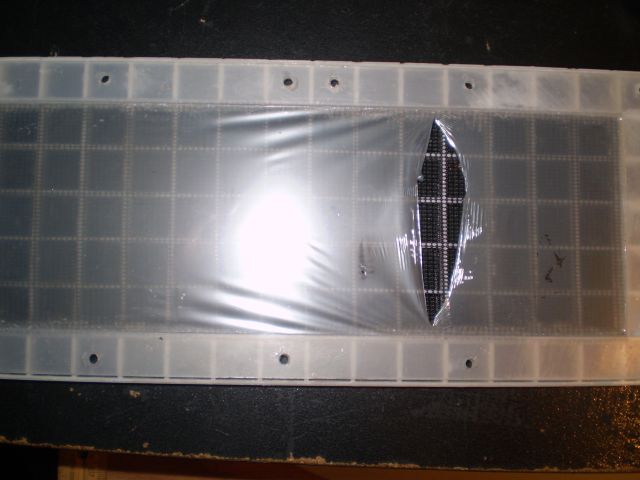

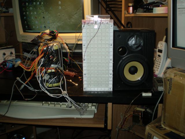

dave,I was thinking of doing that with the small panels I have been playing with.
As all it would take is a couple of quick swipes with a dremel to the screens and wa la ,segmented stator.
And filp them so that they are horizontal insead of vertical so they will fit in the cubby hole better and dampen the rear waves with some fiberglass insulation or polyfill to reduce backwave cancelation and refractions and run them slightly monopole.
just one is quite loud and can't wait to get them in stereo.
what do you think? jer

Jer -- you lost me for a minute with Dremel reference -- until I "zoomed" the picture of your panel construction. If you are going to try RC ladder segmentation I have no formulas for you to calculate R values -- maybe others can help.
the r values can be determined by using the simple rc lowpass filter calculations and the capacitance of each section.
I haven't decided two go with 3 or 5 sections starting from the middle of the panel.
the panels them selves cost only pennies to build should i screw one up or decide to just build a new one. jer
Dave,no there not single ended.
They sound awesome and with no distortions when properly driven.
A very cean sound with no honkyness or colorations like a box speaker sounds like.
When I made them I used my uncle's meter to verify them against the formula and online capacitance calculators at about 40pf and maybe 70pf with the wires attached. jer

Even my 7.75" x 22.25" diy panels give our apogee dueta's a run for the money with the only advantage is size.
Listening to the apogee's were my first experience of listening to some really big headphones.
the panel you see in the picture is only 3.5" x 10" and seems to mate very well with the sony SS-MB150H 4.5" wooffer.
The pink noise response of the two at 18" was flat with the panel running fullrange except below 80 hz was cut off with about 2db to 3db of boost with 12khz highpass shelving eq to taste.
Even though I'm having amplifier issues at the moment, I'm in awe at sound sound of these things just as they sit and thats just one, as I don't them set up in stereo yet.
You can't beat the price per performance either,the sony's were $20 a pair on sale at rat shack and maybe $5 in material for the esl panels.
We know what amps and transformers cost although i got mine as a clearance sale for $20 a piece so I got 10 of them.
I wish I had gotten 10 or 20 more transformers when I had the chance. jer
