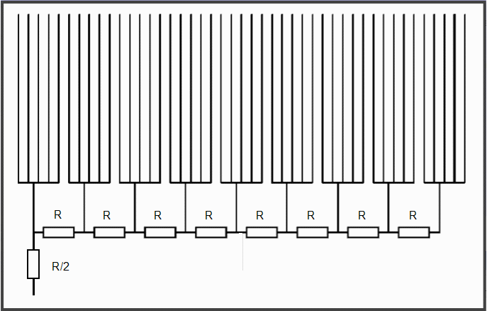

ESL Line Source XL Spreadsheet Calculator
Here is the XL spreadsheet.
I appologize for the mixing of units, but at least I labeled them.
I tried to list all the assumptions and equations on the "Notes" & "Directions" tab, but may have missed some.
Let me know if you notice something missing or the directions don't make sense.

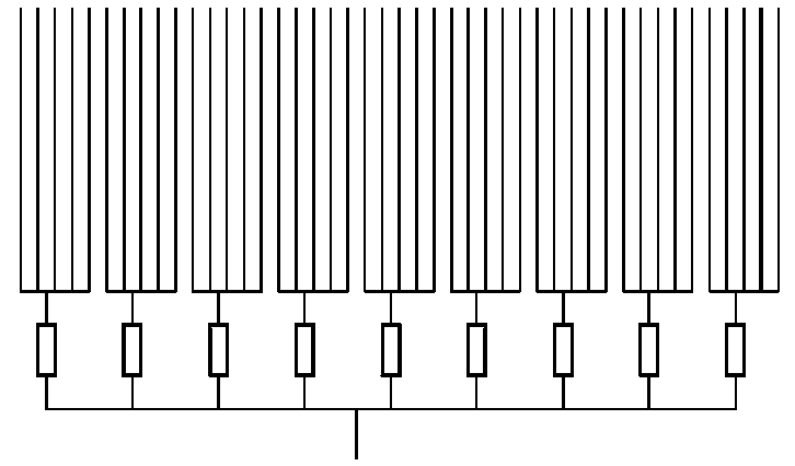

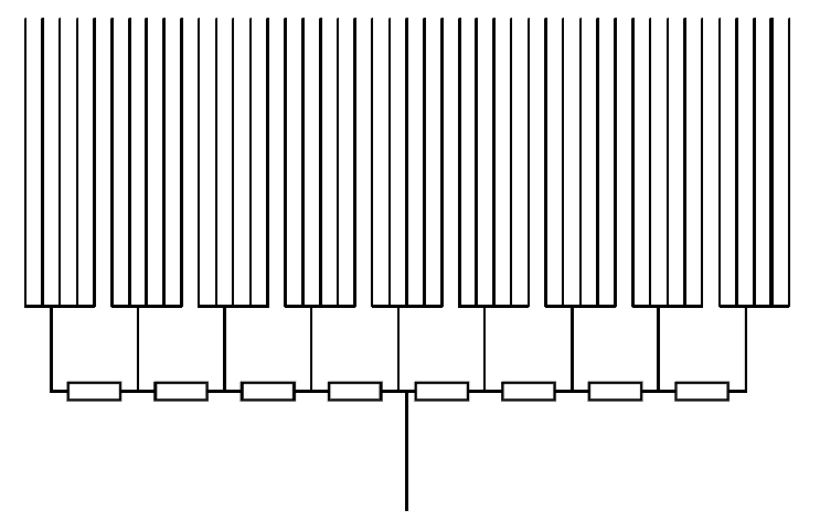

In Frank Verwaal papers there is a table (Part #2 p.80) with the RC filters to be used for linear frequency response. Next figures show the implementation of the idea.
So, am I right, assuming:
1) for different stip widths the table and individual resistors per stip (Fig.#1) is applicable.
2) if the ladder structure is employed (Fig.#2) then all the resistors are equal, strip width are all the same and bolsert's spreadheet is applicable, as well as the AES article we discussed.
Alex

Hello Alexberg,
If you use individual resistors to feed each strip (Fig. #1) you will need increasing resistor values for each section to obtain a flat response. The resistor values shown in Frank's table are specific to his design. ie number and size of each segment, capacitance of each segment, target bandwidth for flat response.
As kavermei already mentioned, the ladder network (Fig. #2) with equal sectional widths and resistors is similar to the symmetric layout analyzed in the AES paper. All that is missing is the initial feed resistor.
The spreadsheet gives values for the asymmetric layout which the AES paper uses when deriving most of the equations. I modified your (Fig. #2) to show what feed layout should be used for the section sizes and feed resistances(R) calculated in the spreadsheet. I now realize I should have included it in the spreadsheet documentation since not everybody who uses the spreadsheet will have a copy of the AES reference paper.
Note that the resistor feeding the first section is half the value of the rest of the resistors in the ladder network. In practice, this resistor can be put on the primary side of the transformer where it can also help with saturation control. Just take the value (R/2) and divide by the square of the step-up ratio. Be advised that you will probably have to tweak the value of this first resistor to compensate for other factors not considered in the HF response as mentioned on the directions tab of the spreadsheet.

If anybody is interested, I can post the ratios or factors to apply to the spreadsheet values for feed resistance and sectional capacitance if you want to use a symmetric layout. Let me know.
I'm planning on a symmetric layout so a spreadsheet version for that would be great! Thanks for the generous offer.
