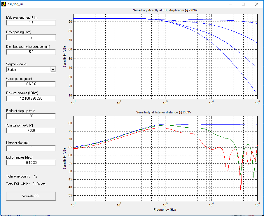

Regarding the use of ESL_line_sectioned_DIY_v4 and esl_seg_ui: more the sections more the high frequencies with the asymmetric configuration 1?
In my case the wires are only 42 so getting double the central section is impossible....
with 9 (8 + 1) sections I set the nearest value that is: 10 4 4 4 4 or, with 11 sections 12 3 3 3 3 3.

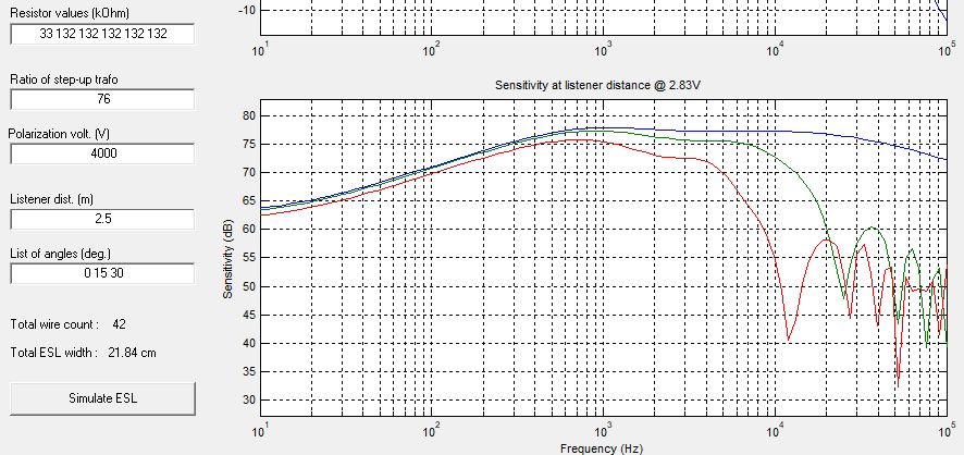

another thing i noticed that if i increase the value of the resistors suggested by ESL_line_sectioned_DIY_v4 the results in esl_seg_ui improve, why?
… i noticed that if i increase the value of the resistors suggested by ESL_line_sectioned_DIY_v4 the results in esl_seg_ui improve, why?

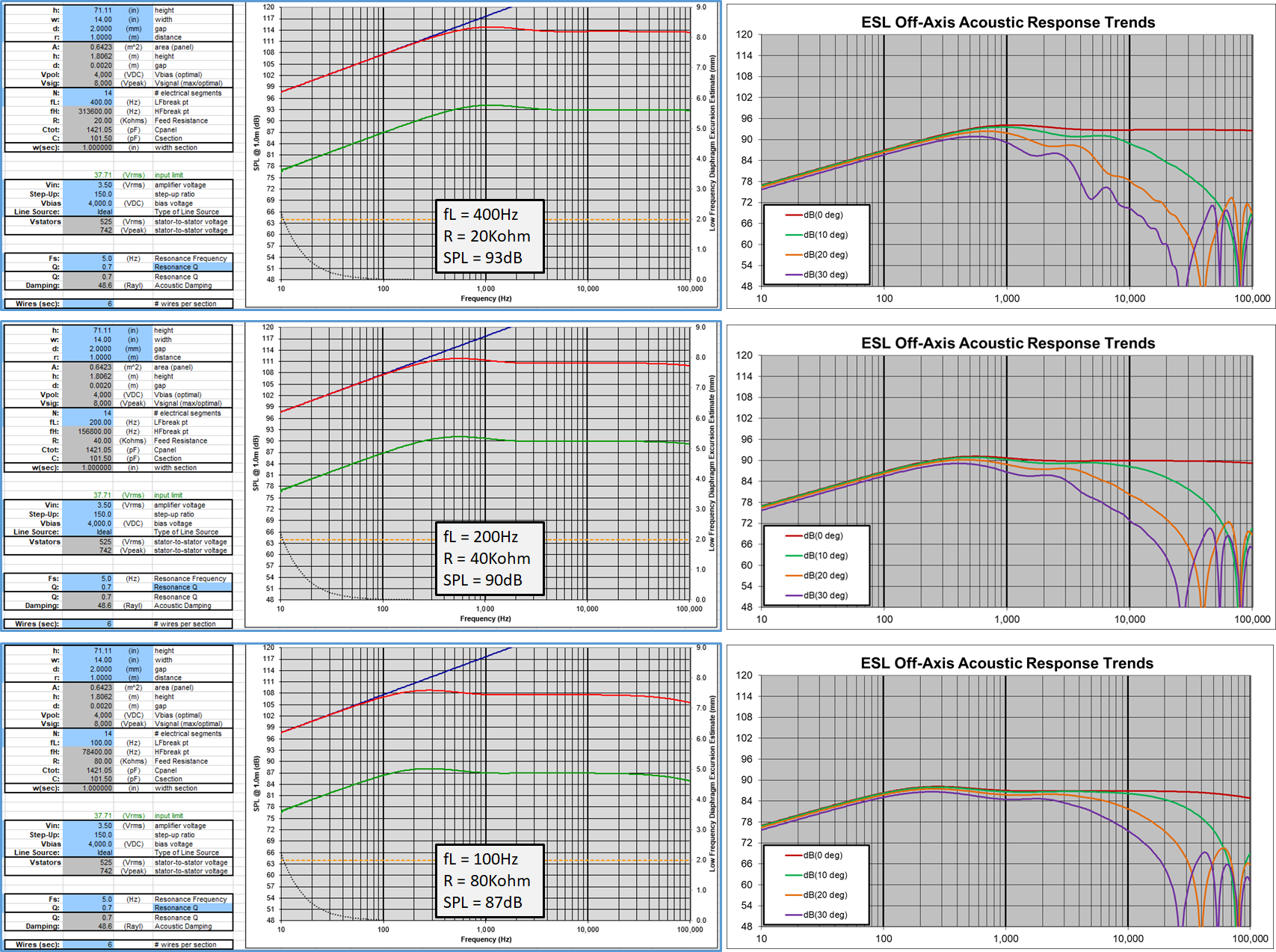

There is an interdependence of HF(high frequency) dispersion, SPL, and fL(low frequency break point) or bass extension.
As one would expect with mother nature, there are trade-offs in desirable characteristics.
Increase segmentation resistors: SPL is reduced:down:, fL is reduced:up:, HF dispersion is increased or improved:up:
Decrease segmentation resistors: SPL is increased:up:, fL is increased:down:, HF dispersion is decreased or worsened:down:
That attached set of plots shows response for fL = 100, 200, and 400Hz, by doubling segmentation resistor values.
You can see the trend in fL, SPL, and HF dispersion.

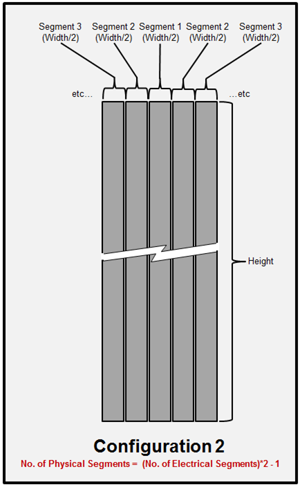

Have had a few PM on the topic of trade-offs in HF dispersion when trying to decide on number of segments and whether to use symmetric Configuration 1 or 2.
  • If your panel width and fL have been chosen, the dispersion will improve with increasing number of segments up to a point.
    Beyond that, further increase in number of segments does not improve the dispersion further for frequencies < 20kHz.
  • Configuration 2 needs only half the number of segments as Configuration 1 to achieve nearly the same HF dispersion.
  • Be sure to consider the output impedance of your amplifier when deciding which Configuration to use. In particular, it is not unusual for tube amplifiers to have output impedances of several ohms which will cause HF response to droop with Configuration 2 because it requires much lower series resistance feeding the central segment.
    Thanks to alexIG for identifying this issue.
Post with plots comparing polar response for different number of segments and configuration:

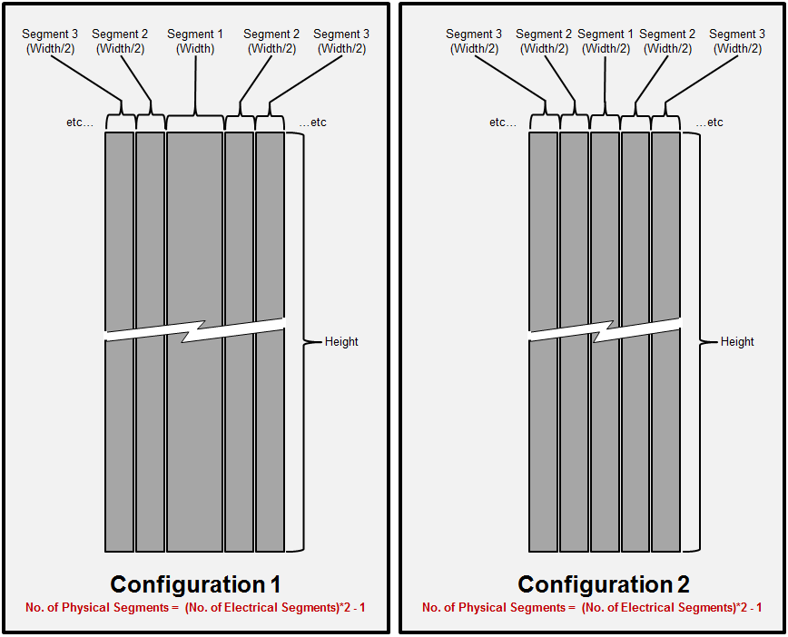

Please excuse my novice questions, but I would like to get some confirmations on the proper use of the Excel model.
I am modeling a push/pull, 2-stator design. How is the 2-stator versus 1-stator input data differentiated in the spreadsheet ? Are the data input fields in the "ESLline(SPL calc)" worksheet intended to be for a single stator or does something have to be done to represent 2 stators ?
I calculated the center to center wire (C2C_DISTANCE) distance, multiplied it by the total number of wires and entered it into "2 ==>", cell C10 as =(TOTAL_NUMBER_OF_WIRES * C2C_DISTANCE). Is this the intended width for this field, or is it something else (e.g. mylar width) ?
The design is 7 + 1 + 7 = 15 segments. I entered 15 into "5==>", "# electrical segments", cell C18, is that correct or should it be 7, 8 or something else ?
The formula's resulting value in w(sec), cell C24, "width section" matches the value I calculated which seems to confirm the preceding.
Each electrical section has 6 wires in a single coil (if I am using the proper terminology) on each stator. When I enter 6 in "13 ==>", "# wires per section", cell C41, it generates the following on the "System Config(2)" worksheet, "3 3 3 3 3 3 3 3 3 3 3 3 3 3", 14 3's. Is this correct ? I was assuming it would be 6 something as entered on the "ESLline (SPL calc)" worksheet.
The "distance between wire center (mm)" on the "System Config(2)" worksheet matches what I calculated.
I haven't tried using the esl_seg_ui yet until I understand the spreadsheet.
Thank you for your help and again, excuse the newbie questions.
…Are the data input fields in the "ESLline(SPL calc)" worksheet intended to be for a single stator or does something have to be done to represent 2 stators ?
The spreadsheet and els_seg_ui assume the traditional 2 stator configuration.
Input 2==> defines the total “driven” width of the ESL based on Asymmetric or Symmetric Config (1) geometry. If you are using one of those configurations, you can simply measure the width of the stators or calculate based on total number of wires and C2C distance. If you plan to use Symmetric Config (2) the width needs to be adjusted slightly to be the (total number of electrical sections) *( width of outer electrical sections).
The design is 7 + 1 + 7 = 15 segments. I entered 15 into "5==>", "# electrical segments", cell C18, is that correct or should it be 7, 8 or something else ? The formula's resulting value in w(sec), cell C24, "width section" matches the value I calculated which seems to confirm the preceding.
Think of an electrical segment as a group of wires that receives the same electrical signal. For Symmetric configurations, these electrical segments are split in half and each physical half placed symmetrically about the central segment. The symmetric configuration TABs contain images that help to clarify the relationship between physical segments and electrical segments. You may have to scroll down to seem them. The image for Symmetric Config (2) is attached.
If you have 7 + 1 + 7 sections of 6 wires, this would be a Symmetric Config (2) with 8 electrical sections; the central electrical section has 6 wires, the outer 7 electrical sections have 12 wires(6 on left + 6 on right). The width you would put in 2==> would be 8 * 12 * C2C. The calculated w(sec) value is the width of the electrical section(ie 12 wires)
In 13==> you enter the number wires in an electrical section. In your case, 12. The System Config(2) Tab should now specify “6 6 6 6 6 6 6 6” for the “wires per segment” input to esl_seg_i. In this esl_seg_ui input block, the first number specifies the number of wires for the center segment. Each successive number specifies the number of wires in each physical section arranged symmetrically about the central segment. So, a second number of “6” means section 2 is made up of 6 wires to the left of the central segment AND 6 wires to the right of the central segment. Total width = C2C*(N1 + 2*N2, + 2*N3 + …)
No worries, let me know if anything needs further clarification.

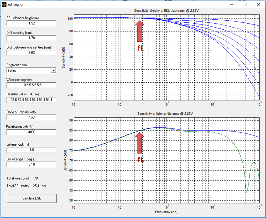

Probably the easiest way to visualize the progressive LP behavior as you move along the segments is to load the segment sizes and resistor values into the esl_seg_ui utility, and look at the upper plot which shows frequency response of the voltage across each segment. Example from Post#100 attached. You can see the response isn't “truncated", but rather gently rolled off. Are you interested in the -3dB down point? There is probably a way to calculate it, but I’m not sure how useful that information would be. What did you have in mind?
