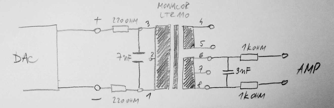

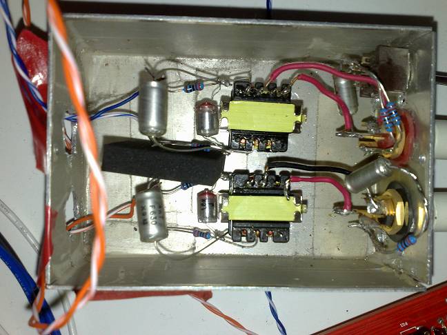

@ gamgee
Here is a picture of my monacor implementation.
Input from DAC (before capacitors at L+/-, R+/-) through series resistors of 220 Ohm to connection 1 and 3.
In between 1 and 3 a capacitor of about 7 nF. (4,7 + 1,8 in my case).
From 6 and 8 to the output with a resistor of 1k and cap of 3nF between 6 and 8.
Hope this helps.
BTW this really is worth the extra 20 euro!!!!
The values above from earlier posts really do the trick, I tried without output R and C, but sounded rough around the edges, really unnatural.
With a lower input-cap the sound is less polished. Maybe the pre-amp does not like the HF-garbage.

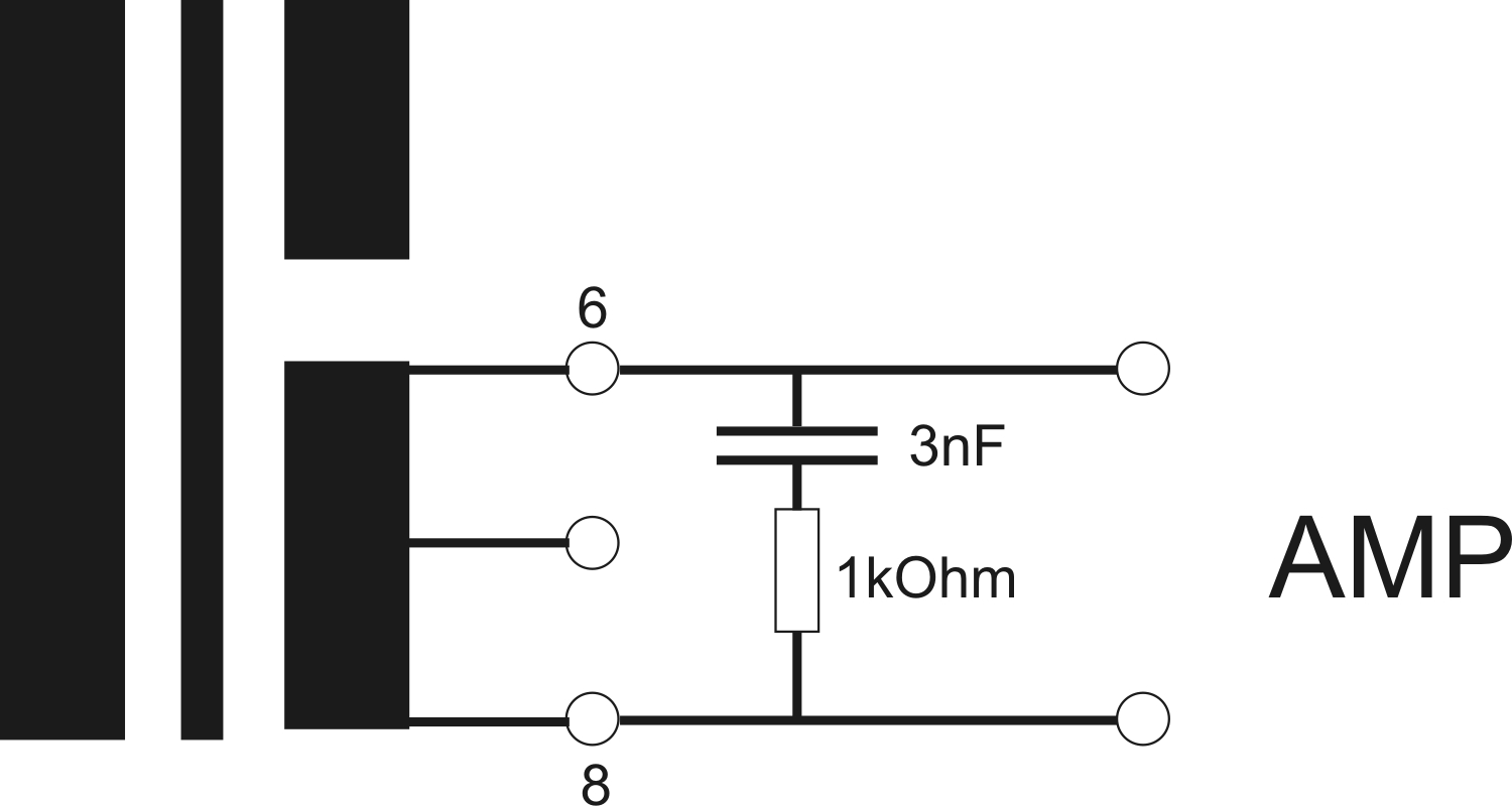

Hope this helps.

I meant nano, you can check this with earlier posts, I think it was Legarem who came with these values after doing calculations and listening test.
But you can try both and listen if you hear the difference!

outputs 6 & 8 on the trafo go on which part of the RCA respectively)
Does not matter as long as it is the same for left and right.
Maybe you want absolute phase to be correct?
Than you need to do some extra testing/measuring with which I can not help you.
Would be interested myself too!
If you put 1 on negative and 8 on ground/earth/negative the trafo is not supposed to change absolute phase.
Don't know what the DAC is doing.
(Don't make connections between 1 and 8 directly or indirectly)

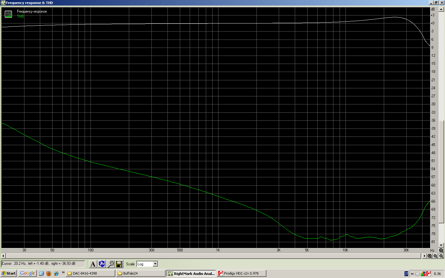

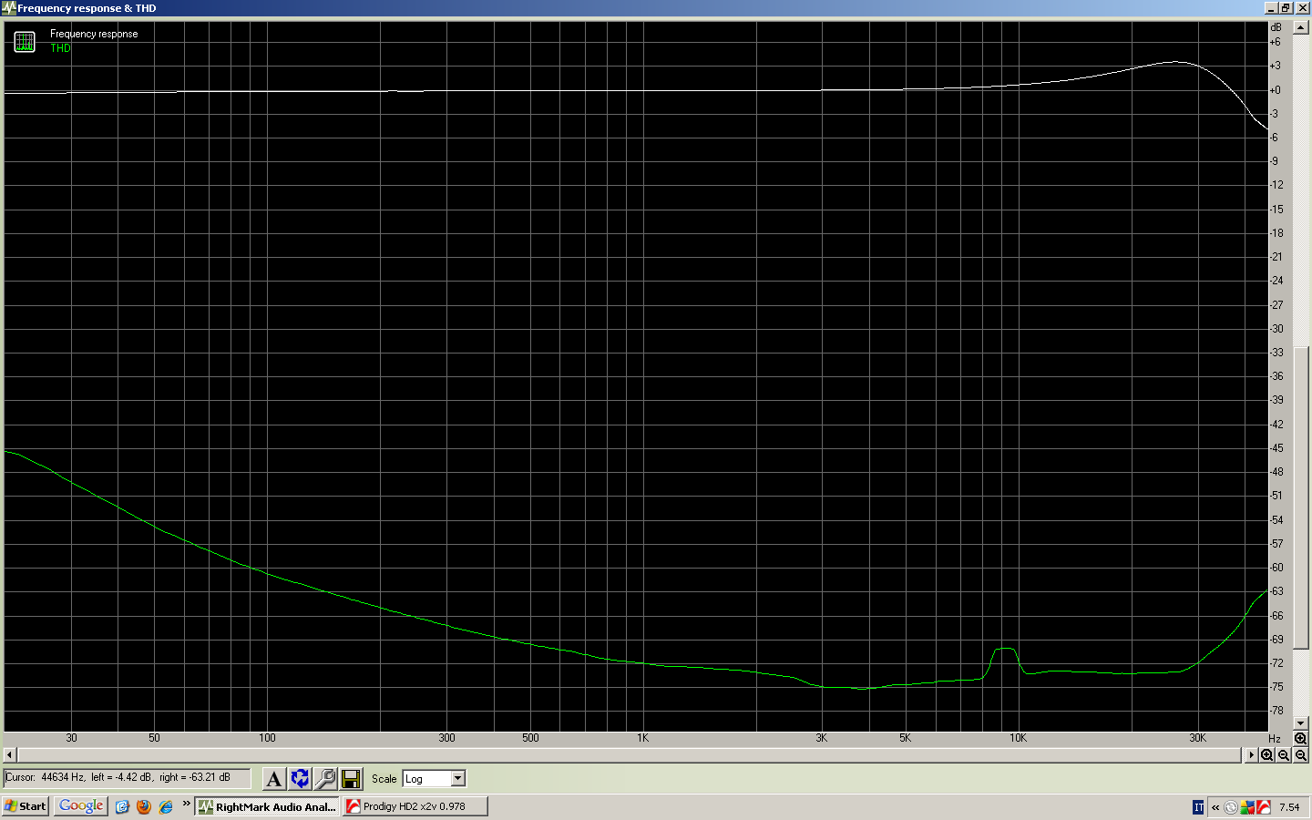

I bought 4 Monacor LTR-110 to do some experiments with this DAC and a Buffalo24 from Twisted Pear.
For now i have connected the + and - DAC out directly to the primary of the LTR-100 and the secondary to RCA with a 10K resistor in parallel for both DACs.
I attach the results of measurement done with RMAA.
Next i will try a better way of connecting the transformer to the DAC (something like the way descripted by GerardA on post #1285)
Anyway i can say that i really like these transformer out DACs, it seems to me the Buffalo24 is a little bit better in detail and in the positions of the instruments on the soundstage.
Ciao
Andrea
(on the left CS4398, on the right Buffalo24)
