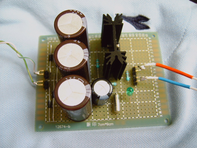

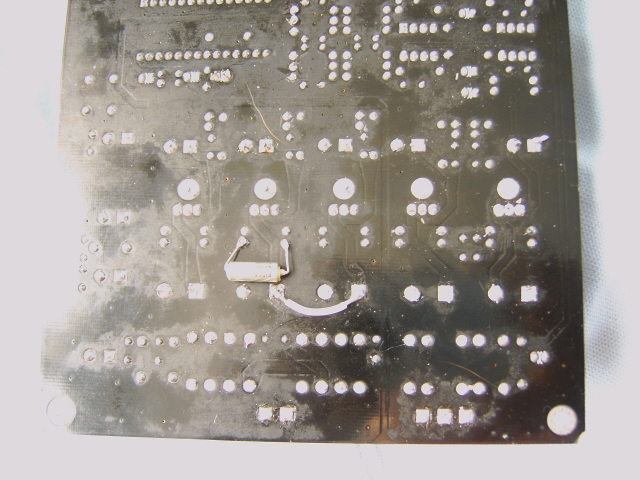

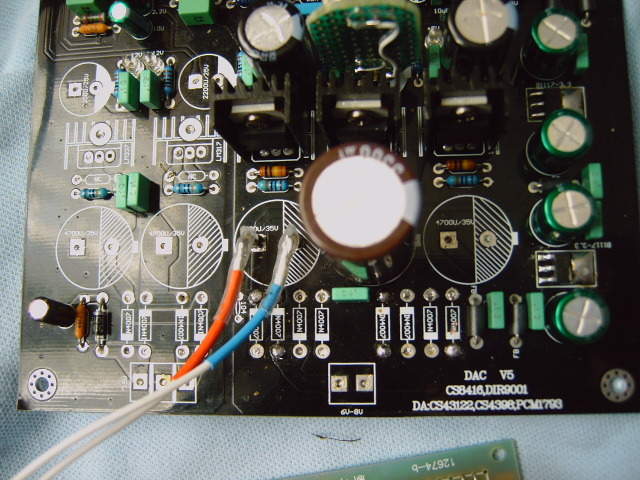

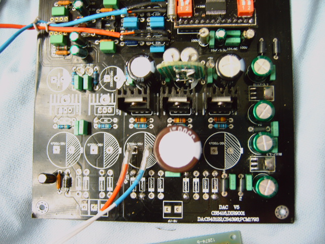

Hello !

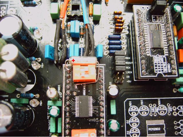

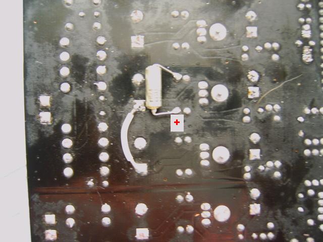

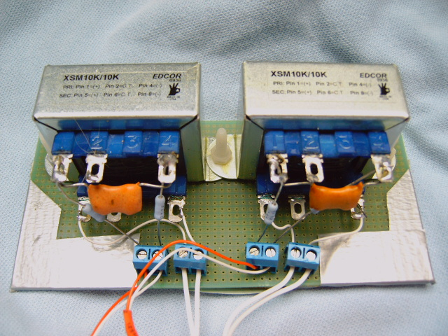

Some mods I've done, with this board, using Edcor XSM 10k/10k
The metalized grey caps are Solid Tantalum glass encapsuled , like Sprague 150D or Kemet (mines are Firca CTS)
On the cs4398 board, 22µf, 16v Vref to Gnd (scratch the black varnish ) pict.#10
replacing black 1000µf, two 140µf // pict #10 on left , mounted on a mini board
Board underside, missing a cap, installed 22µF tantal // adjust voltage resistor
Some white wire, Teflon 0.6mm2
All parts not usefull are discarded, and will be used to build the "filtering" board
About Transfos : Edcor xsm 10k/10k, 12.97$ each !!!
A low pass filter 2 x 270 Ohms // 2nf Silver mica > 150khz

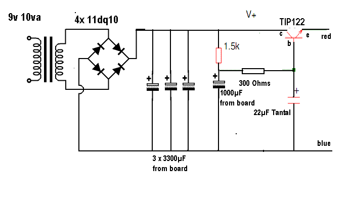

The filtering unit :
9v 10va transfo (not seen)
4 x diodes 11dq10
3 x 3300µF // from board
Transistor Darlington TIP122
1 Pi filter : 1500 Ohms + 1000µF (from board)
2 Pi filter : 300 Ohms + 22µF tantal
Led is optionnal
Just to buy tantal caps, diodes, and TIP122, other parts coming from dismantling board
Filtering Schematic with details to come...
Sorry for by bad English..
Hope this helps ...
Richard

Filtering board schematics added .
You have to control you have ~8-9v at the Tip122 output
TIP120-121-122 are ok, medium power NPN darlington high gain
The filter prevents lm317 to "see" EMI from mains
R.C.
