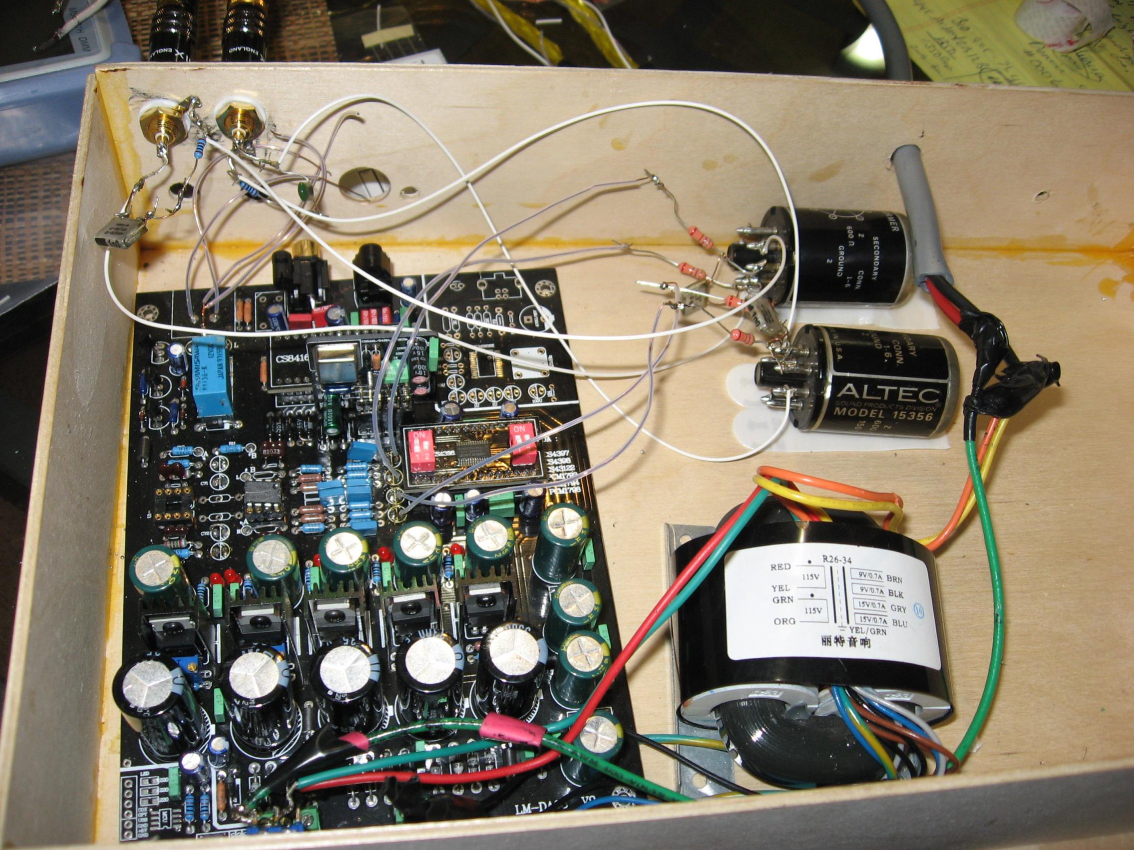

As far as the output level and interfacing, if low impedence (600ohm) output trafos are used, a 10k pot will work fine. If 10k trafos are used then you might have trouble using any pot, your amp input impedence must be very high, such as a tube amp or jfet front end. In any case, use short interconnects, there isn't a lot of current available.
Uh-oh, I intend to use the Edcor 10ks I ordered to a B1 Buffer --> low input impedance amp. Is this going to be a problem?
Just change the pot to 100k, the impedance of the b1 is in the millions.

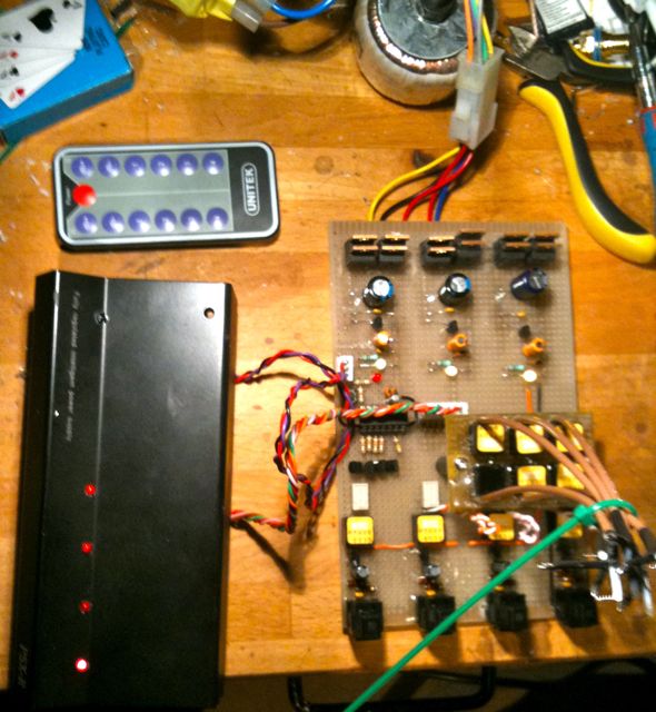

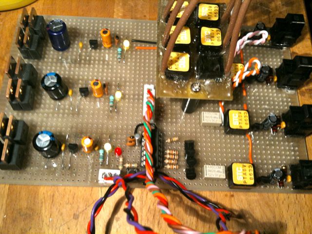

Ok thought you guys mite like to see what I've been upto? Few changes from the pix I've added a bigger regulator to the 12v rail feeding the optical inputs, just so it runs cooler.
Each main section has its own transformer winding, IE the pic has one, the control relays, and then one more for the optical converters, each optical RX also has its own 5v regulated supply fed from a 12v pre regulated supply.

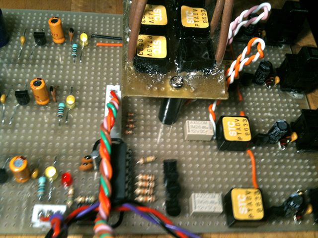

Nearly (hopefully by the end of the weekend) got the Input / output board done. The tails on the top board are for the Coax sockets the little squares are pulse transformers so as you can see every socket is isolated from each other. I'm not the best at the aesthetic work but I'd say its passable just about?
Still the power/lock led to do, this will be in the usual cyrus on/off position and will be wired to show green on signal lock and red on loss the PIC I'm using allows for a 5th infrared signal to be stored for all 4 inputs not to be selected to it will go to non lock state mute the outs and show red in off mode. Those with keen eyes will see a small switch next to the Pic this allows it to go into learn mode so you can use any remote commands you like.
Been running it as test for a bout a week now and its working really well, so next part is the output buffer board, then I will build my own regulator section for the dac and dac subboards.
What Ya think?
It has 3 optical inputs paralleled up with 2 coax sockets each all isolated from each other and 4th input optical / usb. Reason for extra sockets is so I can pass signals to my surround for 5.1 data
What Ya think?
