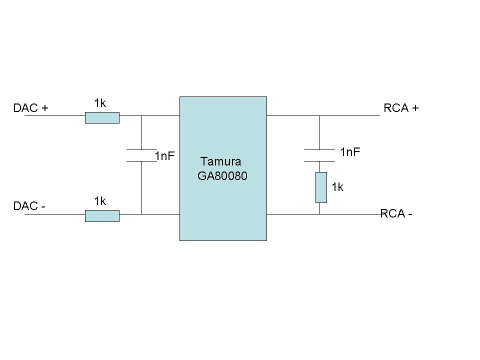

I've been running this dac a while now using Tamura 80800s on the outputs, thanks go to hoverdonkey for getting me started.
Primary and secondary loading are shown in the pic.
I'm finding the presentation a little restrained. Can anyone give me a steer on getting a little more forward presentation without putting my speakers at risk?
I am using Lundahls trafos,and I to think it sounds a bit restrained.I don´t use the cap and resistor on the sec. and not the cap on the prim.But I do use the resistors on prim.
And I wonder is this resistors necessery?What are they for?Maybe I can try without them?

The cap/resistor on the secondary are a low pass filter to get rid of the digital to analog artifacts. But the transformer itself has limited bandwidth, so they may be unnecessary.
I don't know the purpose of the cap on the primary.
The resistors on the primary are there to keep the load from being too low on the DAC. But a previous post in the thread mentions that the load attached to the secondary is seen by the DAC and you actually want a parallel resistor to lower the impedance seen by the DAC. This is what is confusing me.

NO !!!
The cap/resistor on the PRIMARY are a low pass filter (~150khz) to get rid of the digital to analog artifacts
The cap/resistor on the secondary are a anti-ringing filter, the values depends on the transformers characteristics , above 80 khz
