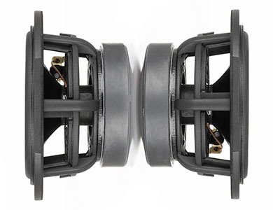

or as you said isobaric (unless I am mistaken)
You are mistaken. The woofers are push-push pairs. This is really only practical with side monted woofers in this situation.
Anyone can add a woofer/subwoofer. The beauty of the blade is the way the drivers are physically configures.

what are peoples thoughts on making a Kef Blade/Muon clone type thing by using the KEF LS50's and just adding either a sub, or Bass or low mid and bass in a separate box?

As Planet10 said, this is very practical approach. Most high quality small 2-way speakers can really shine if the bass frequencies are removed from their signal path. I would use a pair of subwoofers, and crossover above 100 Hz, probably closer to 150 Hz. It is probably best to position the subs within a few feet of the LS50s. I would use a good DSP crossover such as MiniDSP HD 2x4.

In this ‘push-push’ configuration, the forces exerted on the speaker by the two woofers cancel each other out, keeping the cabinet perfectly free of any resonances that could harm sound quality.
From that page. The acoustically in-phase, mechanically out-of-phase with tight coupling of the drivers, the reactive forces of the basket of one driver (almost) cancels the reaction force of the other, dramatically lowering the energy that goes into the cabinet.

It is. Dave has some excellent drawings that he did years ago that make the mounting concept clear. I don't recall who first brought it to my attention, but it would have been many years ago, as the late djk explained PPSL to me back on AA before diyaudio was very big at all. It wasn't new then, but gave me ideas on how to implement it in that application, though I'd need a drawing to explain, but it worked well in my PA at much higher levels than almost all domestic systems use and the cabs were almost vibration free.
If you think about how your going to implement and physically construct the enclosure for push-push mounting in the design stage, it involves minimal extra effort for very worthwhile results.

The first pic is using the unique PEARL woofers where a bolt is intended to tun thru the pole-piece. Bill has never done (or advocated AFAIK) push-push.

That makes sense. I'd rather do push-pull but in practical terms, especially if for a commercial design, an exposed driver basket and magnet isn't going to help sales and if enclosed somehow will be more difficult to make, especially if it needs to be pretty.
Barefoot MM27 has 2 woofers bolted together using a wide metal ring around 2 magnets. It has become one of the most popular nearfield / mid field pro studio monitor for last 20 years. I owned them. The bass is very tight and cabinet has almost zero vibration. BTW, the designer, Thomas Barefoot used to be one of the most famous DIY speaker builder before he started his own business.
