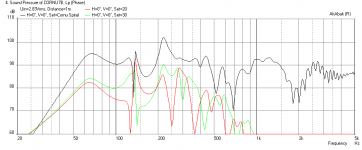

I did a sim for Cal's FF125WK driver a few posts back. It looks pretty good and I believe had sufficient xmax. But I think you can get better performance from the W4-1052SDF driver as it has more bass extension and costs less.

It's fast because the model is built and I have a database of 100+ drivers on hand that I have created over time. So no problem to help. I have not tried the W4-1052SDF but I know Prezden has tried the W3-1320SIF and he really likes the sound of it. This one is similar but has poly cone and higher Qts which will give a slightly better bass extension. If you want a sure thing, you can't go wrong with the 1320SIF Bamboo paper cone. No need for fancy drivers with Nd magnets - which will tend to have a more powerful motor with lower Qts and not as deep bass extension for the same fs.
I agree with Cal that wood channels will not sound better - the foam may actually have beneficial acoustic damping effects.

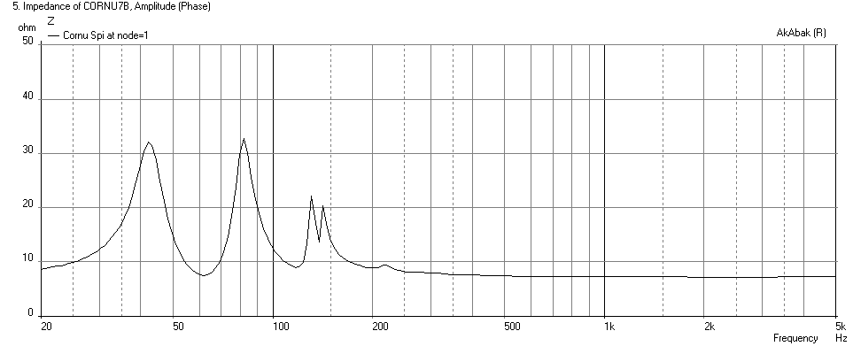

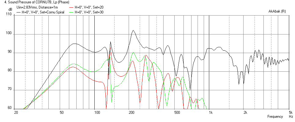

Here is the W4-1879 in a 27.55 in x 5 in deep Cornu - very similar to the lower priced W4-1052SDF, but less bass extension.

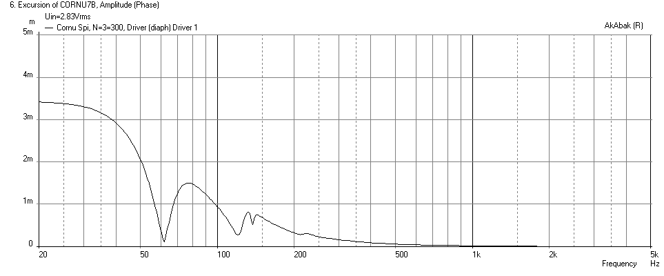

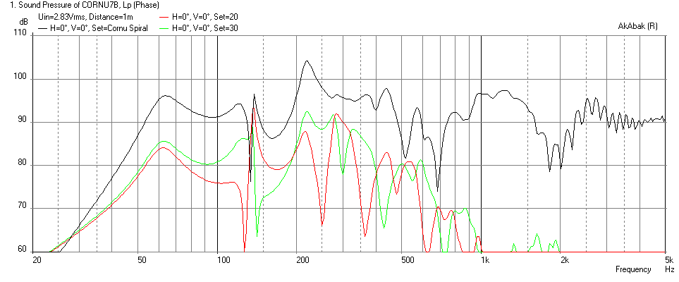

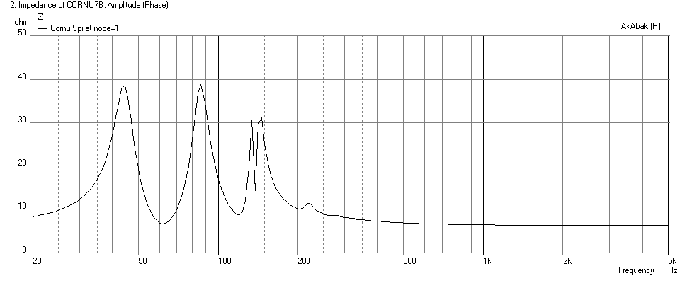

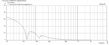

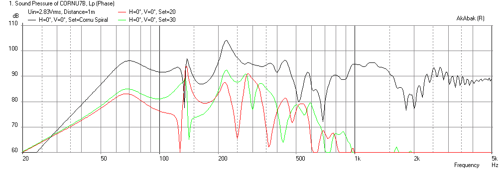

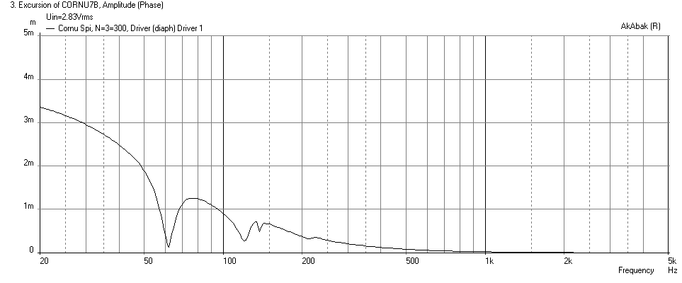

Cornu with W4-1320SIF
Here is the sim for the W4-1320SIF. Speaker is mounted on wall at 48 in above floor (centerline of driver). 27.55 in x 5.0 in deep.
SPL vs Freq.
Impedance
Cone Excursion
Looks like it should work well.
good luck building it!
X
SPL vs Freq.
Impedance
Cone Excursion
X
My vote is for the W4-1320sif as it has a more efficient high freq which will be needed to balance the bass amplification the horns provide. Although a simple 4 sided foam core front horn/waveguide that goes from 4x4 in to 10x10 in over 4 in depth will give you about 10 dB gain on the HF to balance. It looks funny though. 🙂
