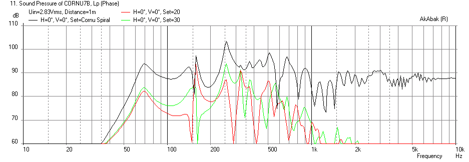

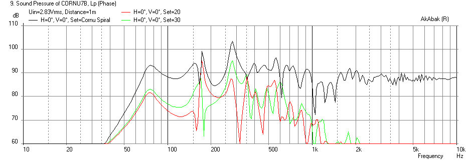

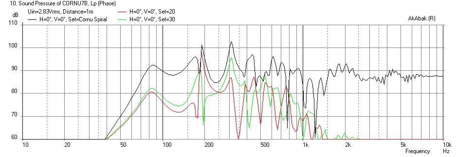

Here are sims of the Cornu with the driver you have chosen. It can work reasonably well in a Cornu ranging from 20 in to 24 in x 2.5 in deep. The bigger, the deeper the bass. I would go with the biggest you can. The 24 in will reach down to 60 Hz.
X
20 in x 2.5 in deep:

22 in x 2.5 in deep:

24 in x 2.5 in deep:

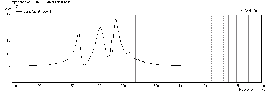

Impedance of 24 in:

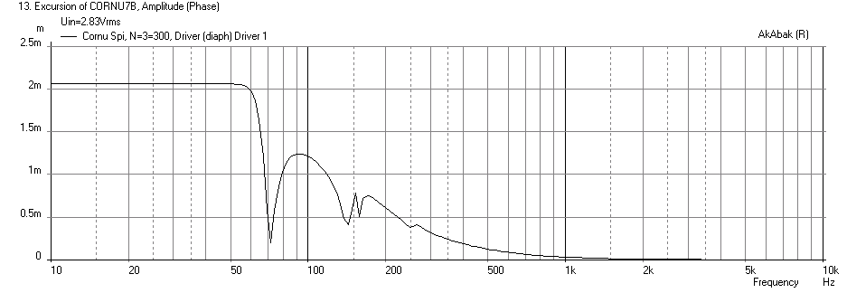

Cone Excursion of 24 in:

Good luck with your build! It will sound great. 🙂

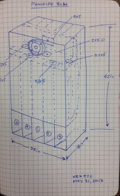

I noticed that the path length down one side of the split is different from the other side, maybe about 15%. How does this affect the output, in comparison to a single path (no split) with the same overall cross-section area?
This is my first horn encounter, just trying to understand how this stuff works. 😱
It helps to provide a smoother frequency response. Look at the results of the simulation from the earlier post:
371621d1379418668-ever-think-building-cornu-spiral-horn-now-you-can-cornu-24x2p5-fe85-freq-1m.png
The red (shorter path exits to the left on the bottom) and green (longer path exits down on the right) line represent the output from the two different length horns (just 2 of 4). If you had just one length, it would be double the amplitude of the green without the red to balance it.
Of course, this can be taken to an extreme as in the case of my Panpipe BLH (5 unequal length horns): http://www.diyaudio.com/forums/full-range/236779-panpipe-pentahorn-blh-speaker.html
So far, no one has been crazy enough to make this to see if my simulations pan out 😀

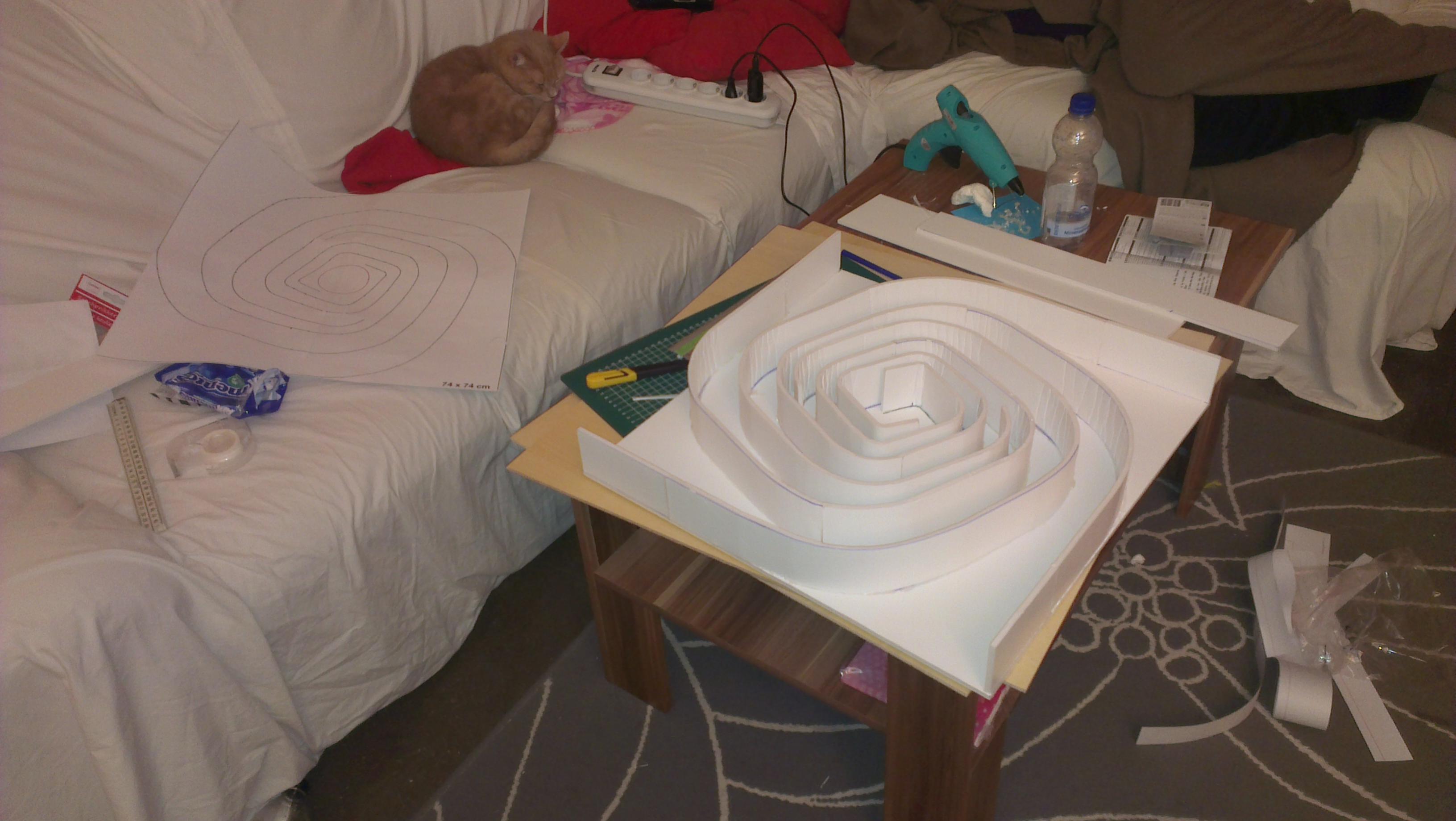

The foamboard arrived yesterday and i'm well on my way making my first speaker. 🙂 Decided to try a 50cm in foam first, but already have the plywood ready for the second one. Hope to finish it this weekend!

That's my lovely assistant who's fallen asleep on the couch.. she was actually quite usefull in holding down the foamboard strips waiting for the glue to dry, but it did get a little late.. (2am)
Waiting for the front part to dry now and thinking about how to attach it to the wall 🙂

Thanks, it turned out pretty good, first time i used a glue gun.
One thing I wonder about on a practical vs theory level is why a bunch of small mouths apparently end up acting like one big mouth? Since the low freq. cut off of a horn is supposed to depend in large part on the circumference of the mouth, one theoretical guess might be that you would have a bunch of trumpets sounding, instead of a tuba.
I can imagine how a wavefront could be divided up and then recombine at multiple mouths. But then also if there are different path lengths, then what is recombining and how and when? Maybe the spikes in the FR graphs partly show constructive and destructive interactions outside the horn mouths.
Maybe the small cornu horn segments are more resonant-like a TL-than a horn? What is the average the path length on a 24" cornu? Something like 20"?
The wall would extend the horn, sure, but Cal's cornus made good sounding 60hz or so bass in "free air" outside at DIYFEST.
Of course all practical size horns for the home are not big enough to act like an ideal horn in the lower bass range, and so are so compromise between a horn and a pipe utilizing standing waves.

Howard,
The 24 in Cornu has an unfolded longest horn path of 1.44m IIRC. That is consistent with 60 Hz 1/4-wave freq. The size of the mouth as a radiator is taken into account by the AkAbak sims so the influence of mouth size is in there. As BLH's go, the Cornu is one of the few with an expansion ratio >> 10. It is 25 in fact and this accounts for its ability to get +10dB to +12 dB gain in the bass region without taking up a huge amount of room on the floor.
