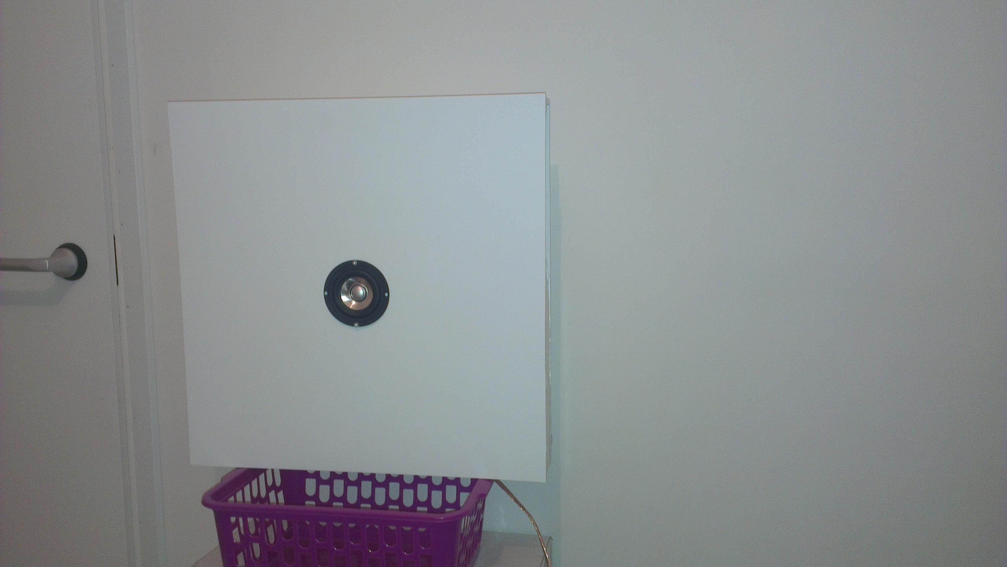

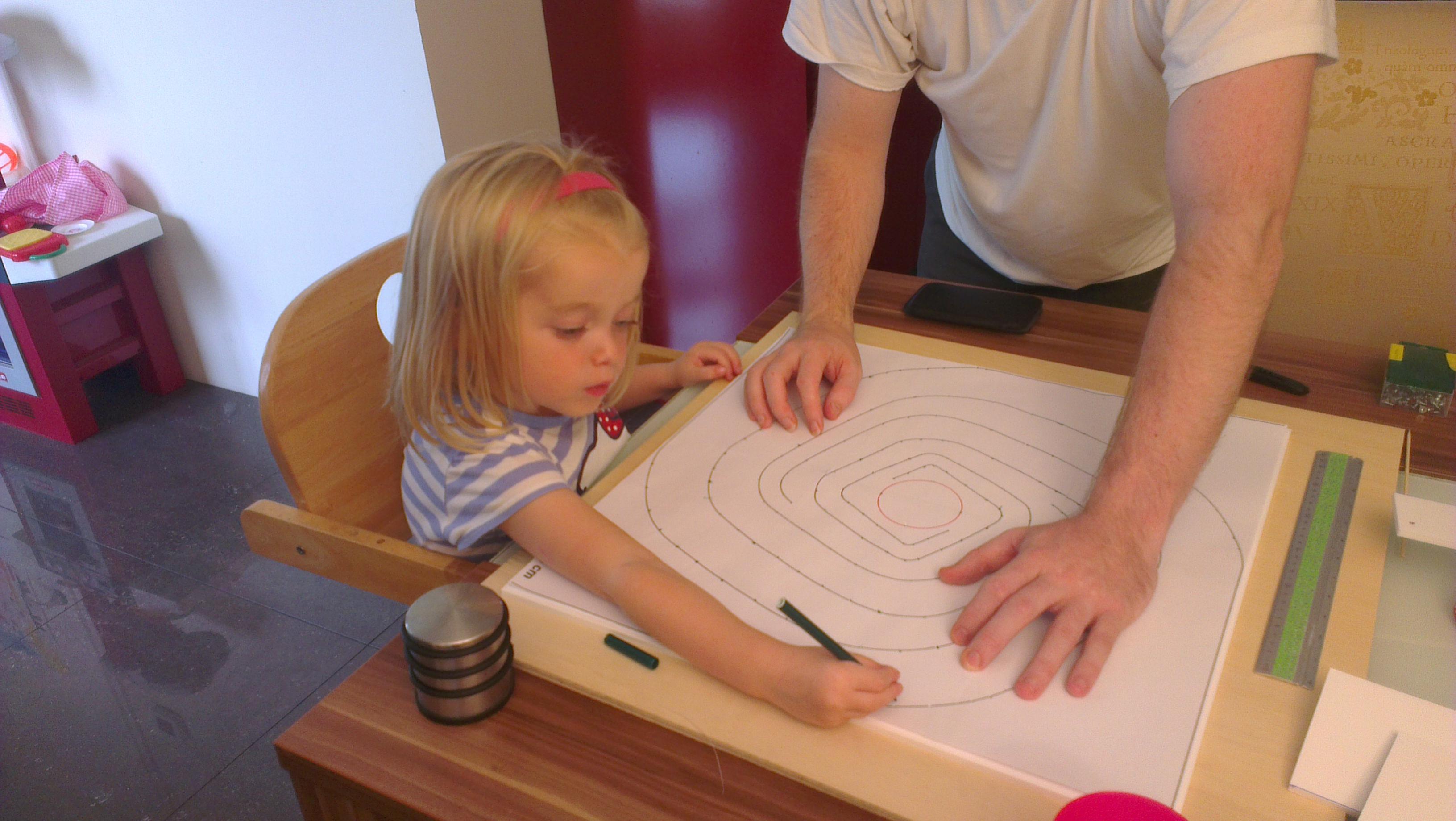

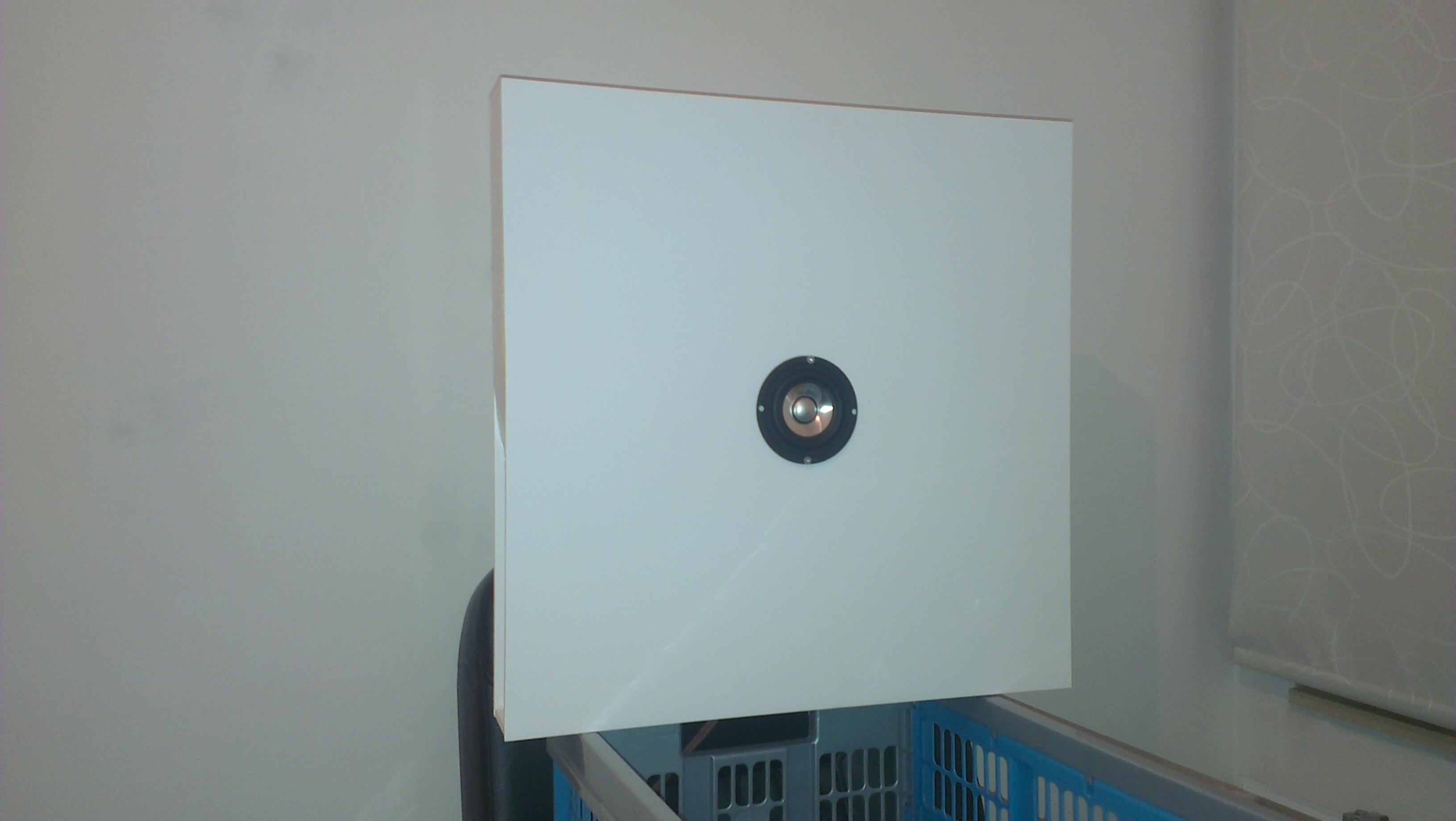

well i finished my second speaker today, as you can see i had a professional helping me this time 😀 and i absolutely love how these sound.. i never expected something i made (out of foamboard even) to sound this good!
All of this is already in earlier posts but to help out anyone who is considering to build these themselves:
I used the scaleable pdf from post #30, if you print it with adobe reader x or higher you can select poster, then it will print over multiple pages and you can tape them together quite easy.
If you want to scale it to another size, mind the 74x74, that's the size of the red line, the black lines are 70x70 in that pdf 🙂
After sticking them together i made holes along the lines to create a stencil, then just go over it with a marker and connect all the dots.
After cutting the strips i used a ruler to bend them, place the ruler on the place you want to bend it, press down on it, then bend the foamboard around it, move the ruler a bit and repeat. Gives you much cleaner bends then folding it by hand.
I hot glued the strips to the bottom and used a polyurethane glue for the top.
Well that about covers it 🙂 can't wait to start building the next pair!

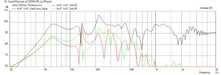

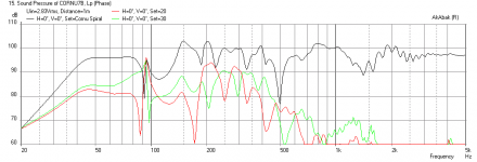

Coen,

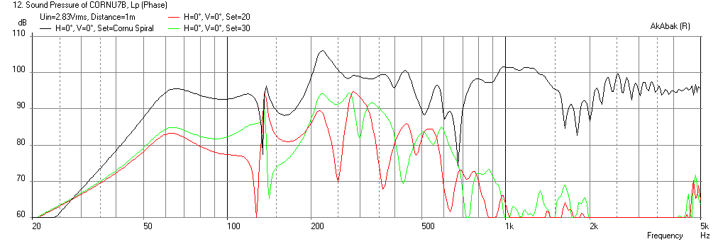

I did a sim for Cal's FF125WK driver a few posts back. It looks pretty good and I believe had sufficient xmax. But I think you can get better performance from the W4-1052SDF driver as it has more bass extension and costs less.
The FE126EN, has a good frequency response for a 27.55 in x 5.5 deep Cornu:
But suffers from a very small xmax which is exceeded at 1 watt, so I woud not recommend.

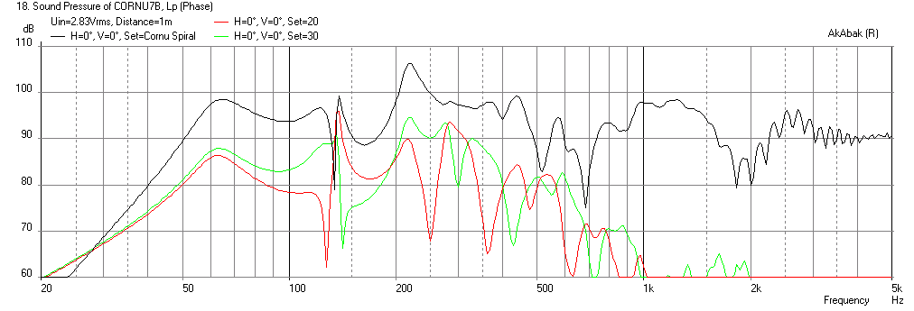

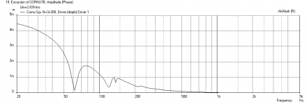

The FE166EN is a 6.5 in class driver and will not physically fit in the driver chamber unless you scaled up to a 40 in x 6 in deep Cornu. The Freq response looks very good and it will go all the way to high 40 Hz.
The xmax starts to run into some issues at 1 watt - but the driver can probably handle more before damage. The huge baffle is the problem - it is very big and will dominate any wall.

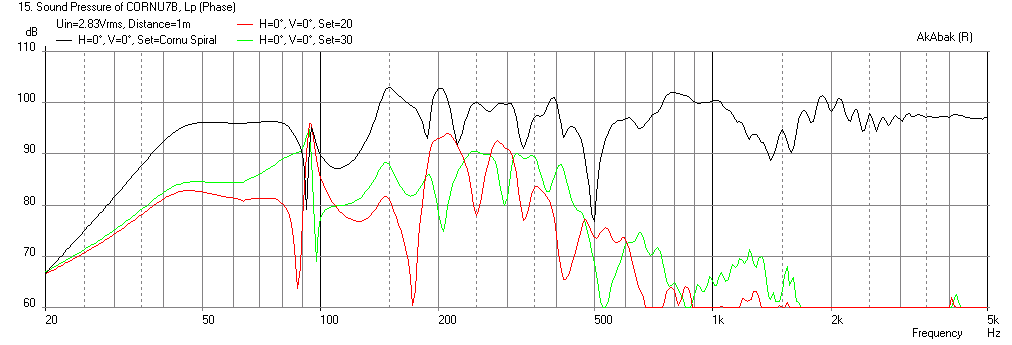

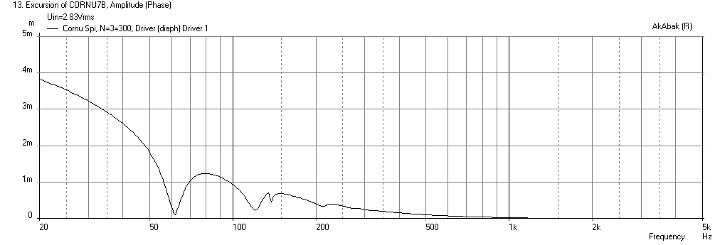

I think you may want to try looking for a 4 in class driver with a fairly high efficiency of close to 90 dB, xmax > 1mm, and a moderately high Qts in the 0.4 to 0.8 range as this will actually give you improved bass extension. Something like the TB W4-1052SDF can work nicely and not cost a lot.

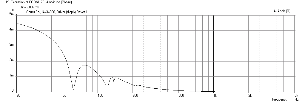

TB W4-1052SDF in 27.55 in x 5 in deep Cornu:
Cone excursion for W4-1052SDF
