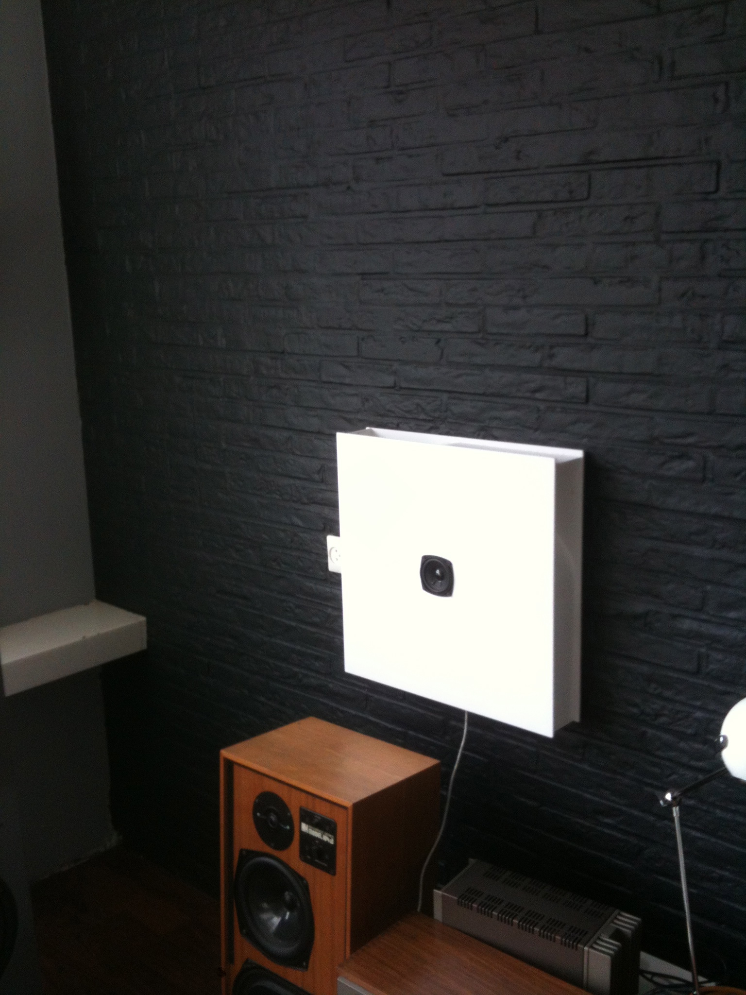

Nice work Xerxes. Glad they worked out for you and sound good. The FRS8 is kind of a small driver, you might want to try a TC9FD if those are available where you live. I recently put my Cornu's with the TC9FD's back on the wall (after having been out for a long time since I borrowed their drivers), and man it still sounds really nice. Jazz with saxophone and stand up bass just has a wonderful spaciousness and open soundstage that really draws you in. It put a smile on my face and reminded me why I got into diy in the first place. I still think that the TC9FD and a 20 in foam core Cornu is perhaps one of the best values out there for great sounding, easy to build, and unique looking speaker. I will be listening to more songs through it now. Classic rock (Blues Travelers) actually sounds really good with the Cornu, surprisingly good in fact.

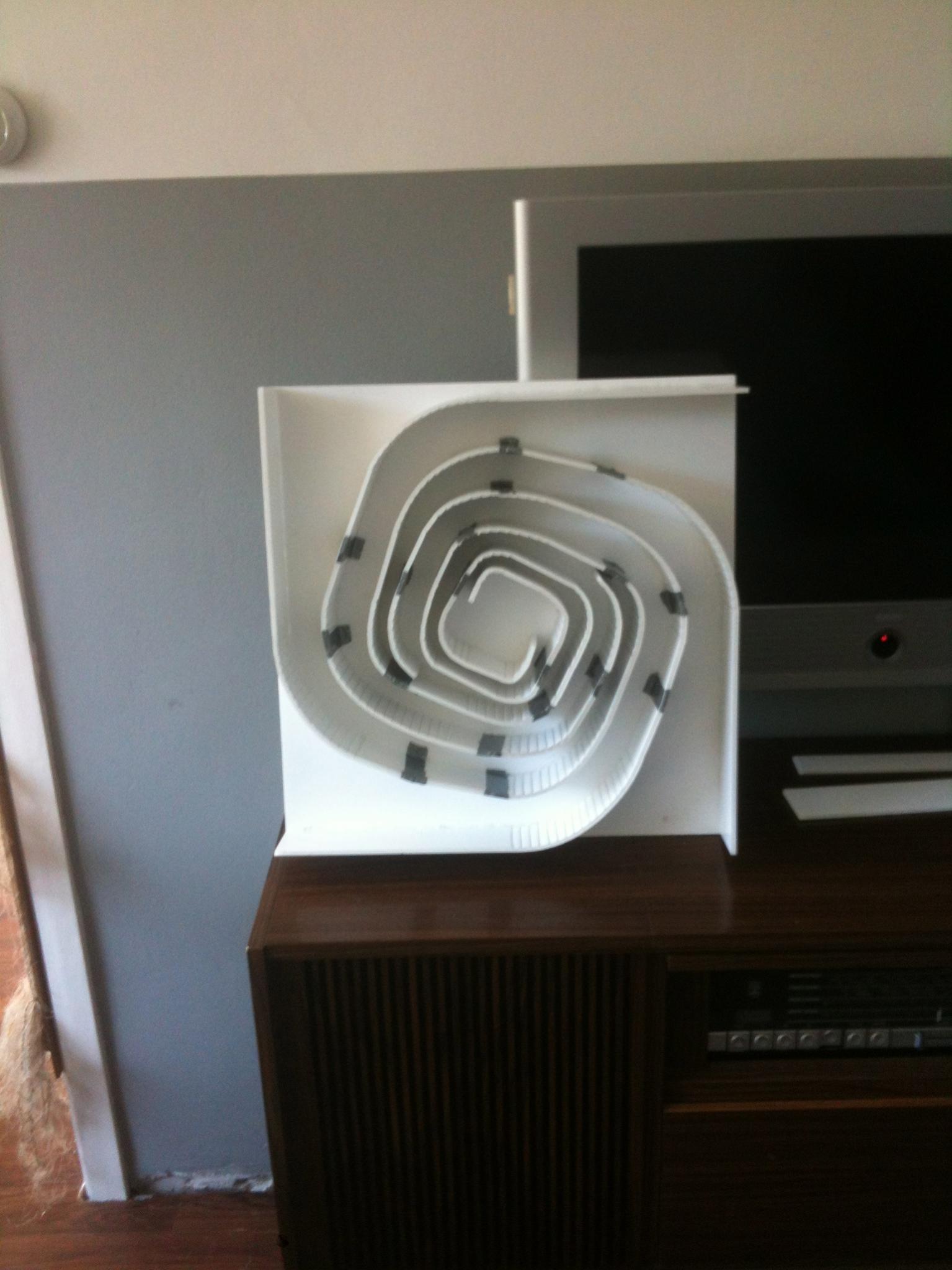

I've been really busy all this time, but finally got the cornus finished!!
Lacquering and finishing the wood was really a tough job but it was all worth it!!
I wanted to drop a line here to thank you all for your help and info, it's because of you that they ended up so well!!

Very nice job on the Cornu's there Fran. The white lacquer looks great and I really like how they turned out. Looks a bit similar to my all white foam core Cornu's - no need to lacquer 🙂
How did you make the curved wooden channels?

I made an autocad file from the spiral layout and CNC'd the middle plate. Then I inserted long strips of 4mm okume plywood which bent at some extent through the middle plate, and glued them to it. The remaining part of the spiral (the inner part) was left because okume did not bend that much, and I had to cut small strips of it and glue them together to finish the form of each spiral's arm.
Lacquering the wooden channels was hard, because it was not possible to polish the surface as fine as the front and black plates, which are totally flat. If you touch the front and back plates they feel completely smooth, but if you touch the horn mouths they feel a little more rough. Anyway, nobody is supposed to touch the inner part of the horns, and they look as good as the front plate, just feeling a little more rough to touch.
