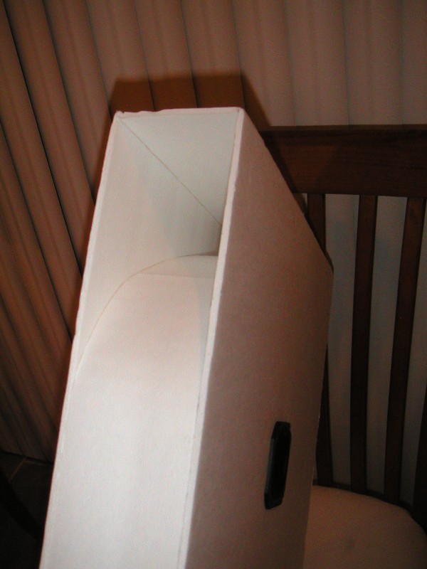

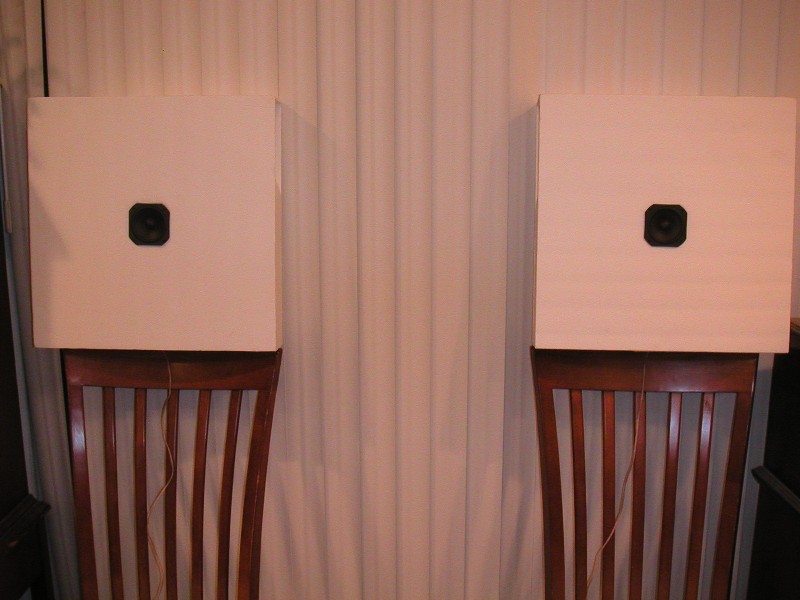

Here are a few pics, they are not too pretty because I built them for sound and not looks and to make them look worse they fell off my other set of speakers because of the bass they put out. By the way I didn't score the paper on the walls, I wet it on both sides where the bends were which let the glue relax then curved it, glued it and when it dries the glue bonds again. If it didn't bond perfectly I glued it back down with thinned white glue. The next set will be larger and have ply on the front and back.

Great news webber. Glad you are happy.
Next set? Make them the 27" with a bigger driver. You think those are good, wait till you hear big ones.

They look nice Webber, congrats!!
Thanks Fran, I wish I had your patience and skill to tastefully make what you did!

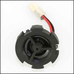

So something like this?
I finally have a scaled printout of the spirals, and am looking forward to making an attempt! I have a lot of cardboard that I could use to make a mock-up. Does this sound like a feasible material to try the design out with?
Don't waste your time with card board - go to the dollar store and get the foam core. It is straighter, glues better, and is stiffer. The piezo element you show I the active diaphragm - it needs housing as bare element will not have good efficiency.

Don't use a buzzer - use a piezo tweeter. They are cheap and have the proper housing geometry for high freq. you don't want to make it go through a small hole as that acts as a low pass filter. Even better is a small fabric dome tweeter. Those have great sound and spatial dispersion.
I understand. Yes, it seems that the piezo route is not the right one for this project.
