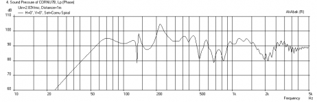

I've just purchase two 3" TB for my third project but, while waiting for the drives to arrive, I've started reading this thread and suddenly the project changed to a Cornu Spiral.
I would appreciate if someone could confirm if I've made the right choices and of materials and dimensions:
9mm ply wood
5mm foamboard
60cm box scaled from planet10 plan and about the height I'm lost...
I've read that the height should be the same as the driver diameter 3" aprox 7,6cm but also the throat area equal to the driver SD, if I scale the PDF to 60cm I get a throat width of 1,9 cm minus the 0,5 cm of foamboard 1,4cm so 32cm2/1,4CM/2=11,42cm this is a 50% increase, what I am doing wrong?
Here is the data for the driver:

TB W3-594SB in Cornu
Jorge,

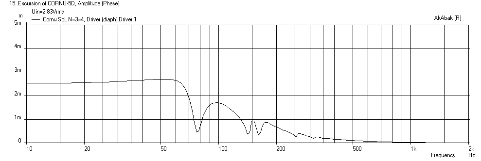

The whole trying to match Sd to the throat cross sectional area is all approximate anyway, you can be off by 2x and it is often just fine. In your case 1.4cm x 7.6cm x 2 = 21.3 cm and that is 65% of the driver Sd. A good value. I ran a simulation for the W3-594SB in Akabak (60 cm x 7.6cm deep) anyway so you can get a feel of how this will perform. It has good bass extension and sensitivity but you have to be careful about driving it hard as it exceeds xmax even at 1 watt. The xmax is only 0.4mm - I am sure that is not the physical damage limit but the limit for linear Bl operation.

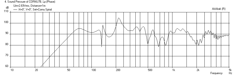

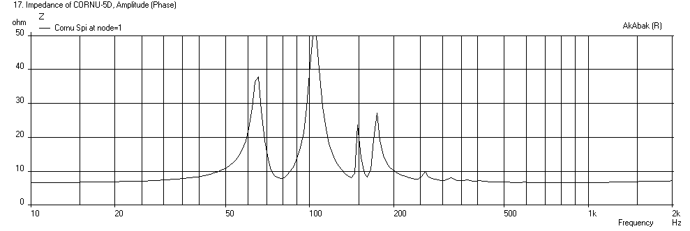

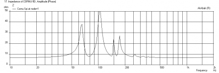

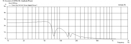

Here is the SPL, impedance, and cone excursion at 2.83v, 1 meter.

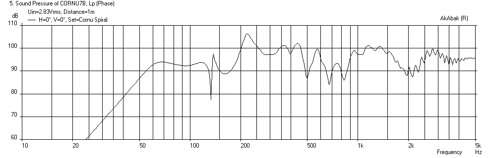

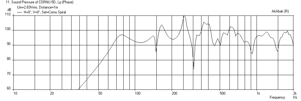

Both of these drivers will work pretty well in a 27.6 in x 4.5 in deep Cornu. Here are the sims for the FE126EN vs the W4-1879. The Tang Band seems like it will be more balanced as the high end on the Fostex is greater. The Fostex has very small xmax so you will probably get more satisfying bass from the Tang Band.
FE126EN
W4-1879
