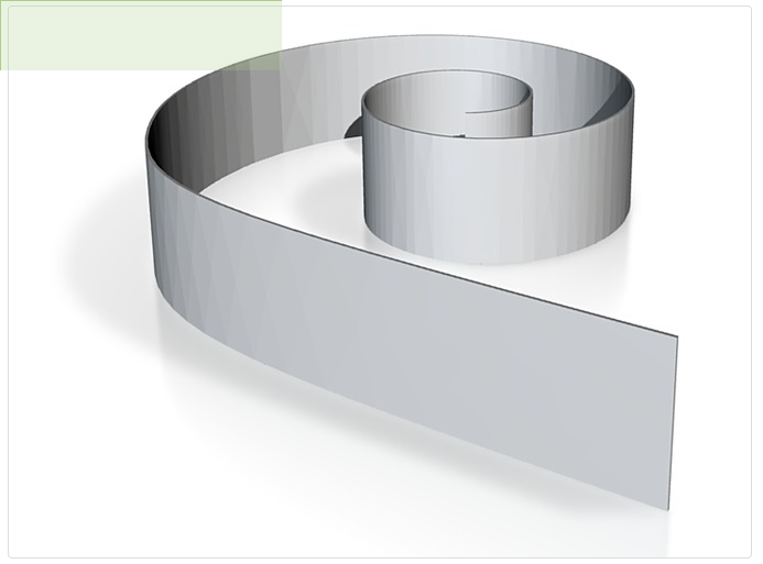

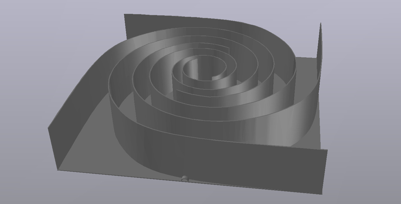

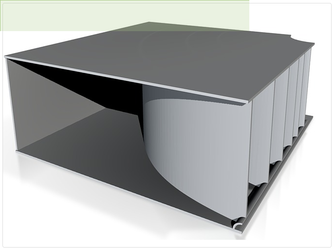

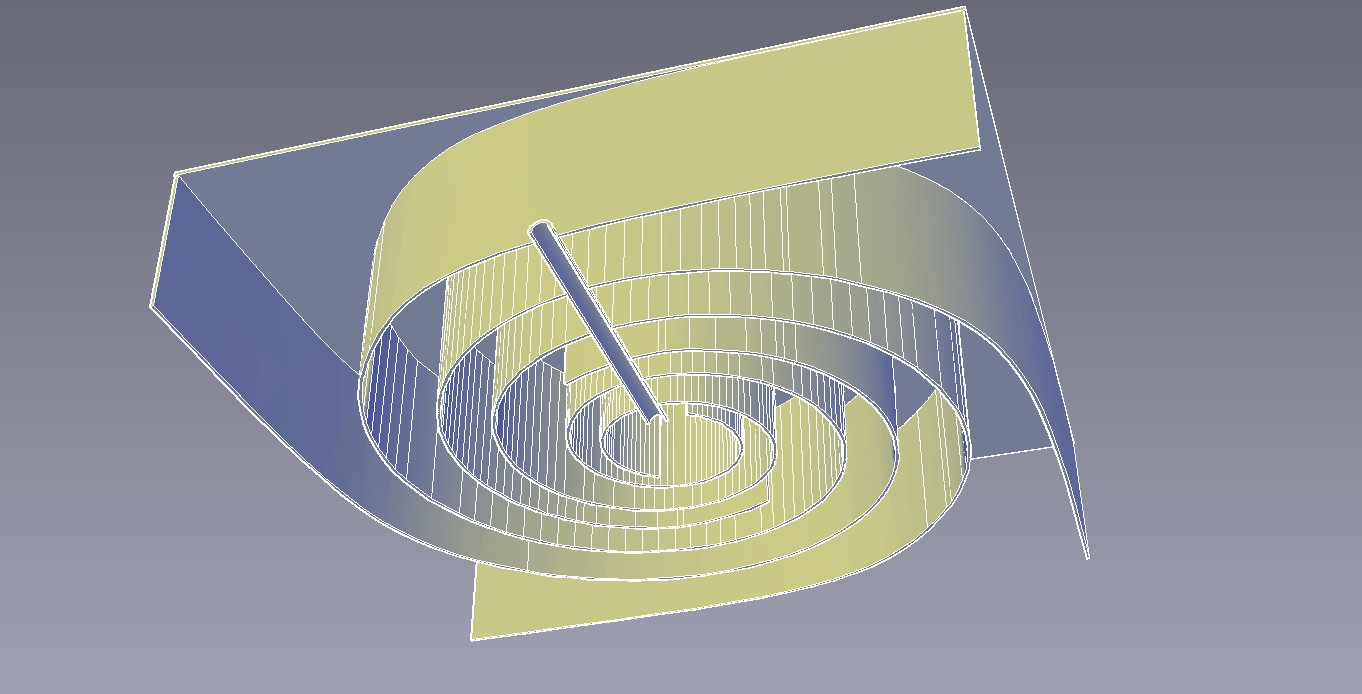

Ages and ages ago I modeled the ideal cornu speaker cabinets in cad with an idea for 3d printing as it offers rigidity, less than 1mm precision, perfect curves etc.
I'll talk you through the photo's.
Cornu 1 is the 508mm (20") variant as a complete full unit.
Cornu 2 is one of the two long "ribs" with a view to using your own front and back. (Of course I modeled the short rib too).
Cornu 3 is the only way the 27" version is small enough to print, split it into 4 sections, this shows one on the sections.
Cornu 4 is an underside unrendered shot showing a cable void.
Cornu 5 is an above rendered shot (the cable void is clearly visible)
Wall thickness is a couple of mm, rigid due to structural form and workable enough but delicate.
