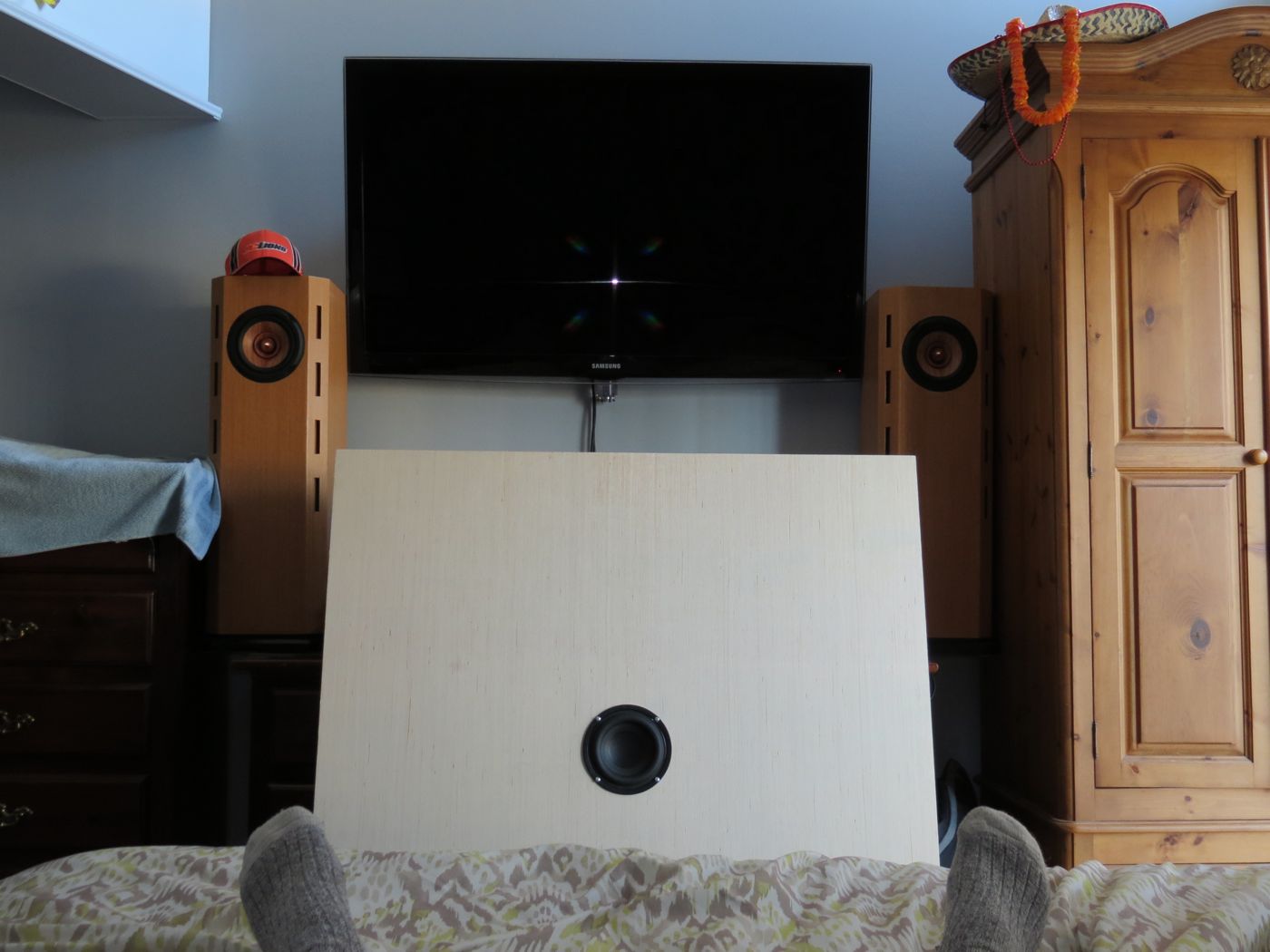

Cornu's biggest asset is to take an otherwise good FR and give it bass beyond it's regular means. Doing a Cornu with a woofer and it's own plate amp means there is much better control over things, but unfortunately, the ****s and giggles are all but gone. The drivers have sat in storage for a couple years and need time to stretch their legs. What I can say at this point is there is a room full of bass in the bedroom with no discernible cone movement. I will have more to say later.

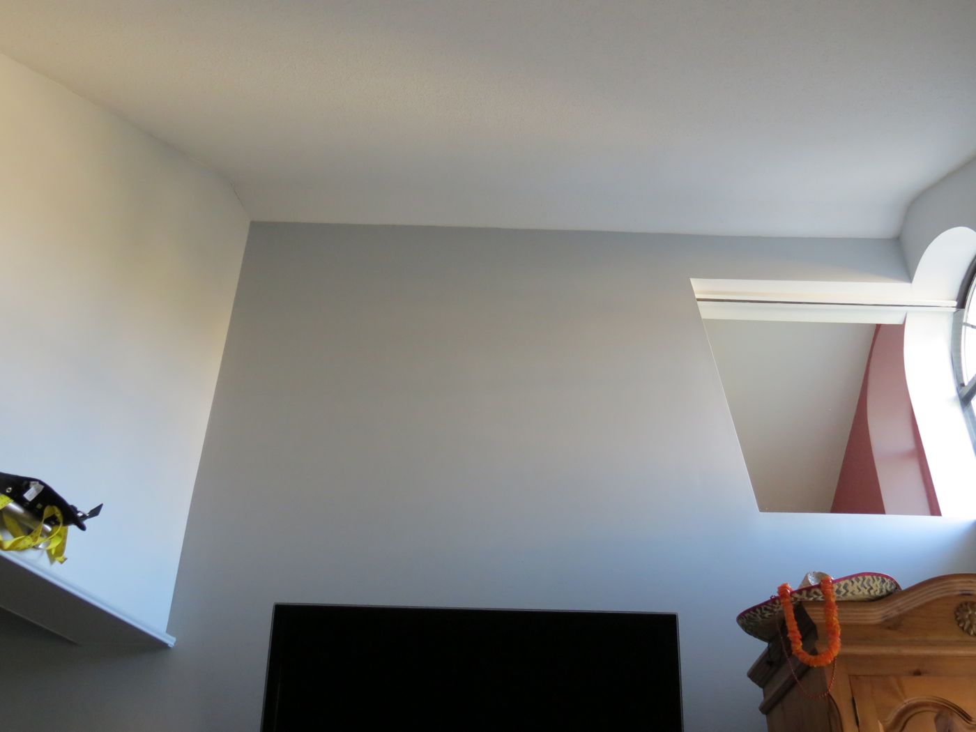

The second pic is an option for where they (or maybe just one) can go if it goes well.

Nice work Cal. It surprises me that foam core can be used to make such a large speaker. I suppose it is quite strong given you have 48 linear feet of it in there like basically a composite honeycomb panel.
What bass Hz are you feeling like it reaches? 30Hz easily?

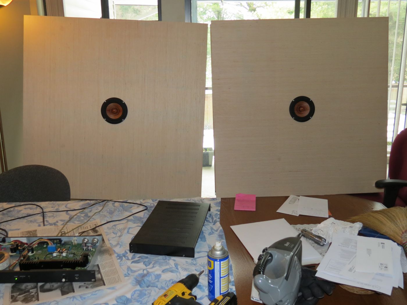

I wasn't coming back till I sorted this out. No matter what I did, there was just no love for these 48"ers. That TB driver is great and has served me well for years but just isn't meant for the Cornus. Trust me I tried but no go. So as I sat drowning in my speaker tears I had a revelation. You see those Airborne drivers either side of the TV?
With my fingers crossed, I mounted them in the Cornus, moved the boxes to the diningroom, grabbed a different amp and fired them up.
WTF? They sounded like crap. No highs, no lows, just a dull ceiling speaker sound. The phone rang so I turned the volume down quickly. Emphasis on the word quickly. I heard a scratching sound.
You know where this is going don't you?
Got out the anti-static spray, did the volume pot and fired it up again.
Wowza!
Once again, the magic has returned. I mean in a big way. This 48" size allows for the bass hump to be low enough that it is reinforcement not a bloated distraction. I am able to get a bit of chest thump. Something I've not experienced with a 6.5" driver.

Nice ending there, Cal. 🙂
The TB’s are subwoofer drivers. I thought you were making a subwoofer - so doesn’t surprise me that they sound bad as a full range?
Those Airbornes are the wooden membrane right? Nice drivers - and seems like a match made in heaven for the fine Cornu’s.
Well done, and a good save there. But what will you do with those nice (Chrisb made?) Aironkens?
Thanks Dave, we can talk about them later. They're a tricky driver to get right I know but this seems to be quite a good match.Cal,
