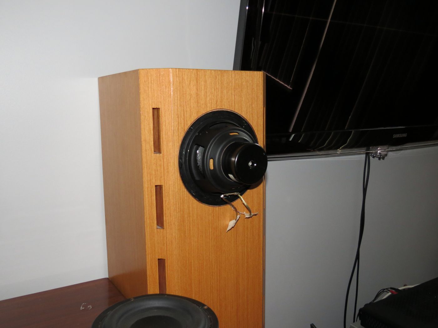

Hi Cal,
When I gave you the design, I recall it needed a really small depth - smaller than the drivers magnet so a bump out would have been required. What depth did you end up making the because I don’t see the bump out. I do recall warning you that there would be a large bass overshoot at the knee if you did not make it thin. The one note sound you describe is consistent with an exaggerated bass peak.
From post 2400:
From post 2400:
That W6-1139 has a powerful magnet, make the 48in Cornu only 4in deep. You need to make a bump out to allow the magnet to clear the back panel. Otherwise it has a huge bass spike overshoot at 35Hz.
The internal dimension is 4.875"
Appreciate all the help guys but there's no need to go backward at this point.
A bass spike at 35 Hz would have been welcome.
This was not the case.
Th TB driver was simply not meant to make sweet bass in this cab.
The Airborne's are a treat to listen to.

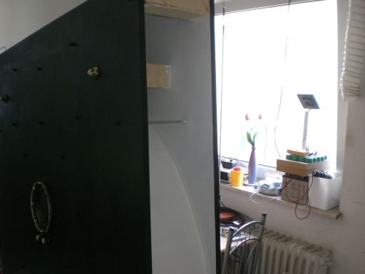

So, almost 200 kilos bass horn balanced through the booth ... It was easier than expected - you just have to lay out the floor with the remains of kitchen worktops and pull the monster over it ...: idea2:
With rollers of all kinds you have no chance here in the old building. They dig into the impact sound insulation like a truck in the mud.
At least the little monster is already there, where it should go. It comes about 40 cm higher and 30 cm to the left. In addition, there must be a bucket of paint, this is just the first primer. When it finally hangs on the wall, probably from mid-April to early May, the place will be renovated.
Of course it is not connected yet - the electronics are not finished yet. I will temporarily connect it to the Fostexe with fat inductors at the weekend. Just for fun...
(by the way, the tweeters on the BLH are not connected)
If you look at the picture below, it does not look sooooo huge. I could have built even bigger ...
LG D.W.
LG D.W.

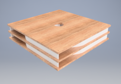

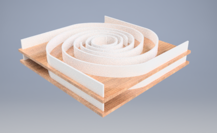

Wadup peeps!
First post here on this seemingly fine forum of yours.
I've been wanting to build a pair of Cornu spiral horns for almost a decade now, but with so many other projects in between it never got beyond 'someday'. Well, 'someday' finally turned into today, and lo and behold this thread has exploded in the last couple of years.
I used the PDF I found here (I think, it was a long time ago) to trace the cutouts in the sheets.
Now, I'm no audio expert by a long shot, but do these spirals seem OK? They seem to open up before closing back in just before the exit.
I'd like to make sure before I waste a sheet of plywood.
Thanks in advance!

Where did you get the pattern for the spiral? That's nonstandard and if it were me, I would stick with the standard shape. Look at the first two posts in this thread.
I had to dig a little since it's been a while, but post #30 had the pattern I downloaded and used for some reason.
I'm using a CNC to build these, so I thought I'd go for a smooth spiral shape. However I see the 'standard' angular spiral would be doable too.
Thanks for the info!
We believe the rounded square pattern was purpose designed to reduce the higher frequencies exiting the horn.
