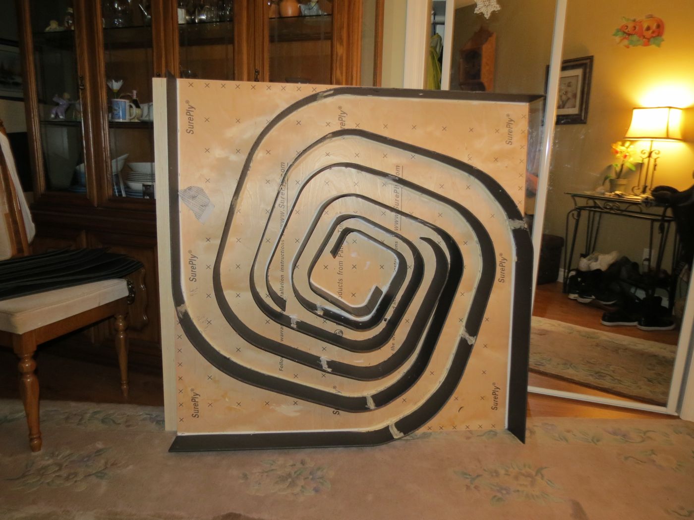

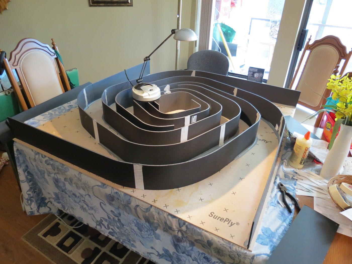

Here's the 20's, 27's, and 36's along with a drunken concoction I call the Penthorns

Thanks for addressing all my questions Cal. And for the pics. Mmmm. Pictures. I get the speakerholic bug from time to time. Luckily don't have it at present. Too cold to think or feel anything this winter :0 In fact I've had the parts for dual TC9 0.53X Karlsonators sitting here for months. Finally a coupla weeks ago I cut out all the foamcore pieces. Now at least they're in a neat stack. But of course I have a few glorious foamy boxes to listen to already, so no rush. When the fever hits again I may take on a 27 or 36 Cornu. I can imagine that the sound out of those things is somewhat beefy. Thanks for the inspiration.
I wish strokes of genius would interrupt my thought process more often. While I'm lying in bed this morning, trying not to disturb the Mrs., it hit me. If you want to lay 46 ft. of glue on the edge of the foam before it skins over, you either need four people with a bottle of glue or you do something like this. It's just a paperclip taped to the nozzle. Hockey tape of course. 🙂
