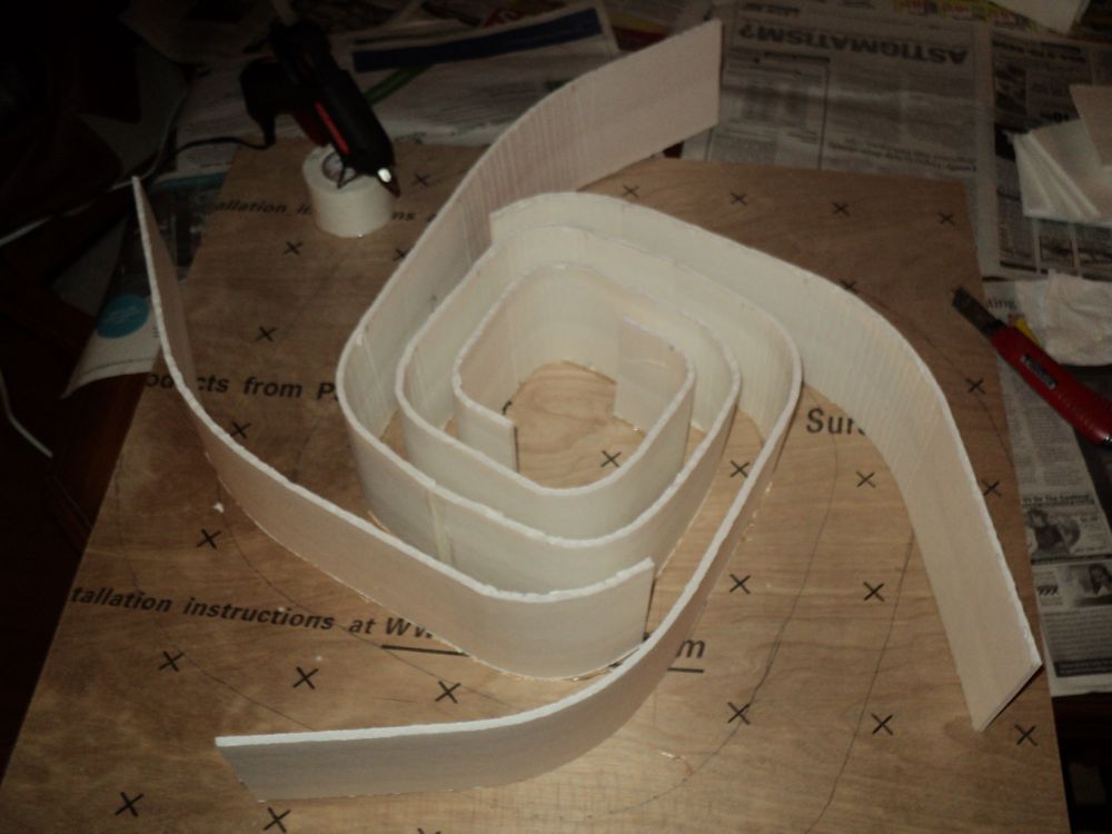

Secondly, when constructing the spirals, you may find it easier to start each horn as you go around rather than one horn vein at a time. (see photo) I found it was much easier that way. Other than that, nice to see the work you are putting into these.

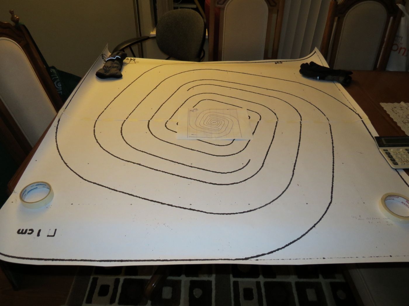

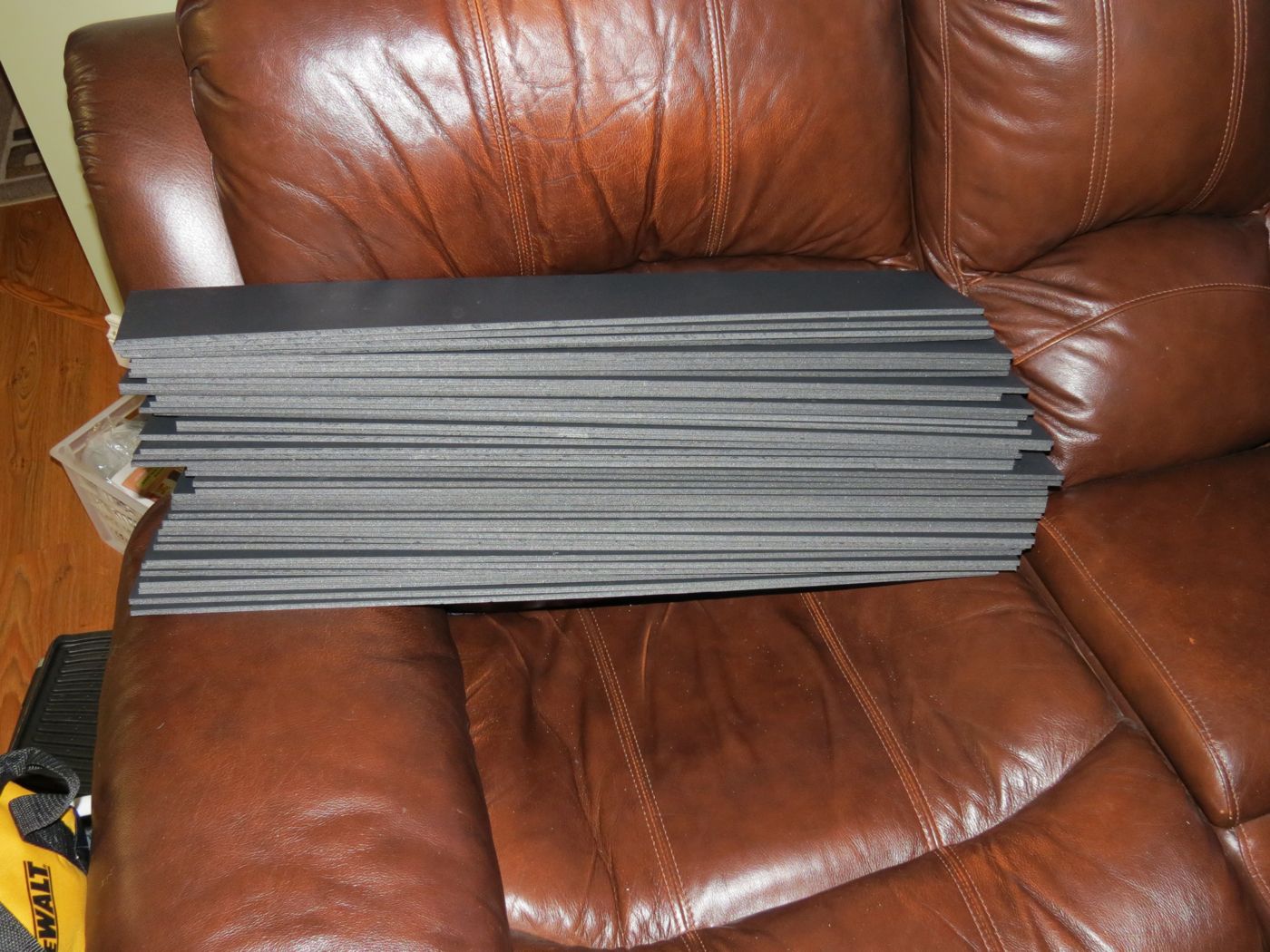

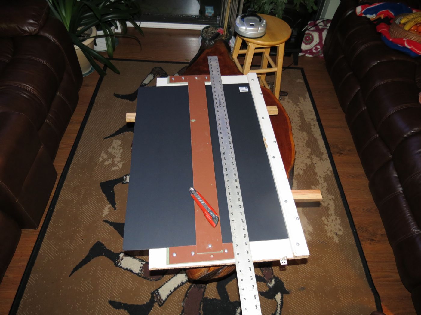

I went looking for a 36" slide cutter to make things nice and square on the foam. Found one - only $949.00.
Went home and decided to bang together a jig. Took a while to cut the foam but the result was worth it. It's as clean if not better than the factory edge.
All 92' of the horn veins are ready and the pattern is taped together. Holy bejeezuz that's a big speaker. The pattern in the center is your standard 8x11 sheet.
I'll get the wood on the next non-rainy day.

Layout complete, and have started forming the foam. Probably nothing today as I will be spending the next 6 or 7 hours in a boomlift and probably won't feel like standing when I get home.
