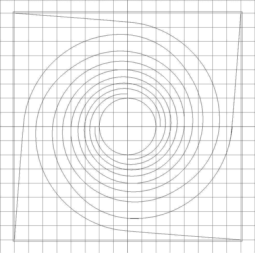

Inspired by your dipole coffee table idea, I am back to the idea of my smallish potable Cornu based music system. I was never able to get my head around the calculation software, but you seem to have one set up for cornus. Are you able to sim this design? Of course I can go bigger than 16x16, but this decreases the portability.
So, in essence, this post is to find out what is the smallest dipole Cornu which will play below ~70hz
The plates are 16"x16", and the two drivers (aucharm 4") take up ~4" so the volume of the "cube" is 16 x 16 x 4.
The mid-line of one "horn" is 55" long.
The grid on this plan is 1"
If this takes too much time, I will understand.
Colin

I can simplify this as a linear expansion for the inner section until it gets to the mouth area where it is closer to exponential. can you tell me the travel path from the throat driver chamber to where the expansion goes exponential and what the CSA is at start and at end? Then what is the length of the exponential and I will assume mouth ends at same as edge dimension.
70hz is tough - you need 1.22 meters path to do that. Is it that long?
And I think you meant bipole - that is what I am doing to reduce baffle step loss.
I don't know the difference between dipole and bipole. Is this the polarity of each driver?
one 'horn' in this design is 55" - 1.397M

At the inner most part of one horn, the CSA is 0.5" x 4'. At the end is is 8' x 4". the distance between these points is 55" or 1.397 M.
The "exponential"-ness of this design is not purely scientific. It is an approximation to keep the build practical and the spacing of the waveguides semi - even. Looking at the plan I sent, does it look close enough to exponential? Toward the end, aesthetic concerns took over a bit so it would look even and still be "exponential". The original "exponential" curves did not look even or horn-like, but this could be my bias.
Thanks Cal, I think I am planning Bipole - two drivers for sure and the phase will be whatever is better.

Ok, let me take a hard look at the sim right now.
x
That W6-1139 has a powerful magnet, make the 48in Cornu only 4in deep. You need to make a bump out to allow the magnet to clear the back panel. Otherwise it has a huge bass spike overshoot at 35Hz.
x
