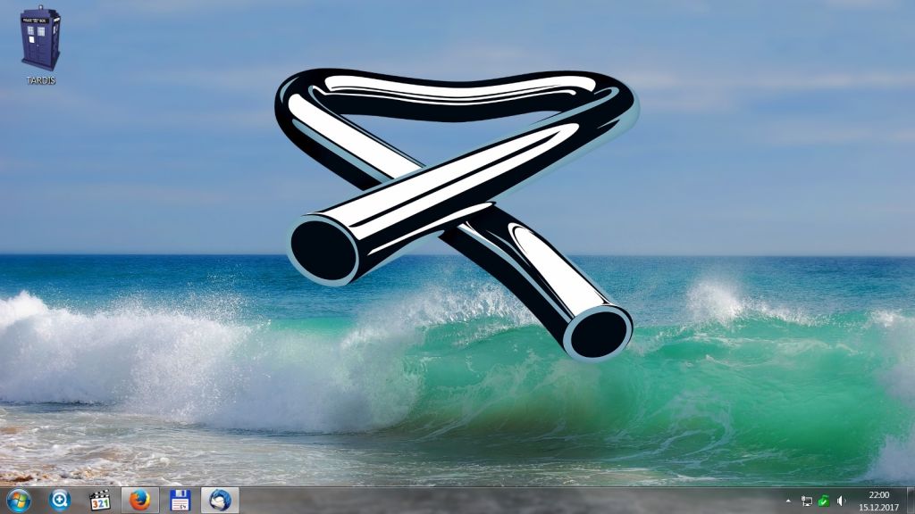

Yes, still a huge fan after all these years. Love your desktop.Oldfield-Fan ?
I admire your ambitious cornu build. Keep us posted.
Hi guys,
@twocents: thx, i'm a huge Fan since "Incantations".

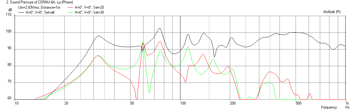

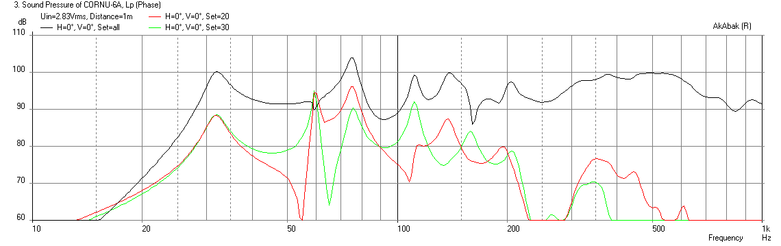

Doctor Why,
I ran the simulation of the Cornu with a single Kappa pro 10LF and dual in isobaric configuration.
Here is single driver:
Here is dual driver in isobaric configuration:
As I suspected, there is no advantage of using isobaric in this configuration. You would get some benefit if you mounbted both drivers one on each side facing out and mounted this away from walls. It could be configured like an OB or as a bipole (no baffle step loss).

@xrk871:
Thank you for the Akabak calculations. The frequency responses confirm my guess and the results of Hornresp (27 Hz fu and boost at 33 Hz). So the frequency response is not as bad as it looks on paper. I already planned a 30 hertz bass boost in advance - I can save it now.
The subsonic filter I will initially set to 25 hertz and below with 30dB / oct high pass filters.
Also the area around my planned crossover frequency around 50 to 60 Hertz (Linkwitz-Riley 4th order) looks good, because my DIY-Backloaded horns with modified Fostex FE206en have a lower limit frequency of 45 Hertz. So that fits well, even from the sound pressure. A different mounting than on the wall is unfortunately not possible.
