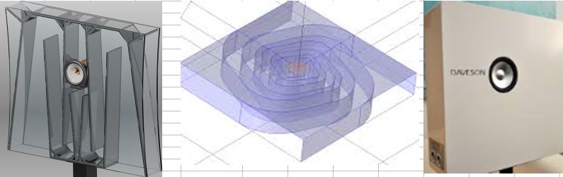

Which type of wall mounted design is the best?
Besides a small Tapered T-Line, I'm getting ready to build, I want to figure out which is the best wall mounted design for my next build.
First, I would like an expert in either T-Lines or Horns to tell me:
1. Why would you build a dual line horn (first picture) or a quad line (2nd picture = Cornu) vs a one line horn? And if a dual or quad is better, would it also be better to build a dual or quad Transmission line?
2. Assuming you have enough amp power and in a smaller room, would a a mass loaded tapered transmission line vs a Cornu enclosure have more articulate bass? I placed the third picture there to simulate a T-Line (although, since the speaker is in the middle vs offset (T-line would probably have it 1/3 of the way down the line) it probably is a cornu.
3. I want to build one with a battery powered Bluetooth amp build in, covered with a piece of cloth art.
4. What is the recommendation - T-Line or Cornu?

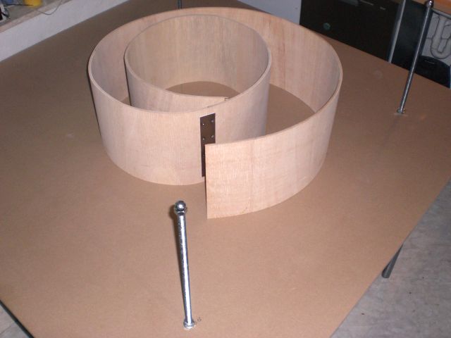

There is a nice plan in PDF by Planet10 somewhere early in the thread. You will need to read the thread to understand the build techniques of using foamcore and hotmelt glue. The plans are for a full scale size one which is about 27in. That fits a 4in driver and I have had pretty good success scaling that for larger/smaller drivers.

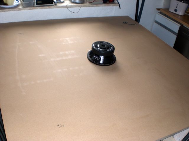

Hi Guys !
Sorry for my massive Delay - had some Health Problems...
My cornu Horn is now in Progress. I hope i'll be ready before X-Mas for first Tests.
Some Details:
Size. 1.80 Meter x 1.80 Meter MDF Plates with 2.5 cm Thickness
Horn Length 2x 4.80 Meter and 2x 5.40 Meter with 30 cm Height
Motor(s): 2x EMINENCE Kappa Pro 10 LF in Push-Pull (Compound) Assembly
Greetings
D.W.
Picture of the Plates with one Motor for Size Comp and one Horn Duct (4.8m):
