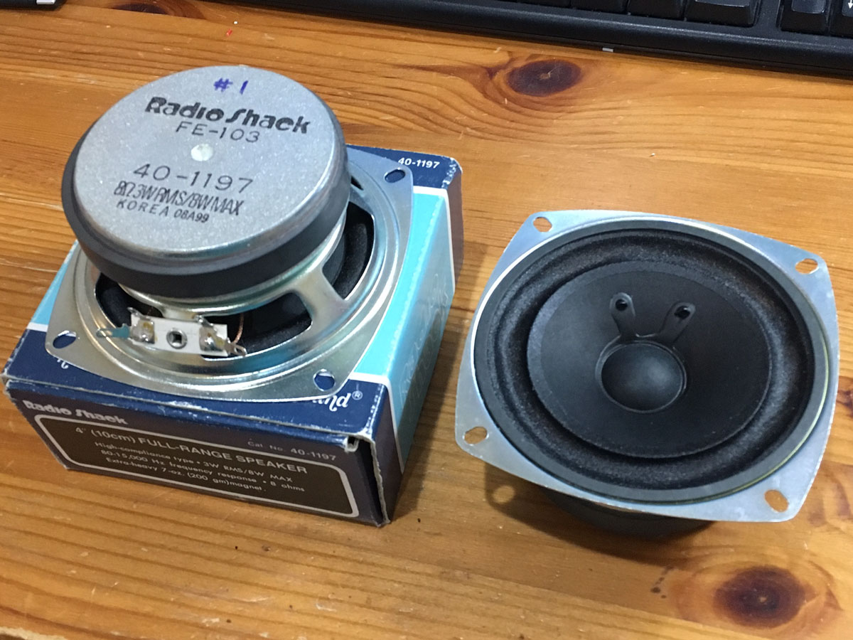

The biggest ones I have made were 22in. Maybe it's time for a full size 28in or 30in one. I have some RS 40-1197's (FE103) that need a home.
27" should be great for those X. How old are the 1197's? Ferrite or Alnico?
I think these are ferrite, circa 1999 based on the stamped label on the back. They were new in box units that I got as a gift from Godzilla. 🙂

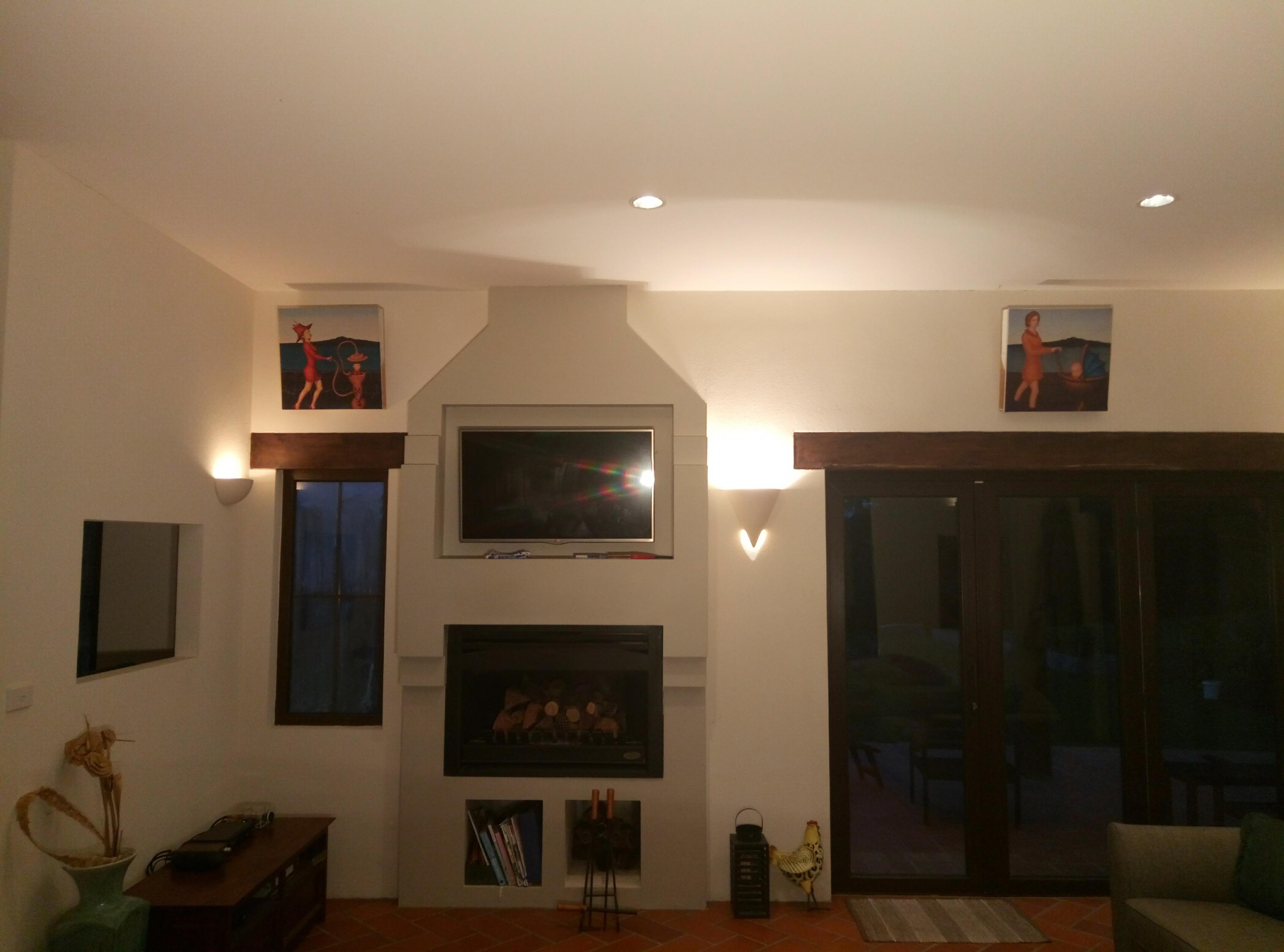

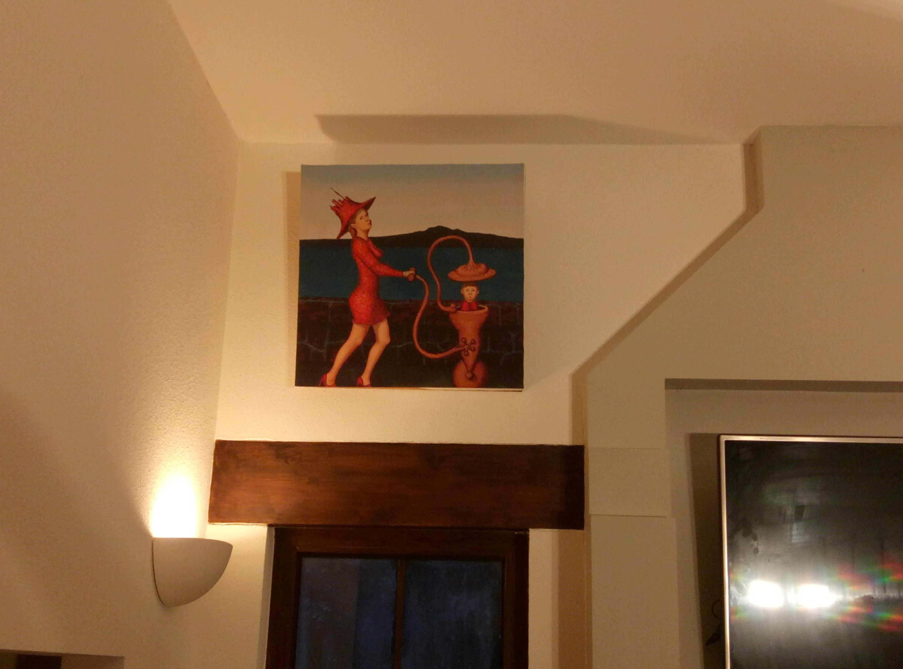

I want to make them as artful and 'stealth' as possible and have decided to put a piece of thin MDF in front of them covered with digitally printed loudspeaker cloth. (see pic). This cover is the same size as the speakers (500mm x 500mm).
I now want to make some other front covers for them but make these about an inch wider on all sides so the speaker becomes even less visible than before and you really have to look at them side-on to realize that they are speakers and not paintings/art prints. Do you think that making the front cover wider will impact on the sound quality?

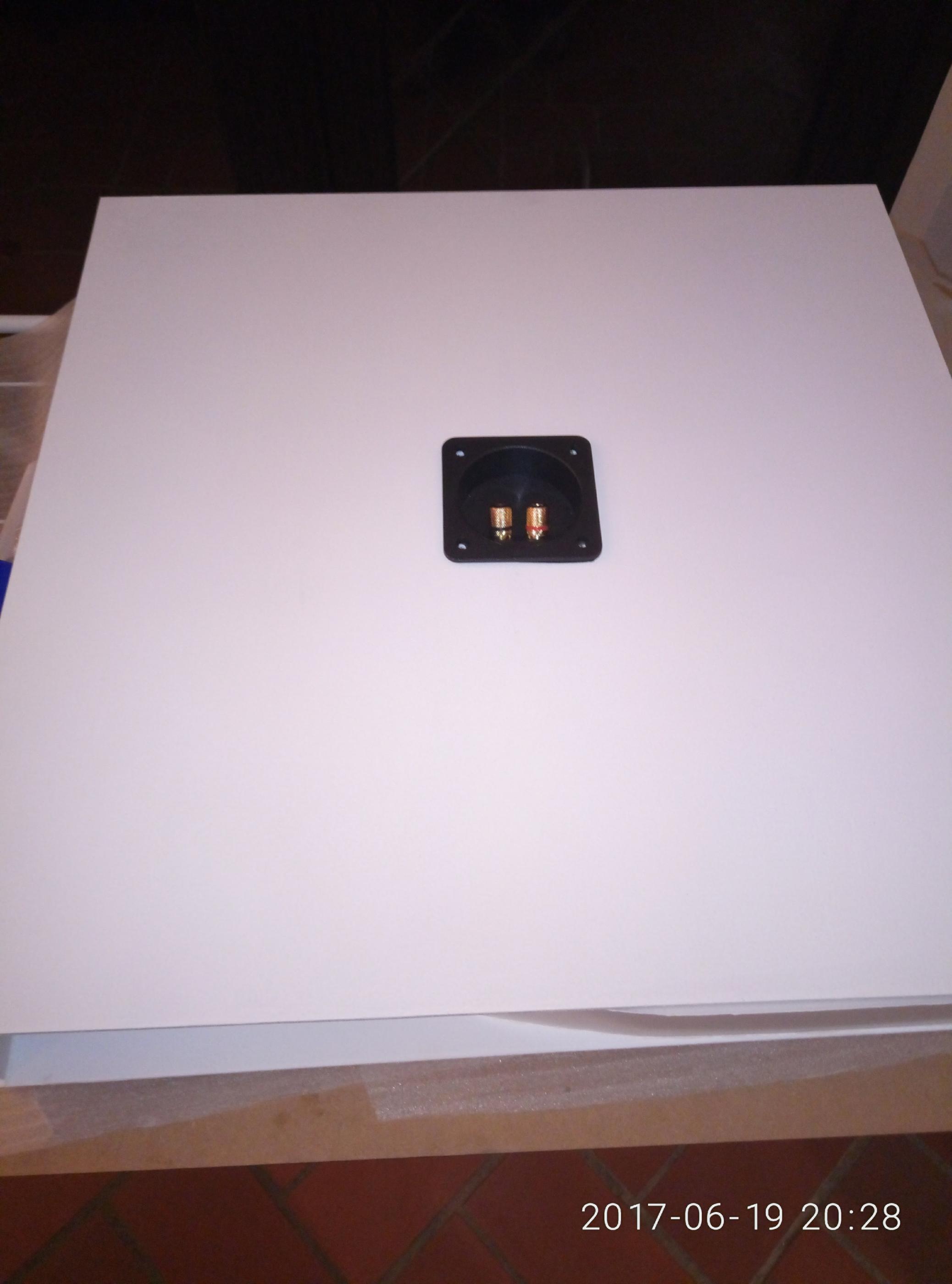

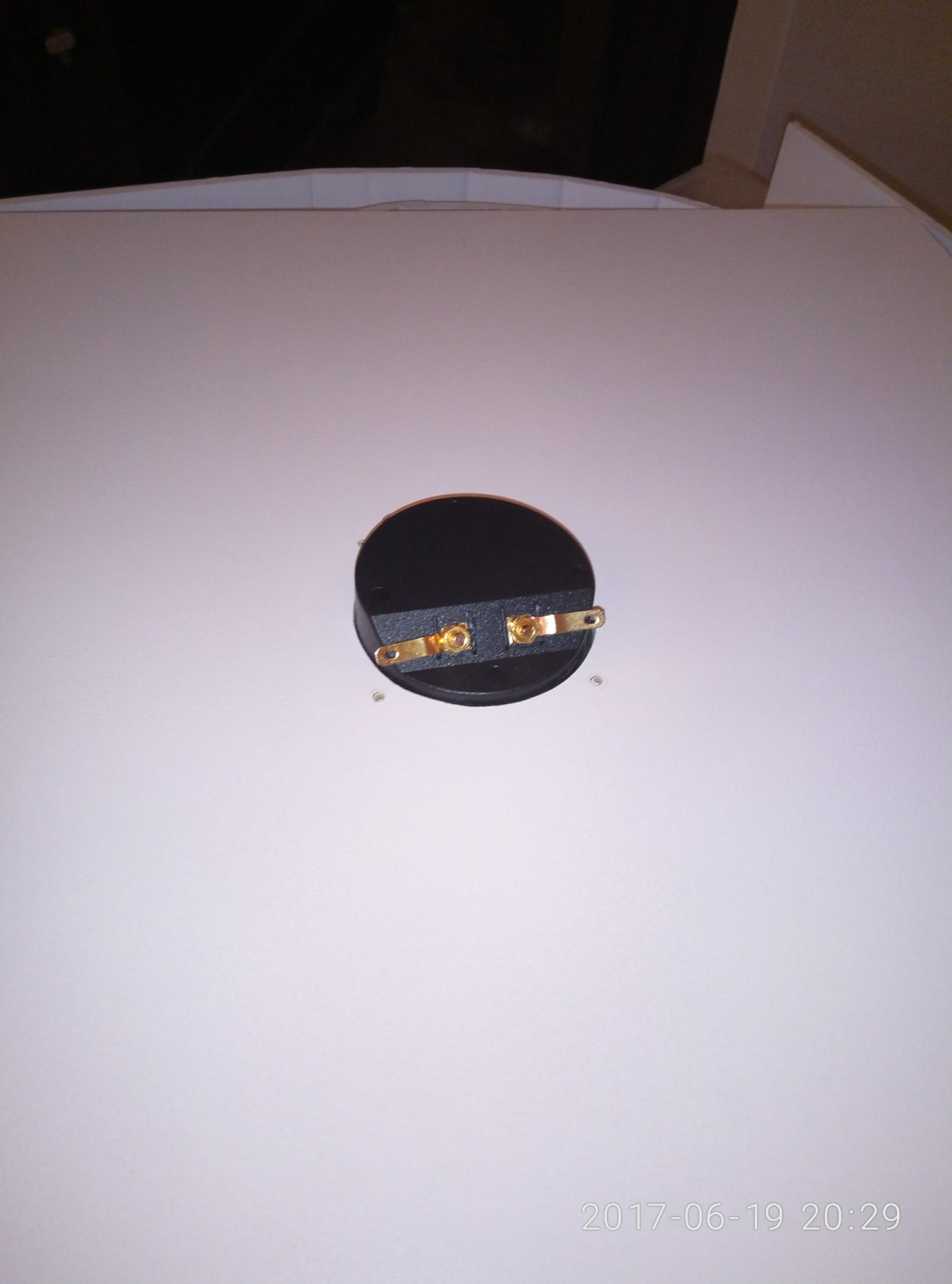

Second question: to get them up against the wall as closely as possible (and still have a pro finished look) I want to fit my next set with some cup shape speaker terminals (as per pics). They will protrude about 15 mm into the driver cavity and there will be a gap of 10 mm between them and the back of the VIFA driver (which protrudes about 35mm into the cavity). Any impact on sound? and if so, what can I do about it to remedy it?
I think the extension of the baffle will make them sound better as you're really just extending the length of the horns. As far as the terminal goes, what percentage of the driver chamber are you using up? If it 10% or less, can't see that as a problem. Also consider than the best terminal is no terminal so if you can live with it as is...
I agree with Cal, but if the cup is not taking up significant room, should not be a problem. Maybe glue a piece of felt padding to cover the hard plastic cup to reduce the back reflection. Looks very nice. You could even put a wooden painting frame around it and no one will know it is a speaker.
Is this the actual speaker?
Not meaning to talk out of line here but if you look at his second pic, you can see that those are indeed the speakers. I like the idea of using the picture frame, I have though about it myself. I liked the moulding on the 27" units I built but I think a picture frame would set it off that much nicer.Is this the actual speaker?
