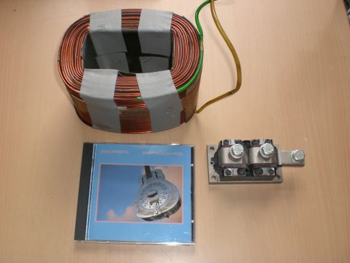

20mH 0.56ohms steel plates core is not so big.
ERSE Super Q 20mH 16 AWG 500W Inductor Crossover Coil
This is the low pass used in Manzanita speaker.
