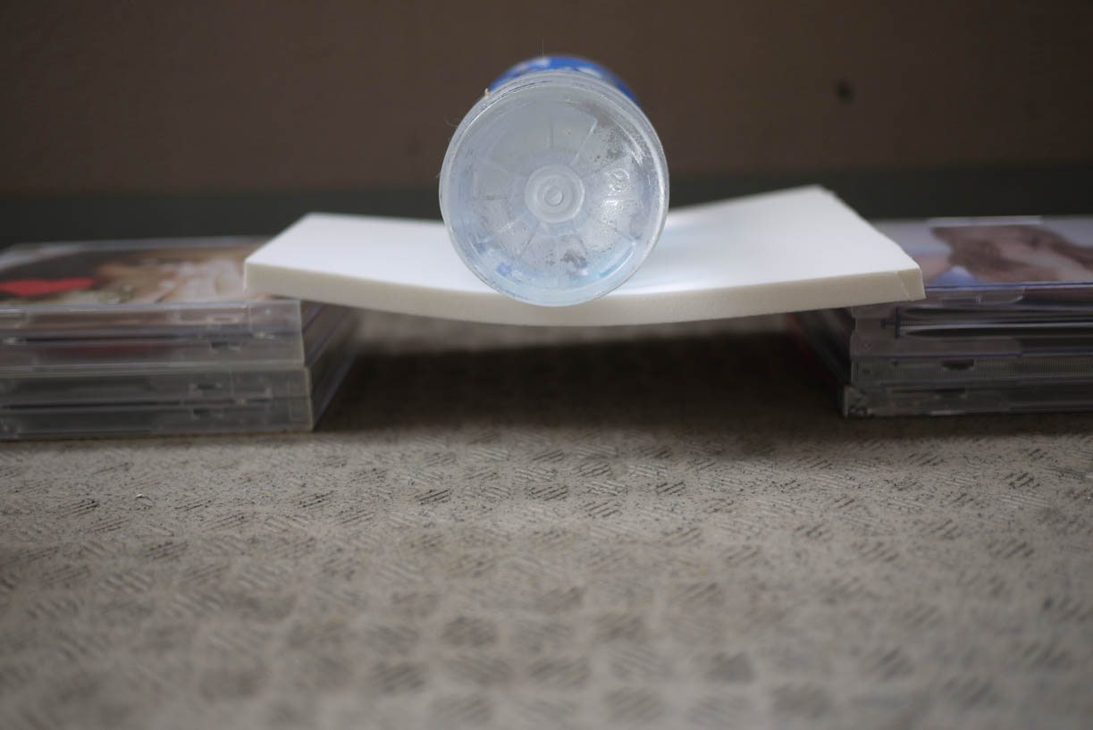

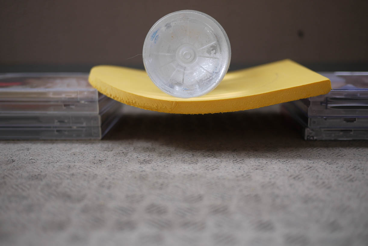

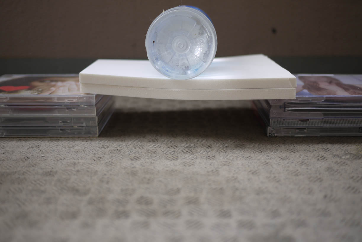

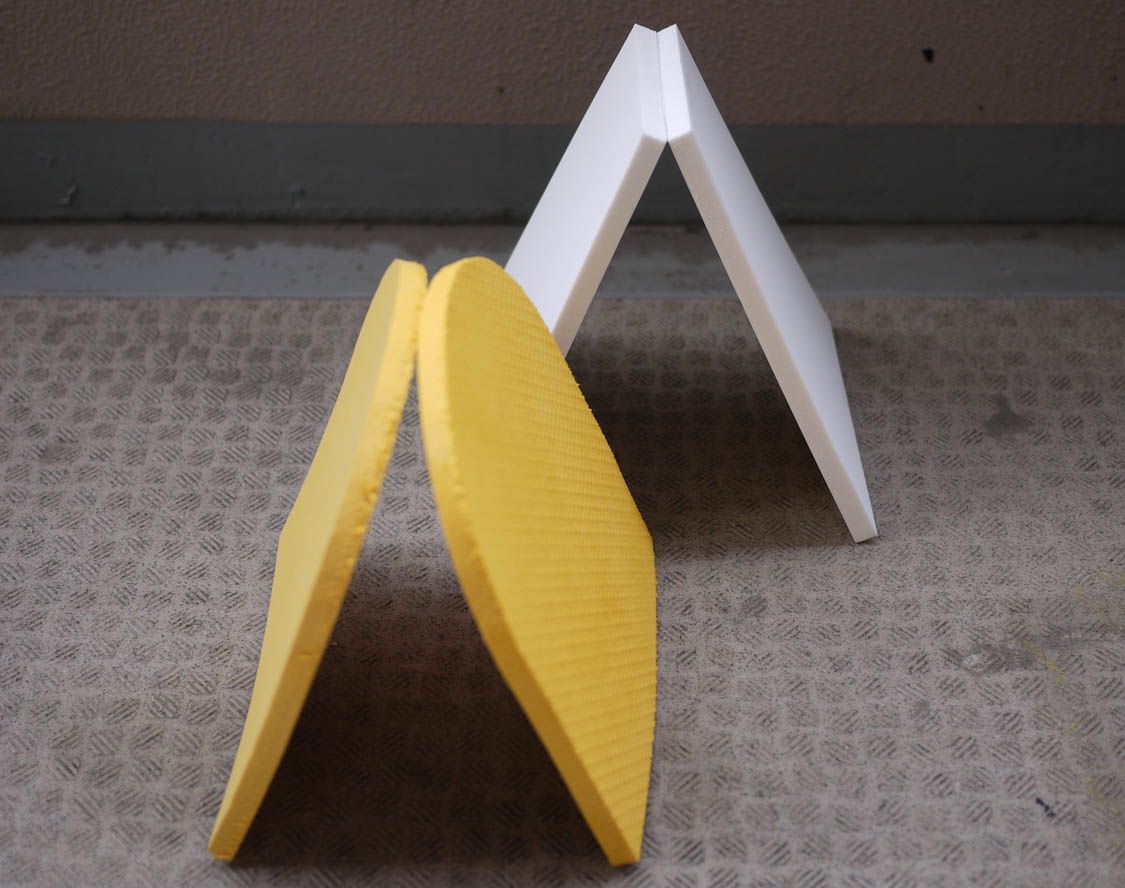

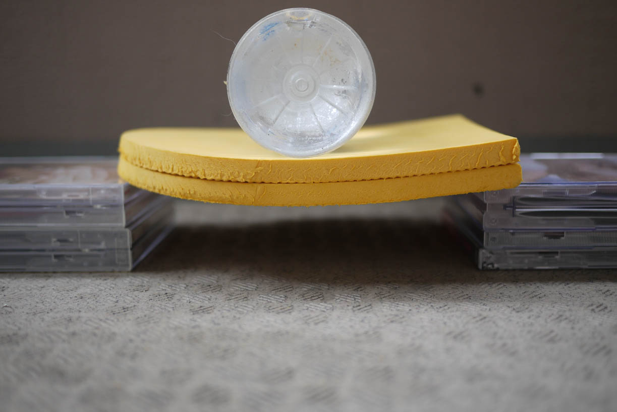

BYRTT, the more I look at the picture of the EVA mat, it actually looks to be semi rigid and maybe slightly more dense than a yoga mat. It is being held into the roll very tightly by some serious straps, which leads me to believe it might unroll by itself. It might actually work ok if you laminate it to 16mm. For 8euro I would personally buy it and try using it. Even if it doesn't work, it is not a lot of wasted money. But then again I am happy to experiment with different materials
OK here are some photos to show the semi-rigid nature of the EVA that I am working with. The white is the koyo-softboard EVA. The orange is a cheap EVA floor tile. The koyo softboard is 10mm and the orange EVA is 12mm. The orange is lower density, more flexible and less rigid.

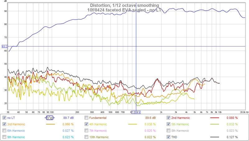

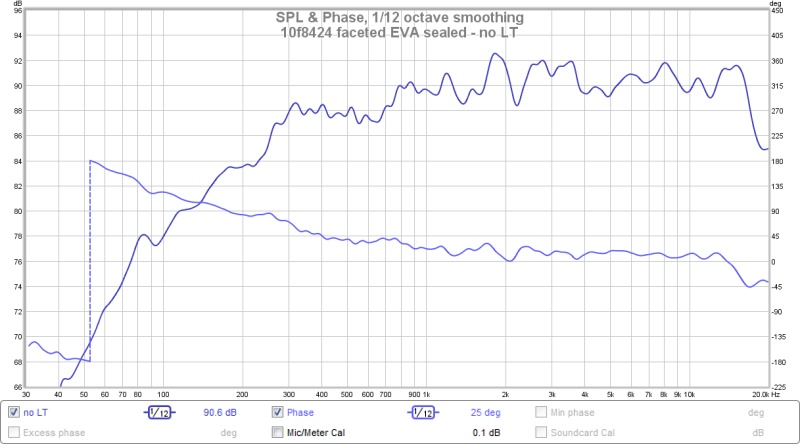

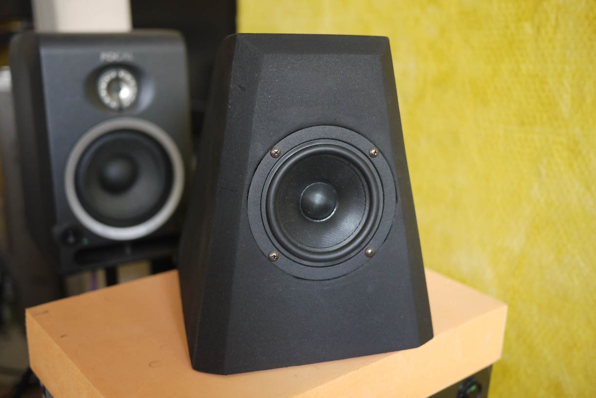

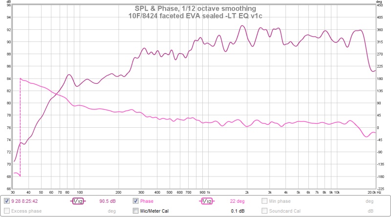

I finished the black painted faceted sealed box for my 10f/8424.They are looking really good and I am very happy with them!
The faceted baffle fixed a baffle-step problem with the original, and it seems to give a very smooth response. With this geometry box (1.6L no parallel walls, truncated pyramid with rounded top) and faceted baffle, I get an excellent one-driver speaker that approaches the LS3/5a small monitors. This was my target : one-driver small monitor, sealed box, LT, 80-20khz response, clean low distortion.

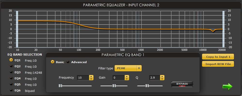

For this I apply a linkwitz transform to lift the bass and a single EQ peak at 14300hz to tame the high end a little. But this second EQ is right on the edge of my hearing range so maybe not critical, but it does seem to help and makes it easier to listen to the speaker for longer sessions. The 10f/8424 has such low distortion and excellent driver control that it responds very well to LT without causing distortion problems.
Measurements are at 20cm and calibrated response shown in graphs is accurate. very very happy.

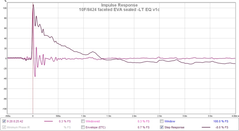

and without the linkwitz transform to show the low distortion. I may play with the LT in the future to see if I can get a better balance of extension to 80hz and low distortion.

That's a beautiful looking and great performing speaker you made there. The measurements all look fantastic. Must sound wonderful.
Thanks sharing jeshi, agree what X said also the version without LT if placed upon your Satori woofer could probably make nice extended bandwidth sound result.
Nice work! Both appearance and measurements look very good. Have you had a chance to listen at length?
Well I only have the one speaker built at this time, so I don't have proper impressions of stereo yet (imaging, 3d depth). But I have listened in mono for a fair amount and did a little listening with my Focal CMS40 doing the left and the 10f/8424 doing the right. At this point I can just say that they sound good enough that I definitely want to build a pair.
I also was working on some vocal composing (vocaloid) on a pop style track last week and used the 10f/8424 for a couple hours and it immediately felt normal. I could easily hear enough details to make fine adjustments to the vocals, and I was able to work with them for a few hours without any fatigue. I checked the result on my Focals and stax afterwards and it sounded good. With female vocals, the range of this 10f was more than enough to give a perfect impression/window on the sound (no need for more bass weight below 80hz).
So overall they are looking very promising. Give me a little more time before I pass final judgement (like are they better at X than my other speakers, or do I prefer them for Y, or good but I prefer using Z....). So far I would say they are competent monitors that work excellently in the midrange (female vocals, acoustic guitars, piano melodies). I am also fairly certain that I prefer them over the (eqed) FF105wk in the same box. But still want to spend more time with them all (10f, FF105wk, SB65).

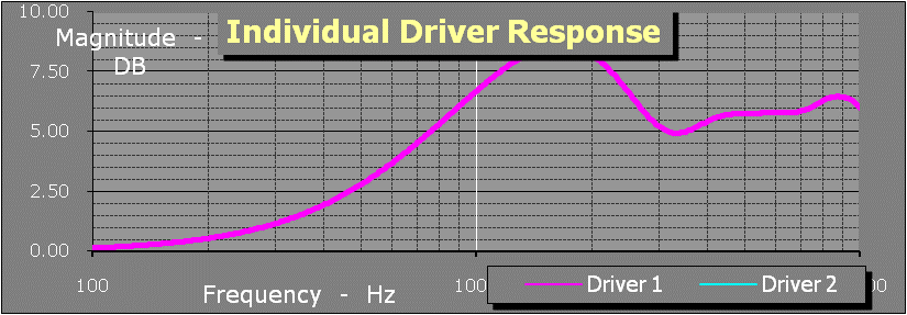

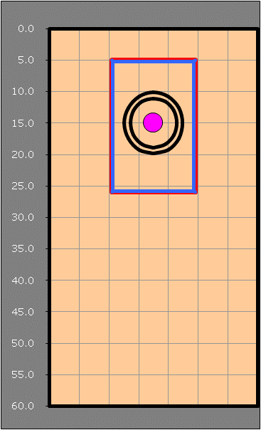

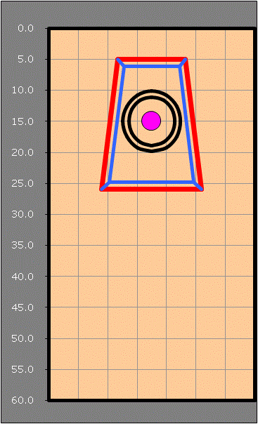

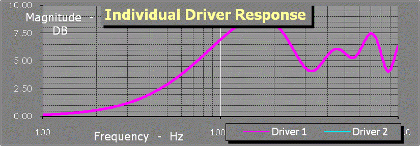

In case anyone is curious. I use this program to simulate baffle diffraction and why I ended up with the trapezoid shape that I did for these small truncated pyramids
Baffle Diffraction Simulator
The front baffle on these is 210mm tall, 170mm at the bottom, 100mm at the top, with the driver centered at 100mm up from the bottom.
Here is this trapezoid design with the 10f/8424 and resulting diffraction simulation. Here I use a 12mm facet chamfer which is very close to the final. The only difference is that I did not cut a facet on the bottom of the baffle.
And here is what a 210mm x 140mm rectangular baffle with 2mm of rounded over edge would look like.
One thing I learned from this simulator is that there will always be a baffle step and diffraction, so the best we can do is minimize it and control it. This facet and trapezoid shape is about the best I ever simulated.

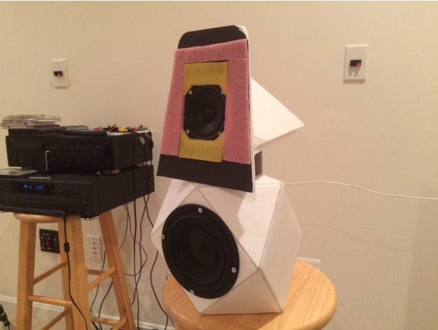

Well those turned out very well. 😀 First thing I noticed was the exceptional lack of baffle diffraction wiggles, especially on a relatively small baffle. Chamfered trapezoids rock. 😉 I suspect that the relative roughness of the EVA may be helpful too. Even though it's closed cell foam, it's got to be a better surface than the usual glossy finished wood.
Personally I like the unpainted foam better cuz it looks like Kermit, but I have weird aesthetic taste. Both looks are nice in their own way.

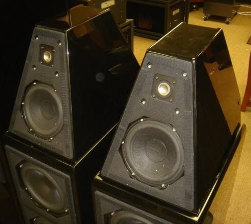

The trapezoidal is near from a famous speaker from Wilson Audio 🙂 : althoug the bafle step was tilted to the ceilling (for progressive time alignment with the tweeter I assume or for some polar map reason in relation with the choosed drivers !). And also a famous JBL !

Yes the Wilson WATT was a big inspiration for me 😉 I really liked the pyramid shape of the WATT. My enclosures also have a slight ceiling sloping front baffle. My idea was that many full range drivers have slightly smoother frequency response slightly off axis.

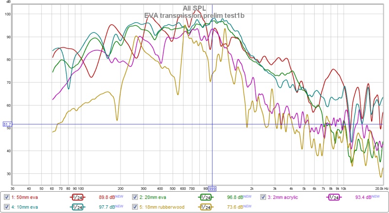

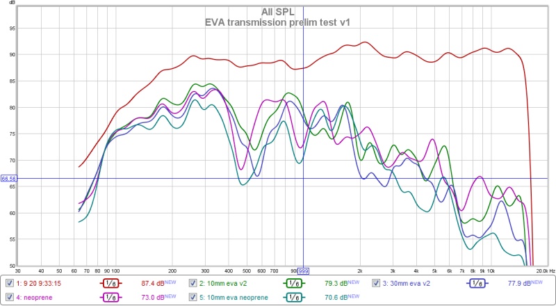

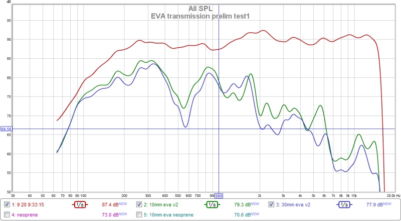

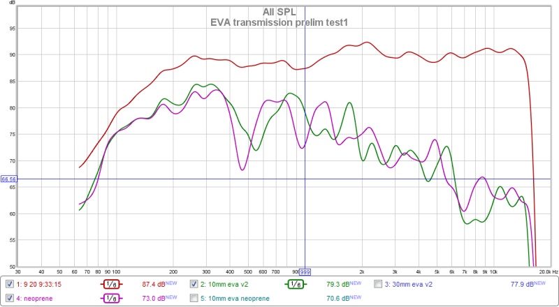

It is in my plans to do these sorts of tests. I wanted to do something a little more scientific on the next round of testing to help convince people. But I can also do something quick and less rigorous if it will help give some impressions? I still don't have MDF or other common materials to compare to. Ok maybe I can pick up a small piece of MDF on the way home from work tonight.

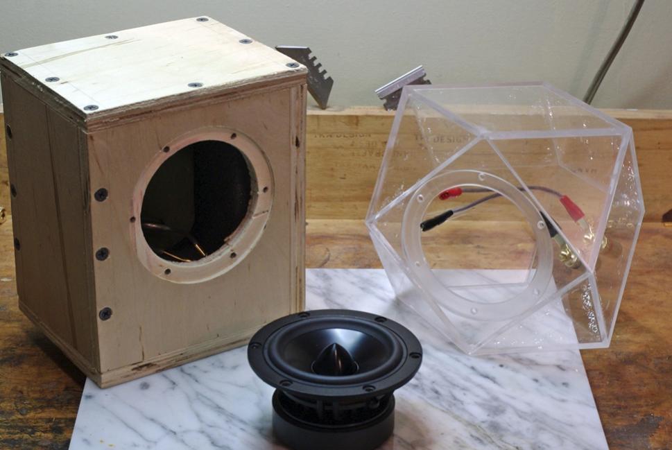

Here are some preliminary transmission measurements I did awhile back. The sound can leak around the sides of the panels so it needs to be looked at in a relative manner. I used my SB65 as the sound source, pointed up, set up mic at about 15cm distance (enough space to insert panel), and then I held a panel between the speaker and the mic (not touching). So just compare to the reference plot or to others.
PLEASE take these as very preliminary
I will also include another plot which I took earlier without the reference (no panel) measurement.
The 50mm EVA is a yoga block so it is a different material/manufacturer than the other EVA sheets (10mm,20mm,30mm koyo softboard).
So the EVA does appear quit similar to other materials, and in the 3khz and up region we are seeing 30-40db of attenuation which should be enough no matter the material.
The rubberwood does appear a little better at attenuating lower frequencies though. The 2mm acrylic/plastic seems to attenuate the high frequency a little better than EVA but probably no difference below that. EVA is a much smoother attenuation than the rubberwood, so the wood would probably add more "color" to the sound even though it attenuates some frequencies better.
