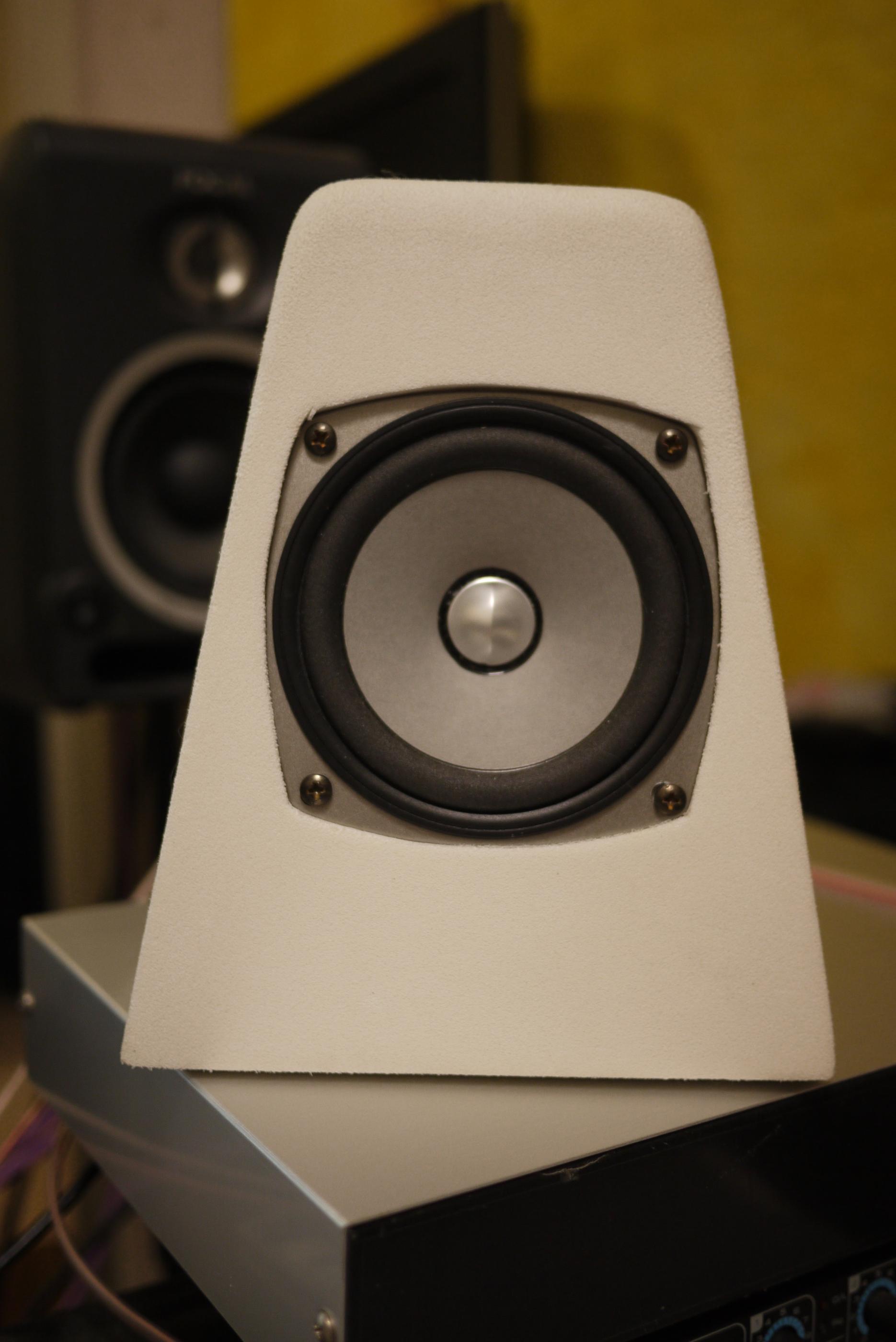

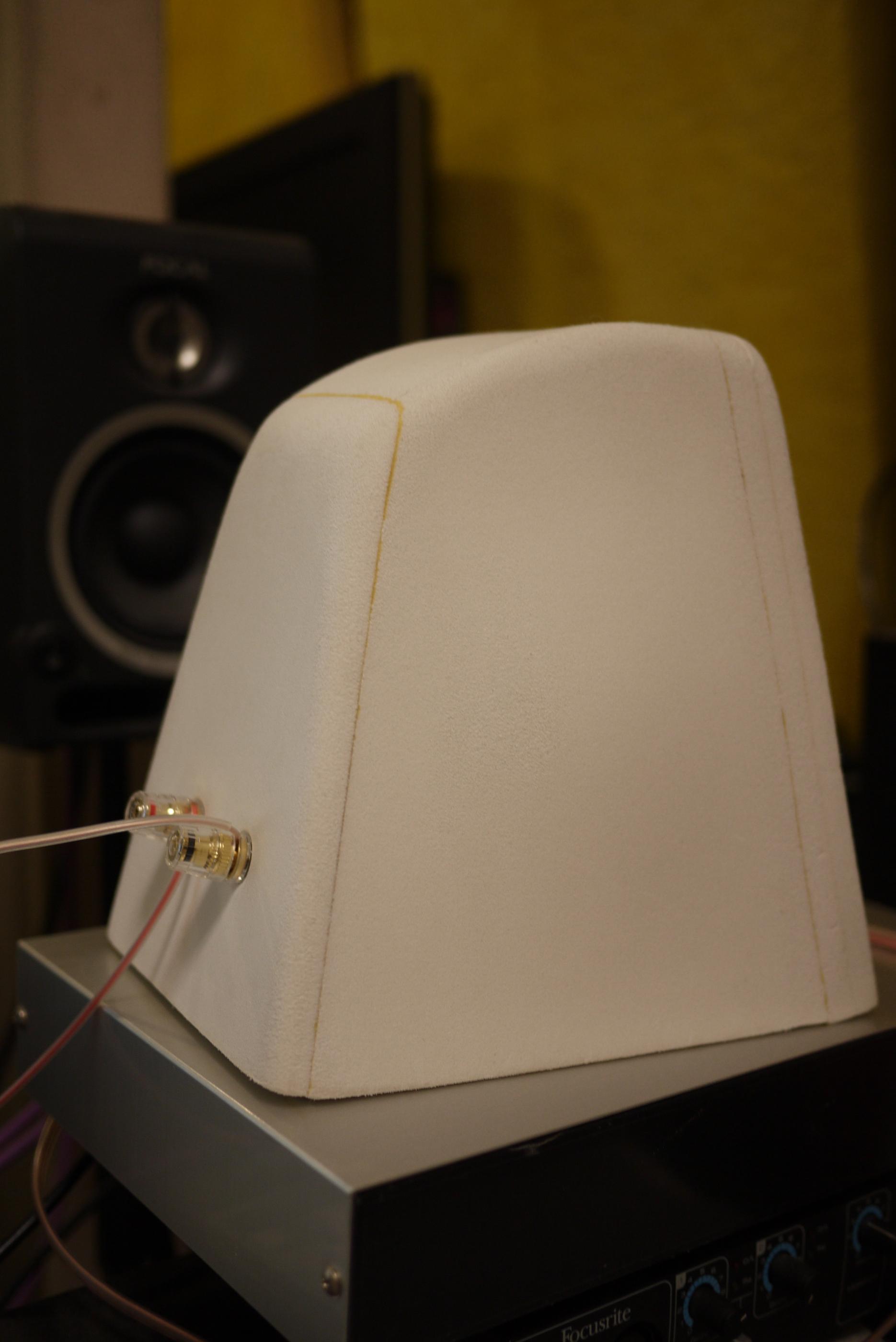

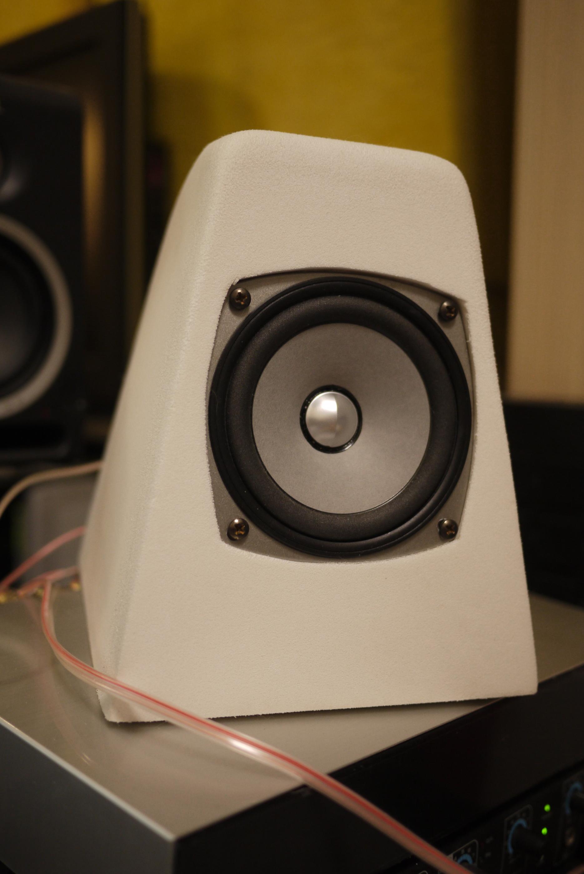

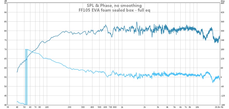

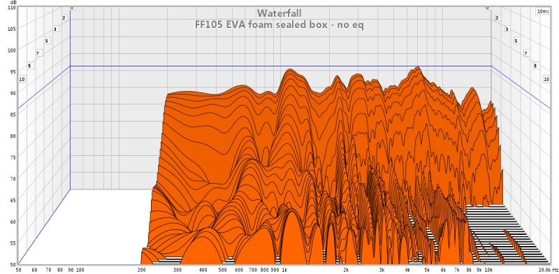

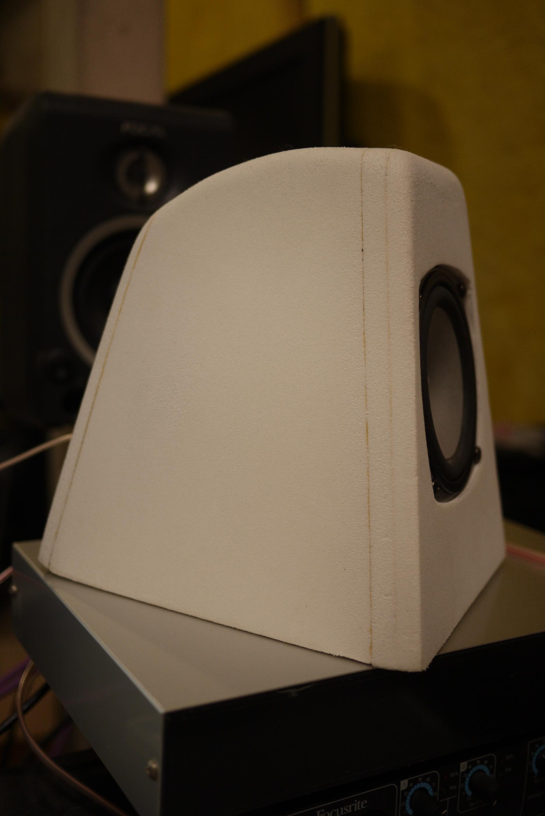

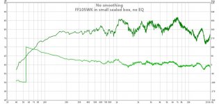

My first build to test the material and develop my building techniques was a sealed box full-range speaker using a single fostex FF105wk driver.
Because I wanted to develop my building skills I decided to go for a very complex shape. I designed a truncated pyramid, with a sloped front baffle, no parallel walls and a curved top. This would minimize all internal reflections (prevent standing waves). And because of the sound absorption abilities of EVA I didn't bother with lining the walls.
I built it with 10mm EVA foam sold in Japan as LionBoard
The front baffle is made from two sheets laminated together to form a 20mm panel. I have an internal bracing "pillar" running horizontal to control resonance on the side walls (walls only 10mm thick) and I stuffed with long fiber loose wool.

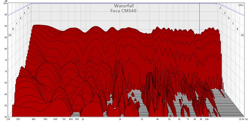

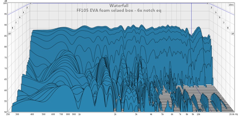

The CSD waterfall plots also look good and comparable to my focal CMS40 monitors. I think most of the resonance is from the FF105 driver. I want to try a higher quality full-range in the near future. I show both a no-eq and full-eq version.

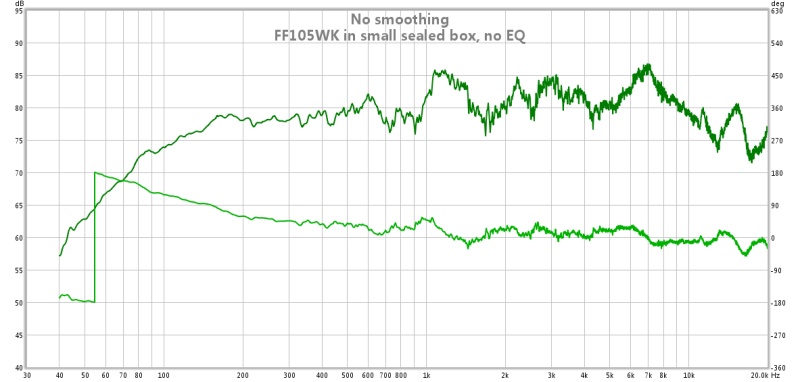

The FF105wk is known for having a strong 7khz resonance spike, but it is not as strong on my speaker which may be due to the EVA foam's vibration damping ability.
