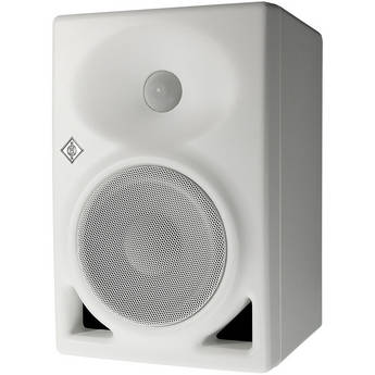

But that is not the kind of aesthetic I like. I prefer speakers that look like these commercial speakers
painted metal
and Neuman even makes their painted metal KH120 in white 🙂
