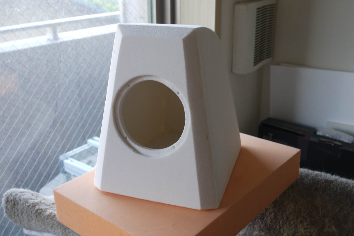

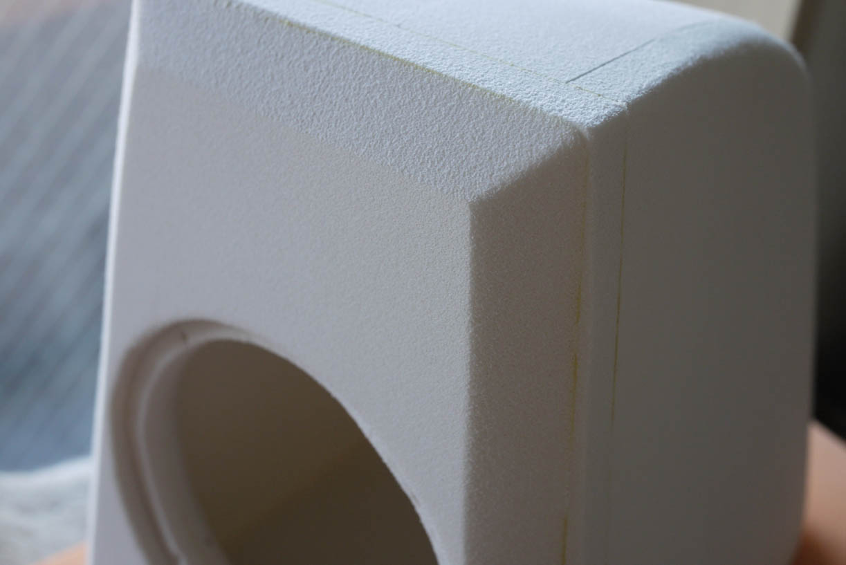

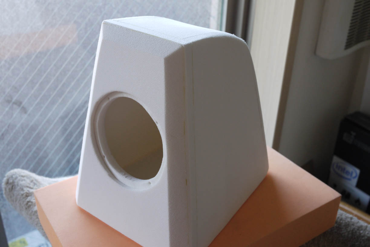

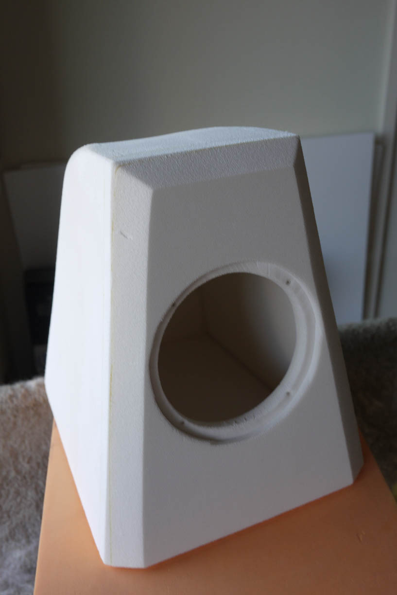

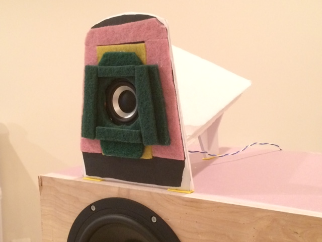

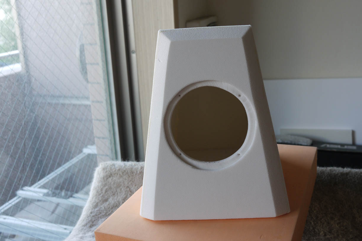

I am almost finished with a new box for my 10f/8424. Made it with a faceted baffle like Troels Ellam Flex or an Usher Dancer miniX

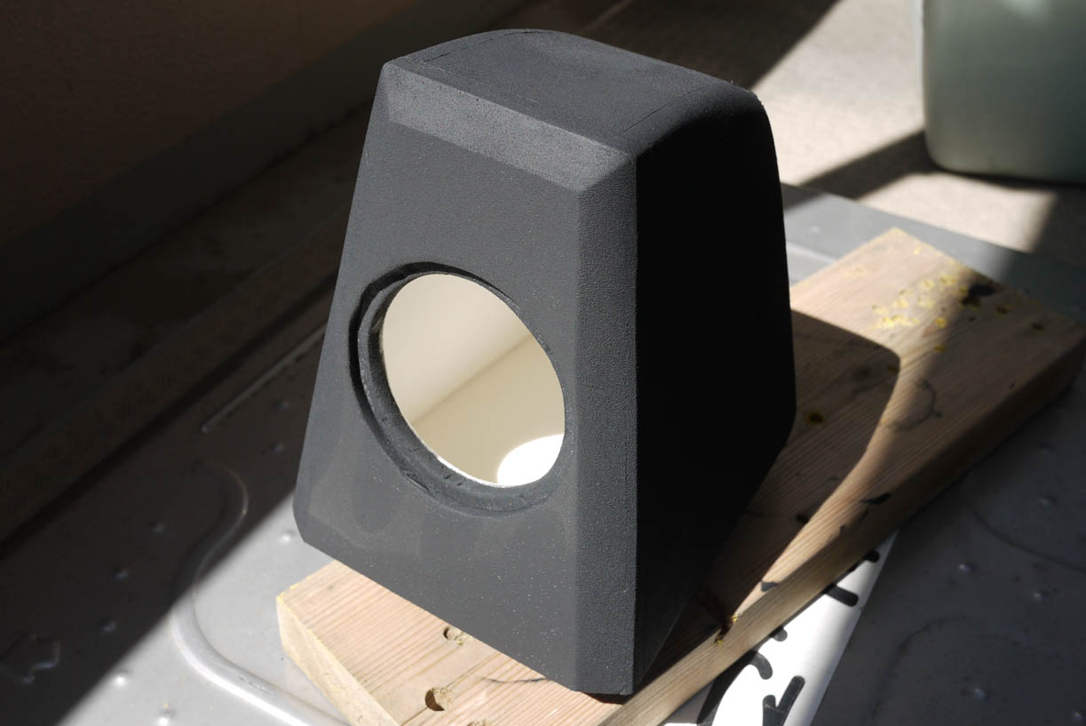

And I am painting it with black gesso to give it a stealth fighter / batman style look. Paint is drying. But here are some pics of the front baffle facets before painting and with two coats of gesso. If it works out well, I will make a pair for the 10f/8424.
Also my little SB65 cannoli-TL is sounding really excellent! I still think the 10f/8424 is better all around, but the SB65 is really liking the aperiodic tapered TL and it is a great little near-field single driver speaker now. It has very surprising bass: just enough weigh, but very tight and tuneful and sounds much more in controller with lower distortion than when it was in a just a sealed box. The rolloff is very gentle.

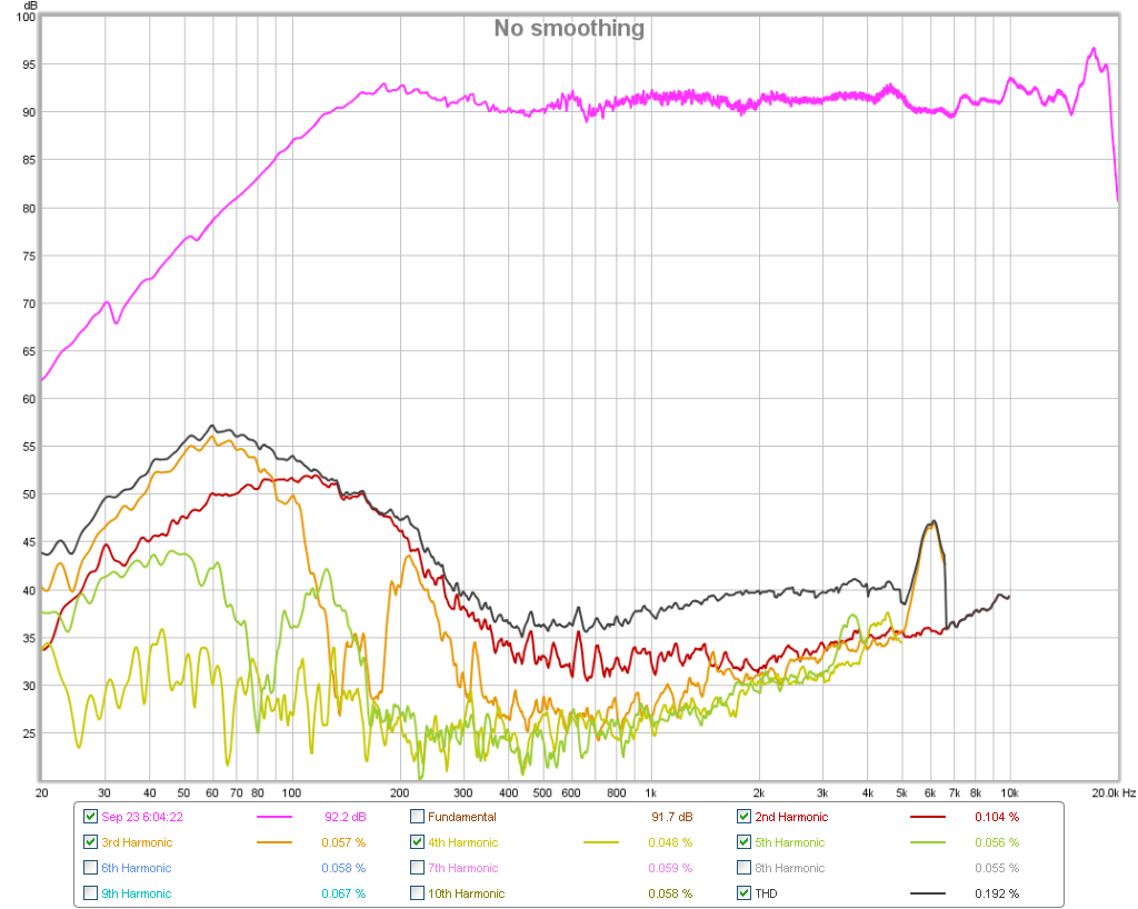

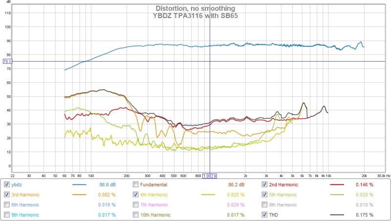

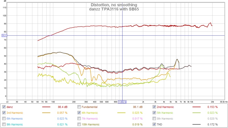

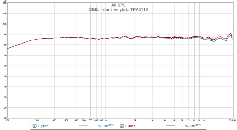

I also did some quick measurements of two of my favorite TPA3116 amps: the danzz YB blue/black amp verses the ybdz. I am starting to think I actually prefer the danzz blue/black amp more now. Seems a little cleaner sounding to me than the ybdz. Both are unmodified at this point. Here are some measurements at 5cm distance and a low SPL of the two amps with the SB65 cannoli-TL. You can also see that the amps have a very slightly different treble response and maybe the danzz has a little lower distortion. I did the measurements several times (switching back and forth) to make sure I was not accidentally moving the speaker. I just swapping cables between the amps.

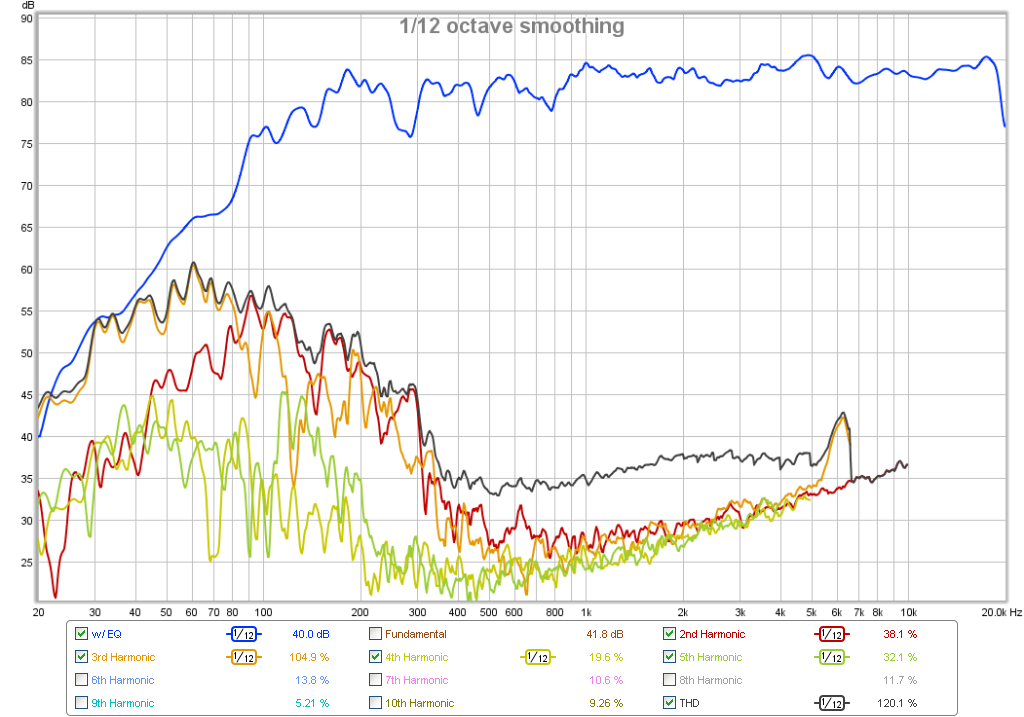

Here is an extended sweep going down to 30hz of the SB65 cannoli-TL. Even at 30hz and 40hz the driver cone motion is very well damped in this aperiodic TL. There is no need for applying any rolloff "protection" filters.
I wouldn't call this "reference level" but it sounds surprisingly good. And even though I am applying a tiny amount of EQ, it really does not need any.
The fact that the bass rolls off at such an even steady rate allows our ears to compensate easily. No it is not the same level as the satori/RS28f nor the 10f/8424 but it is a speaker I am really enjoying using when I want to keep the volume down. These can definitely play loud enough to watch a movie at night 2meters away from the speaker and hear a full sound without excess bass that would disturb the neighbors. And they do sound wonderful on acoustic music and female vocals.

I may have missed it but how do attach the driver to the eva foam?
Jay
If the driver is heavier like the SB acoustics Satori MW16p, then I use hard inserts. I use a local japanese version of this for softwood.
Threaded Inserts for Soft Wood | E-Z LOK
http://www.diyaudio.com/forums/full...ormance-speaker-enclosures-5.html#post4401340
But in all cases I cut a recess for the drivers (like you can see above). I cut the recess a fraction on the small size so that when I push the driver into the foam, it will compress slightly and hold the driver (and form a better air seal). The EVA is soft and compressible so this works really well, kind of a press-fit seal. So with small 2.5"-3.5" drivers the pressfit is almost enough, but I still run threaded bolts or wood screws through the foam to add more friction. On this next 10f/8424 box I am going to try to glue some M3 nuts into the foam. I am not sure if there are M3 sized threaded inserts.
Thank you. That was quick. Thank you for the links as well. Do you use sharp blades to cut the to cut the foam like X does with his foam core or are other tools more appropriate?

Great work on the new box - love the faceted look. That EVA takes to being sanded like nothing I have seen except maybe plaster of Paris. 🙂
On your amps I think the ybdz had 22uH inductors (suited for 8R) and Danzz has 10uH (4R) and SB65 is 4R. This may be causing the pronounced differences in upper treble. They are like very different amps with oscon and bootstrap snubber mods. Noticeably better sounding immediately. So give those a try - you are one of the few people I know still using ybdz - one of my favorite amps still.
The frequency response on the Canolli looks very nice. How much EQ are you using? Just goes to show that an aperiodic vented TL suits it very well. I will try to make a small vented TL for it and repeat my measurments. There was a reason we both ended up picking it for Round 3.

I just use an exacto like knife with reasonably sharp blades. I will not put in a new blade every time, but I do try to change then reasonably often.
I am using an OLFA AK-4 which is a really excellent art knife.
I use the small break off tip utility knives - 3 pack for $1 from dollar store 🙂 I also use an Xacto with blade #11 that I resharpen periodically with a ceramic stone. I switch to fresh snap off blade when starting a new major project (about every 3 speakers).

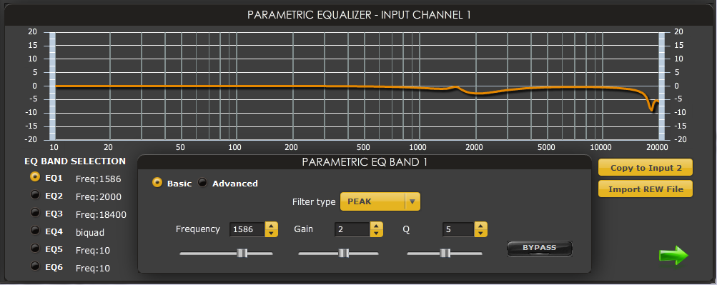

Looking forward to hear what you think of the SB65 in a small vented aperiodic TL. Mine was probably a happy accident, so please consider modeling it better.
There is only a tiny amount of EQ. Maybe the small trapezoid baffle is causing some diffraction effects. Some around the 2khz range, and then a lot of taming of the 15khz-20khz region which is inherent in the driver.
2000hz -3db q1.2
1586hz +2db q5
18400hz -6db q4
biquad (BW6 low pass 18500hz)
Very precise look there Jeshi. Do you use any helping implements other than just freehand cutting and a ruler?

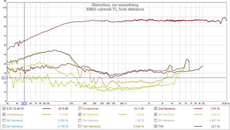

Your Canolli works exceptionally well, my Dagger with Scotchbrite can't seem to get as smooth even with EQ. It may be the stuffing - I have not played with it yet and its pretty loose inside. My measurement is at 50cm, maybe 5cm makes it look smoother?
Edit: here is 5cm data with EQ:

thanks, all free hand. I have a nice ruler with a mirrored edge to help cut straight lines. I have a pretty steady hand so I can free hand cut at an angle. For these facets, I marked the top and sides at 12mm so that I could follow the line both at the top and tip of my xacto blade and get a nice 45deg facet. And then I use a sanding block to get very flat edges. I prefer hand tools and doing things free hand. Feels more like sculpting. And I actually enjoy the sanding part a lot. Watching the rough shape start to change into its final form.
These are so small, that I prefer the look of the sculpted foam. I really don't want to cover it. But some paint is ok for me. I may try lining these with neoprene, or I might just stick with natural fiber stuffing (wool, alpaca) like my other small speakers.
