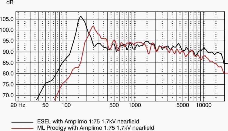

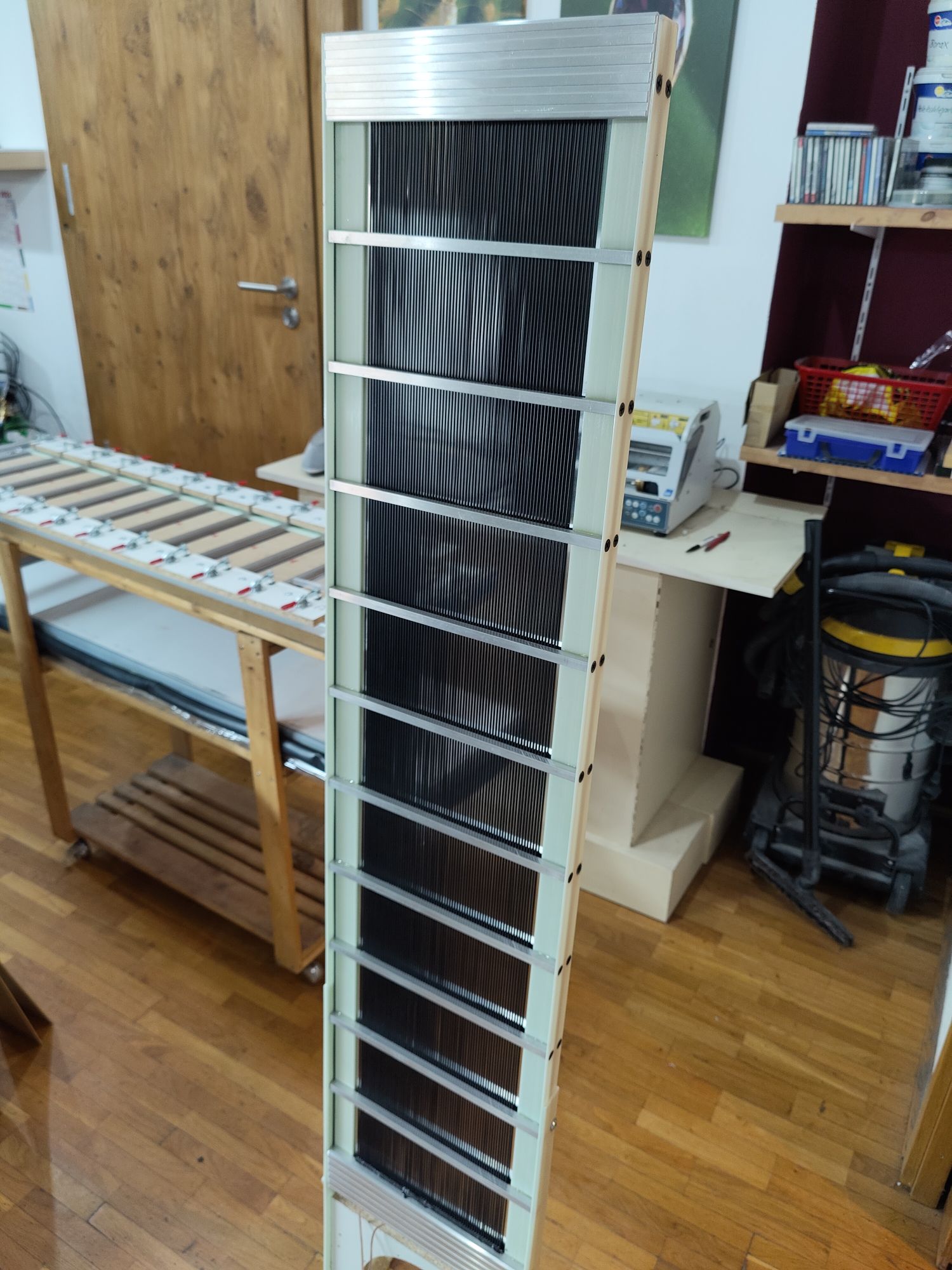

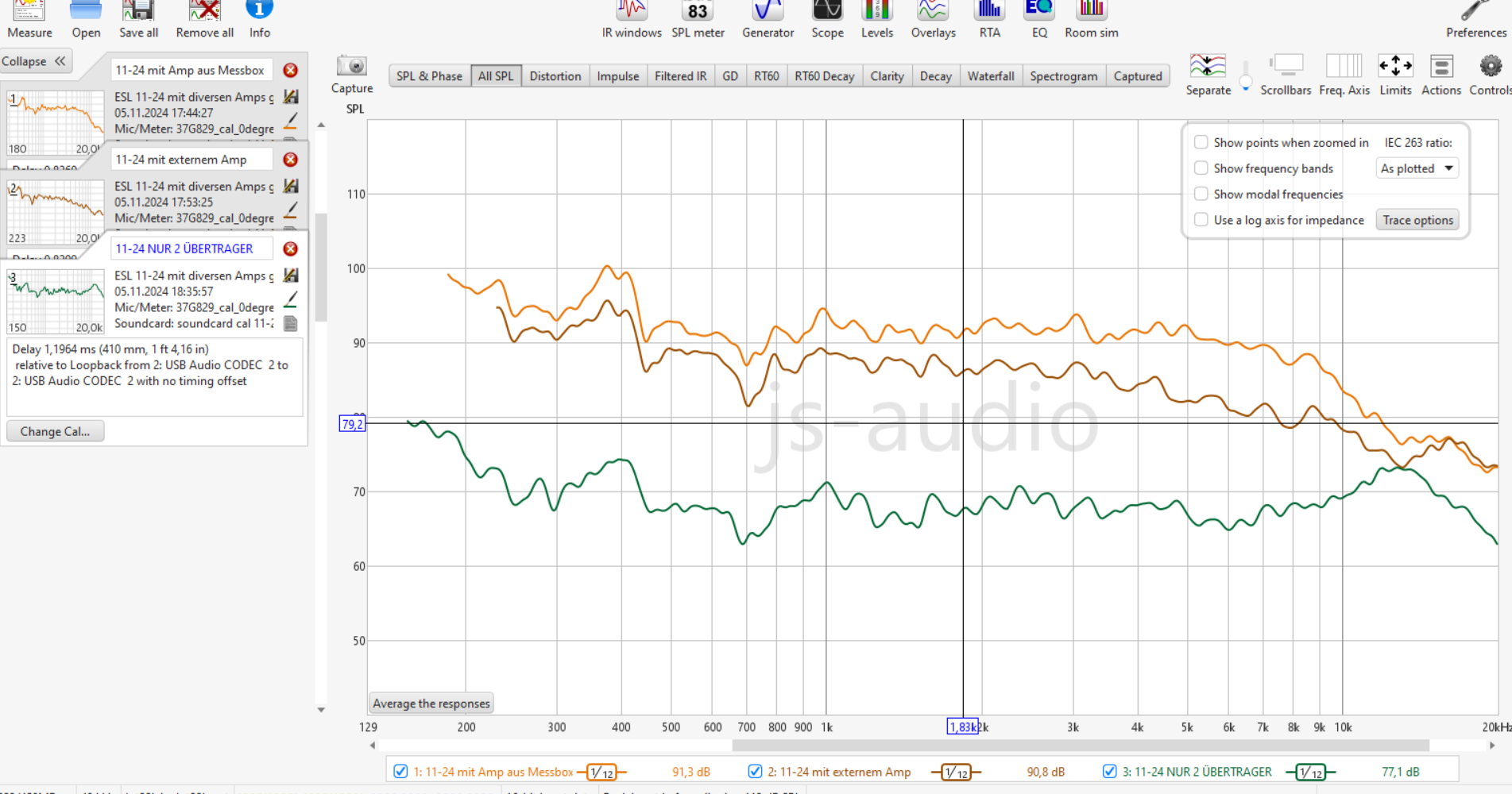

Hi all,
it took some time but here i am again....
In the meanwhile a lot of things happened.
I had to move my workshop, summer holidays, some throwbacks and so on...
But now we finished our first stator, measured it and also tried it out with some bass speakers...
Even if the sound was really amazing, i am not sure if we should be happy with the measuring results...
Above 10 kHz we seem to have a loss of highs. The measurement was taken in a big room with the mic in different distances (10cm, 1m 2m) all with simillar results.

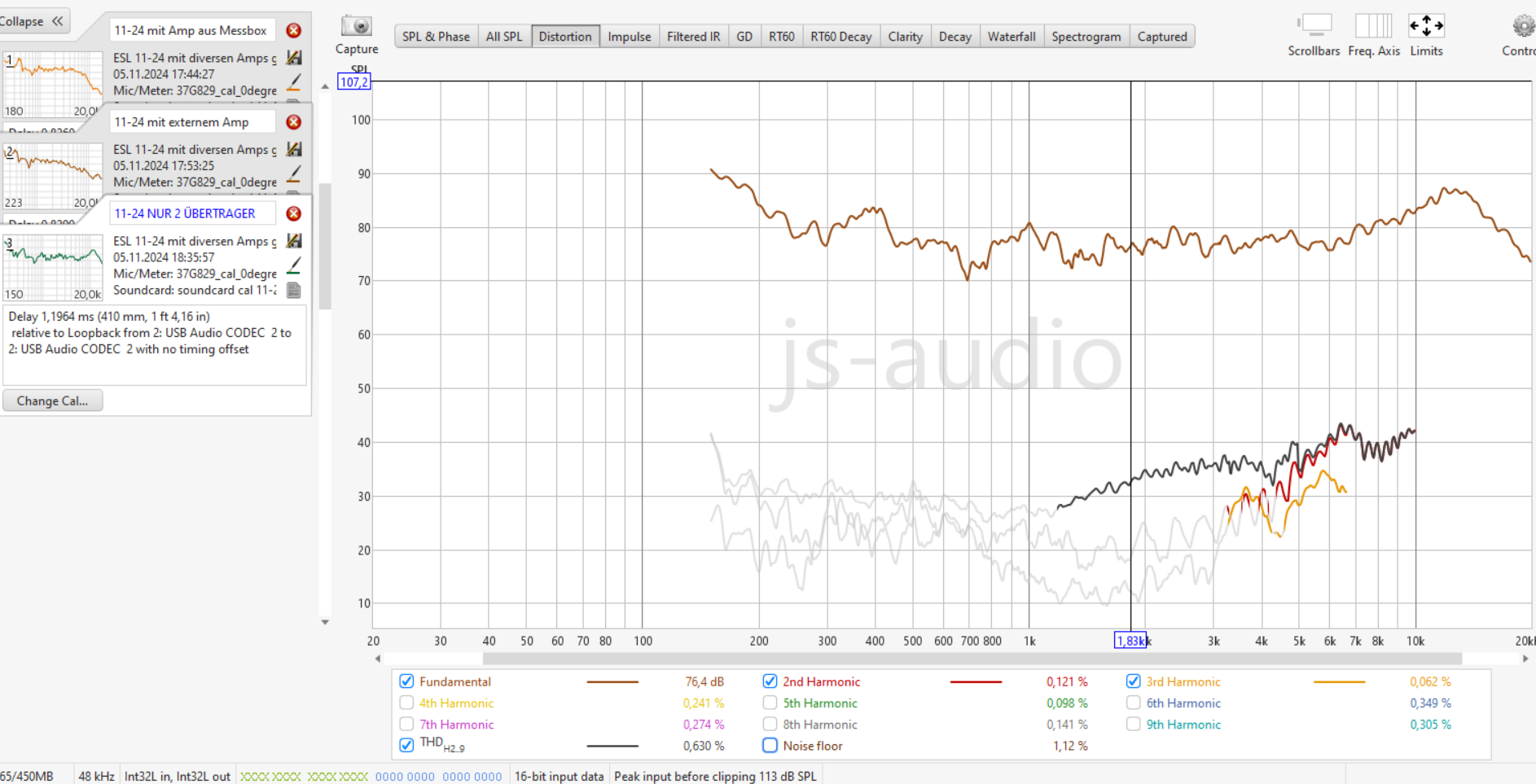

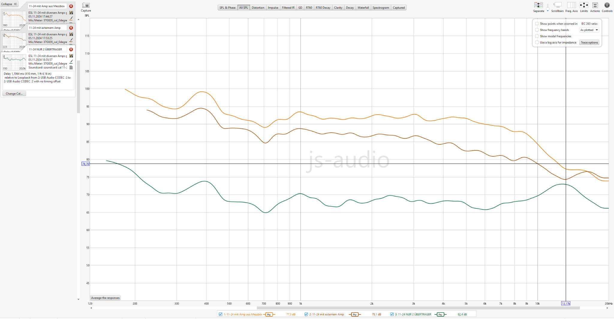

The first measures were taken with four toroids (153:1) including a 2 Ohm resistor.
Then we tried several amps (all of them Class-D which are not ideal for ESL what people say...).
Finally we measured with only two toroids (76:1) plus a 1 Ohm resistor.
For me this curve looks better than the first ones.
What do all the specialists out there say?

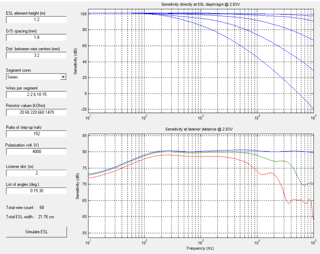

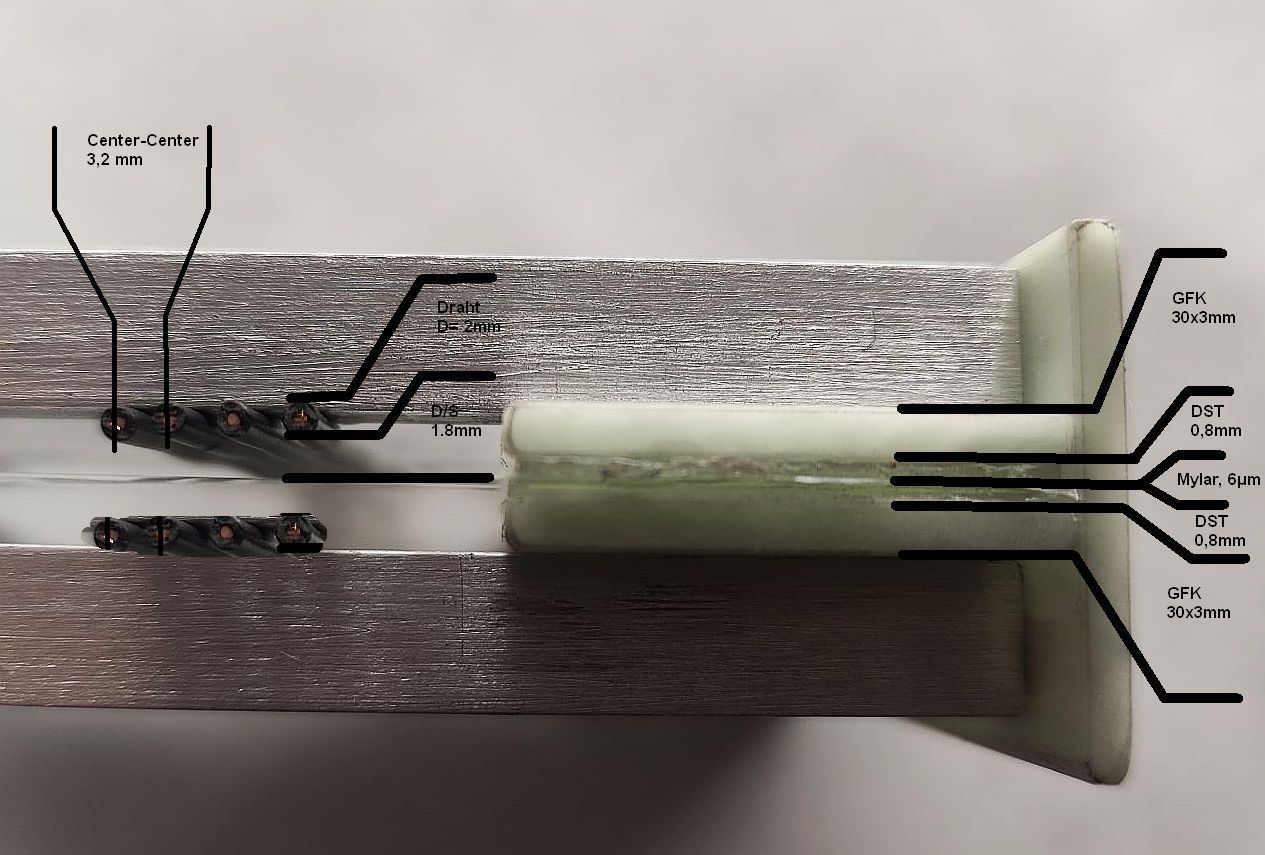

To be honest we don't know about the bias voltage since we use an adjustable HV-supply and we can't measure HV since my multimeter can only handle up to 1000V...
The d/s spacing is 1,8 mm, wire/wire is 3.2mm... There is also a simulation attached...
Despite of anything we are very happy to get the first panel playing.
Anyway, a lot of things have to be done and a lot of questions are still open....
But like the French say: "C'est la vie"....
