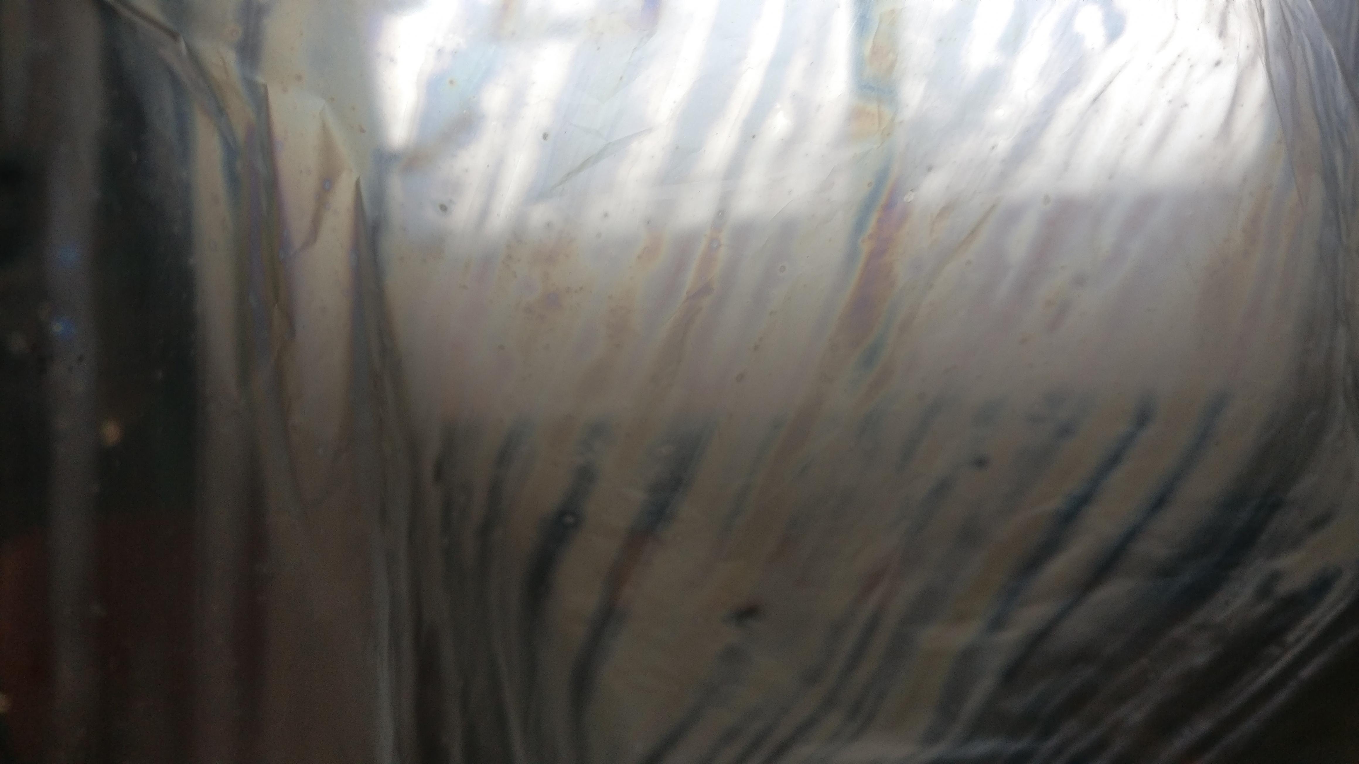

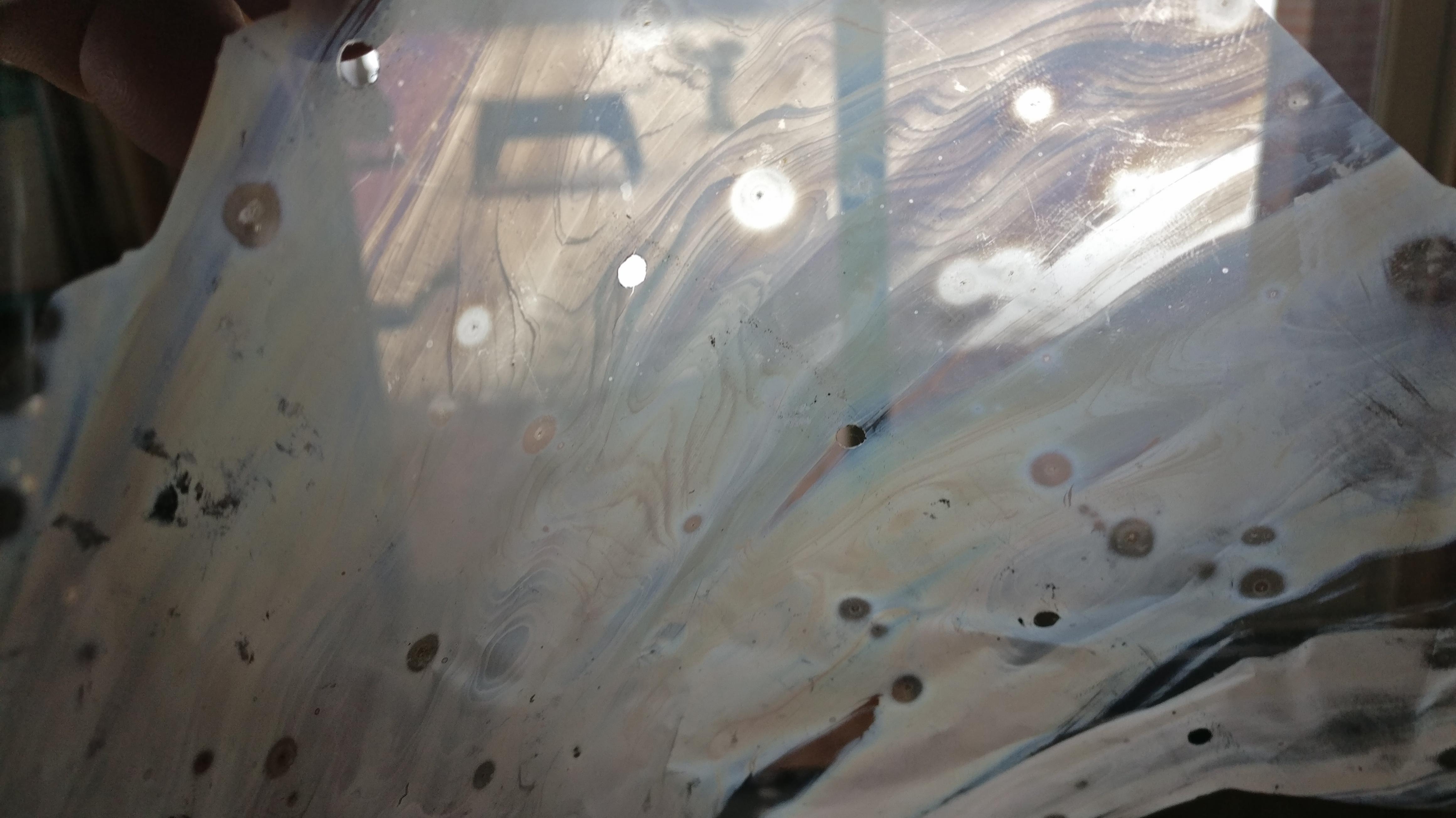

ESL 57 coating
Hi guys,
I want to share some pictures with you from my last testing on Quad ESL coatings.
The first picture (named original) is a photo from an original ESL-57 bass panel diaphragm taken from speaker # 40961 which places it in around 1976. Specially look at the colour haze, a bit brown/ purple haze that lies over the coating with the light shining on it correctly. This is a very peculiar look that I have never seen in any other coating I tried over the years. If writings and findings on the web are correct this should be a Calaton coating, or was this already removed from the marked in in '76 and replaced by something else?
The second picture is my test coating. And again look at the colour haze and the way the coating reacts to the surface. To me it looks very similar, but maybe I'm biased because I want to see it.
It looks like it's applied by a toddler, which I can assure you I'm not. When applied it was very very smooth and very even, but this is how it dried. (read posts and see photo's about this earlier in this thread).
Like with earlier coatings I tested this is just a first step. I have to see if I can apply it properly, how it measures and how it sounds, so still along way to go. But I thought you might wanted to see this.
