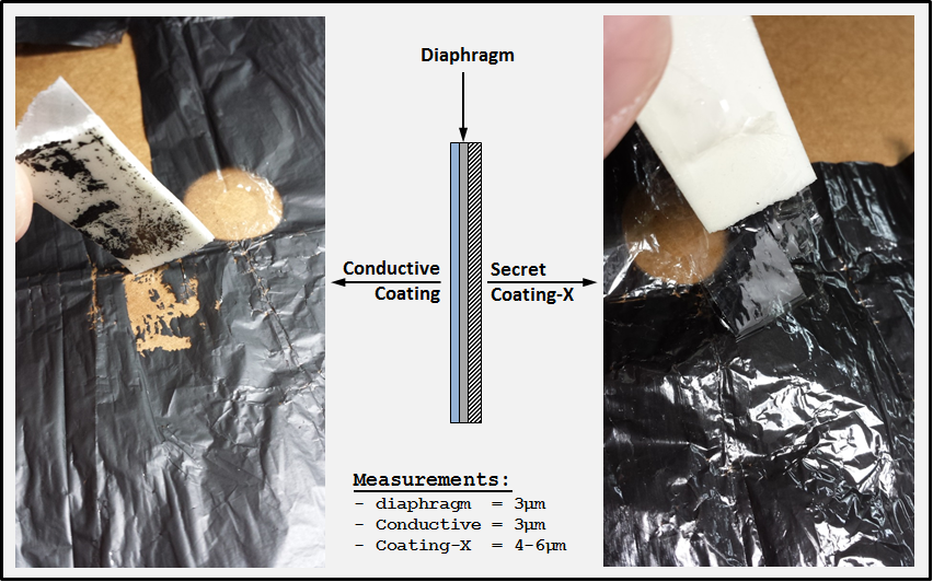

Is this a multi layer coating? I see a white line on the short end that is covered with a black coating that don't match up. Both layers look not very evenly applied. Picture of the left side #3538 looks pretty good, picture #3537 looks terrible. Is this the multi layer coating that Quad is talking about? What is de first white layer? I wonder how thick the coating is if applied in multi layer. Have you measure it? My 2 cents for what happened: the coating isn't flexible enough that causes cracks in the coating that in time tears the Mylar as well.The diaphragms develop a lot of little slit like cuts and eventually fail. Here's three large pictures of one (kept them large so you can really zoom in)Sheldon
I believe this is the damping coating mentioned in Post#1094 that is applied to the opposite side of the diaphragm from the conductive coating. Well, at least it was in the in the few panels I have had my hands on. Thickness was variable, but nominally 5µm.… Is this the multi layer coating that Quad is talking about? What is de first white layer? I wonder how thick the coating is if applied in multi layer. Have you measure it?...
If the coating has damping properties why is the cumulative spectral decay of a quad not better than lets say audiostatic? According to measurements done by Stereophile (take a google search) the ES100 does a better job than Quad 2805 regarding the CSD plot. Maybe the CSD plot was much worse if the Quad had not this 'damping' coating, we only can find out when measuring an original panel against a panel with new Mylar without damping......
I also think there are better ways to kill spurious resonances and such thick coatings only degrade high freq. response (quad rolls off at high freq.....)
