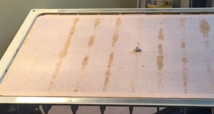

My cheap surface resistance meter arrived yesterday, I've not had chance to check the accuracy of the reading yet, it has proved a bonus in not tearing the membrane though.
A broken panel from old 63's, S/no 1692 with 2 part coating showing a surface resistance of 10^6/10^7.
A 'new' panel as fitted by Quad at Huntingdon March 2014.
Surface resistivity 10^8/10^9. 1 part sprayed coating with convex corner pattern, damping mesh to rear stator is a mauve colour.

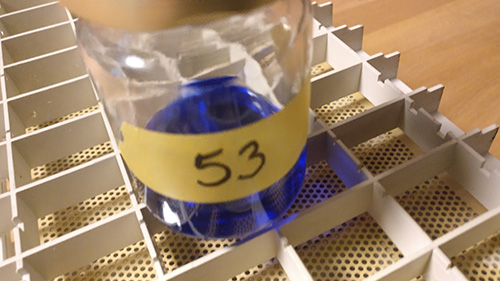

My last testing is with coating test number #353 (I'm mixing and testing for 3 years now)
As I wrote in earlier posts I'm now testing with different humidities. This last coating has a blink interval of several minutes at humidity 50%. The interval is 15 seconds at 65% humidity and 2 seconds at 85%. So although the blink interval is much much longer at normal humidity levels than with my earlier coating, I cant improve the interval between blinks at the 85% humidity level. So I leave it at that. As I mentioned before the humidity in my country hardly ever reaches 70% and mostly it is between 40% and 55%. The thickness aof the Mylar with the coating is 4 micron and the weight is 6 grams/m2 both measured with my cheap China made scale and thickness meter. It is a PEDOT based coating hence the colour blue.
Now on with further testing on sound, SPL, sensitivity for spark damage, durability etc.

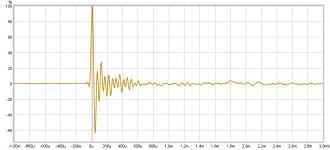

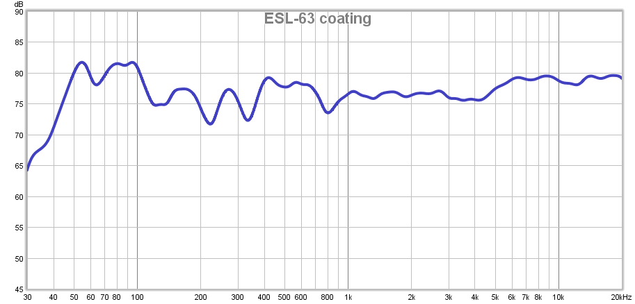

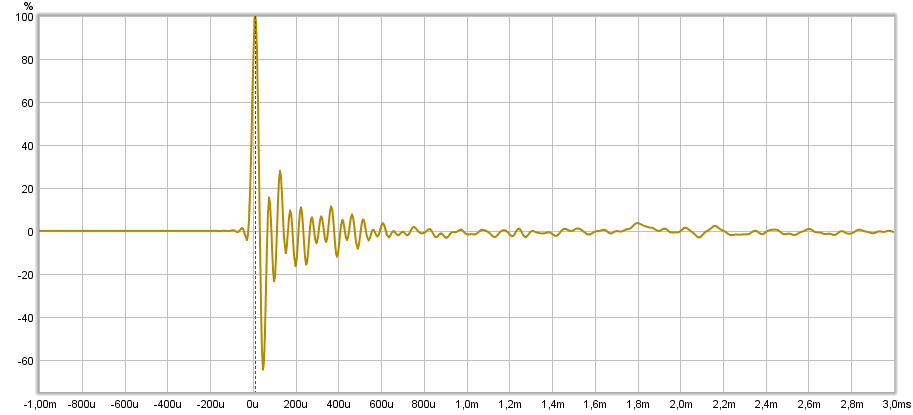

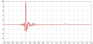

Here are the first measurement results of the ESL-63 with the latest test coating applied. Measurements done with REW version 5.20 with the MiniDSP UMIK-1 microphone with calibration file at 1 meter in front of the speaker. Just done in my living room, so no acoustic dead room! The frequency graph is smoothed with 1/6. The pulse is a 4 ms window, from -1 to +3 ms. It looks pretty good to me, but remarks are always appreciated.
My interpretation:
Frequency: 40 Hz to 20 kHz within +3 dB and -6 dB and very strong in high frequency region in comparison to charts I've seen from Audiophile tests.
Pulse: Total silence within 500 micro seconds and very symmetrical reverb
SPL is measured to be 84,1 dB which I think is still a little too low
Distortion numbers are 0,15% on average
