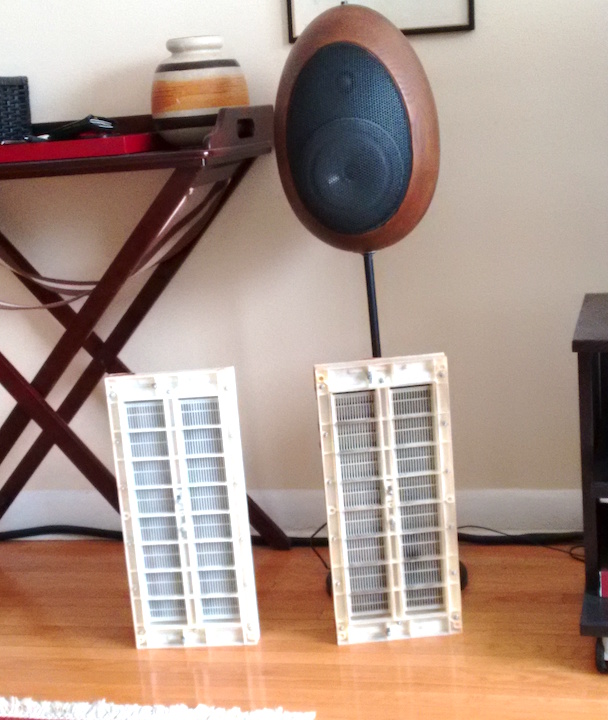

Mockery aside, below is a picture of the type of cell D-W used. It is cast plastic of some kind quite rigid, deep ribs. The stator is formed by spraying conductive paint to the inner face. There are cavities at both ends that hold 25-megOhm (?) resistors.
I couldn't say what structural differences matter. Just illustrating difference in construction.
BTW, based on the D-W example I've often though that DIY ESL panels might be built with egg-crate "lenses" from ceiling fluorescent luminaries.
