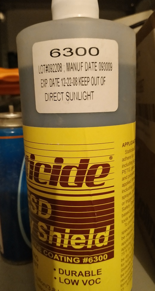

Hey Guys !! ...........
Been getting back in to designing/building/finishing the Desktop Esl III and amp,
Since my last days of testing my can of Licron got a pin hole and drained out everywhere, and I had a partial can of Crystal somewhere too , who knows where.
Anyhow,
They wouldn't have been enough for what I have planned anyway and I was wondering if Walmart had anything and they do carry Staticide !!
So, I was thinking about having some shipped in as I need some bulk (small more than spray can) stuff for now, I will be building some bigger panels and I can just see myself ripping up just as many diaphragms developing them as I did doing the Desktop ESL versions.
Of those of you whom has tried it which one of these products will get me going right of off the bat?

All biological degradeble products is no no.
All products for your skin is... i guess nono at least for your speaker, have not tried them but my intuition say no.
Cleaners, im not sure, they are not ment to stick... so no no Bu i know people hwo tried dish soup for esl 57` and it worked for some years. but No no.
Coatings, not bio degradable:
1070
6300
6400
3030
and maybe 520
I have only tried 6400 and I like it, 8 out of 10.

6500 is canned 6300. Anyhow ACL rep insisted on better performance of 6300. Tried it liked it. Acrylic 6400 is urethane one like licron(?). By the color it's PEDOT based.
I would of dilute it to a needed value. Even very thin layer (rainbow due to interference, below 1 um) is conductive. Heating during drying helps - read TDS.
