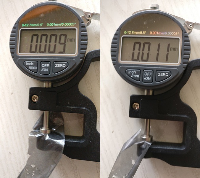

Yes, the total thickness I measured for the 3 layers averaged about 11μm. (1μm = 1 micrometer = 1e-6 meters, or 1 micron)

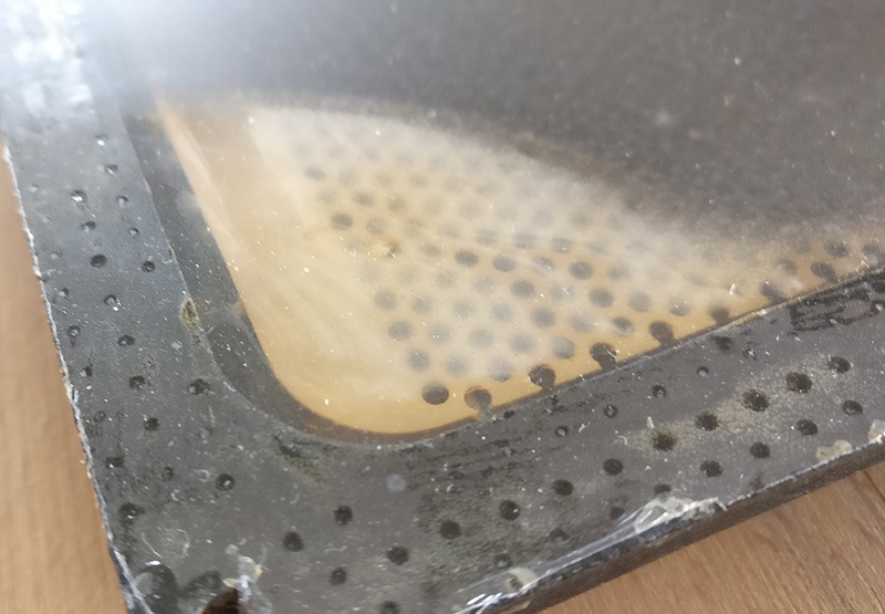

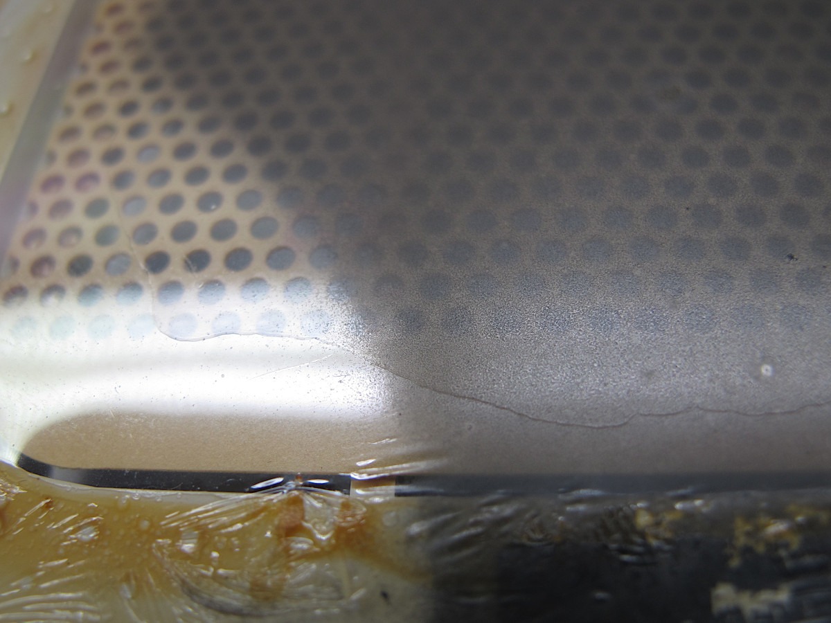

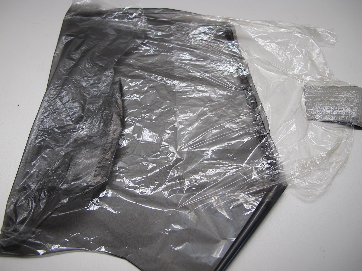

My SN 023809 and SN 023810 Quad63 have the X-coating. This coating feels and mechanically behaves much like a PE-type food wrapping foil. I do not say by that, that I think it is PE! I only want to point to the fact that this layer is very well done and also rubust in terms of tension which can be applied onto it, once selectively stripped off. I would very much like to know what X really consists of.
Here you can clearly see the "shoreline" of this X-coating. X is on the back, conductive coating on the top:
And here the way you can strip it off quite uniformely:
A close-up of the stripped corner. Left top quarter of the picture shows the remaining mylar with the conductive coating on the back side, top right the stripped off X-layer:

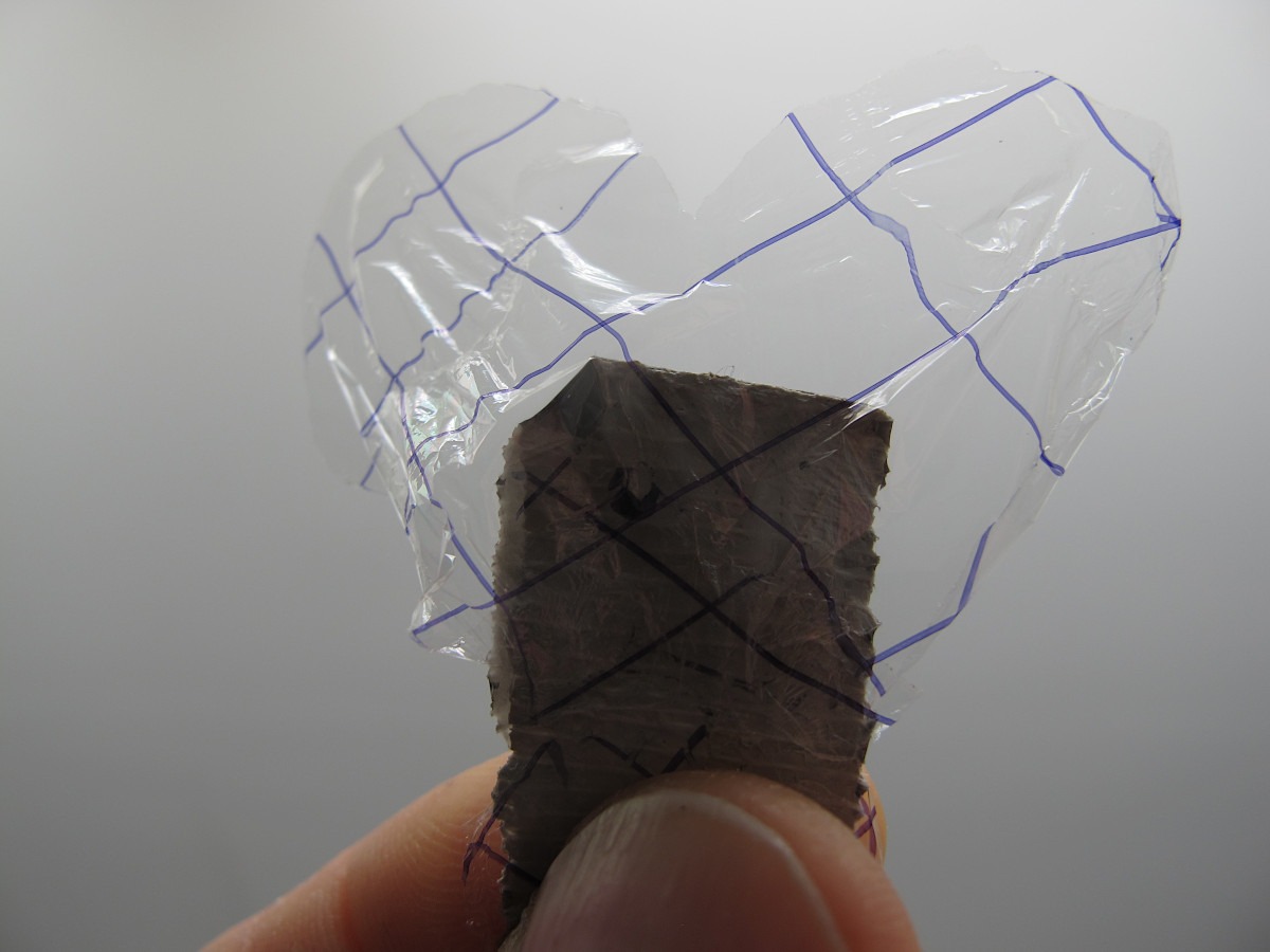

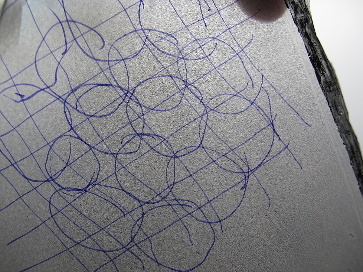

And now for some creative work - First draw circles on the conductive layer side, Lines on the mystery X layer side ...
... then melting a contour onto the X-layer it at some 215...225°C (below melting temp of the mylar), you can then selectively strip this X-coating off ...
... thus getting straight to the hearth of the X secret:
Et voilà !!!

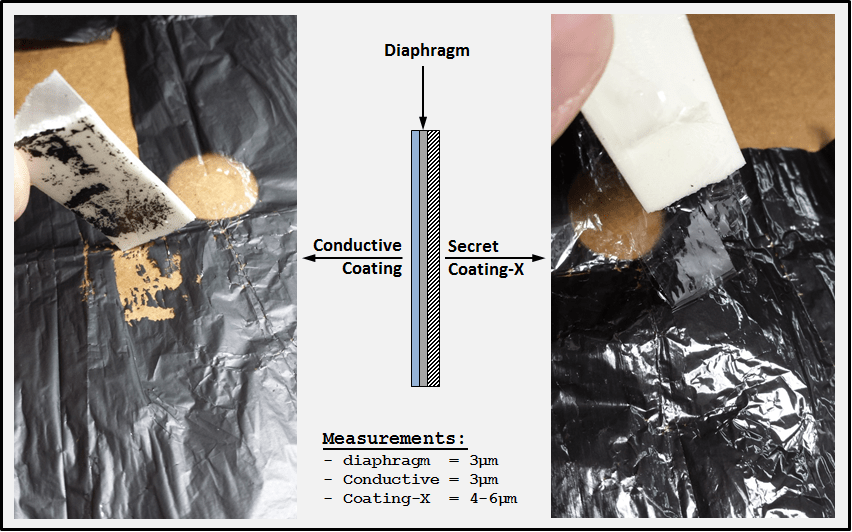

Et voilà !!!

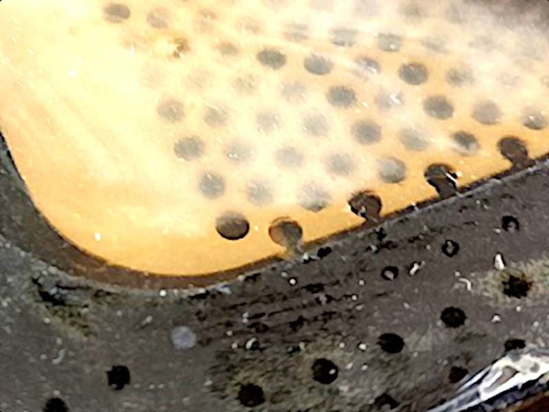

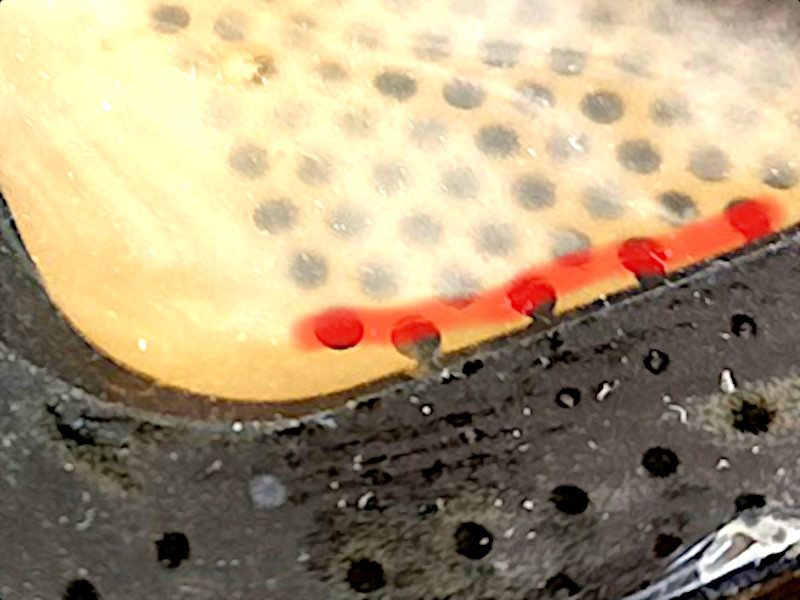

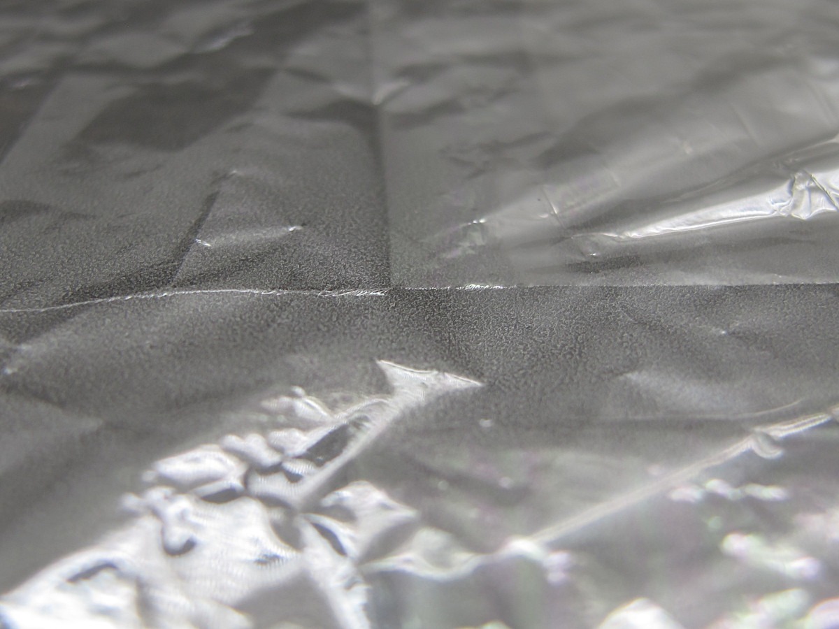

A picture of a very early black panels with the original Mylar and coating. Also multiple layers. No X-layer though.
Thicker means stronger roll-off in the highs and a worse pulse response. Just my thoughts
Your foto is the the proof that the damping coating (aka "X-layer") was applied also onto the early, black-matrix'ed Quad63.
Your original foto is quite flawed (lighting, sharpness, contrast), but you can see the "shoreline" and the slight blurring effect of the damping coating despite it's optical imperfection. To make it more evident, I scaled your foto twice, sharpened it and increased the contrast.
The thickness of this 3 micron Mylar with (all) coating = 9 - 11 microns.

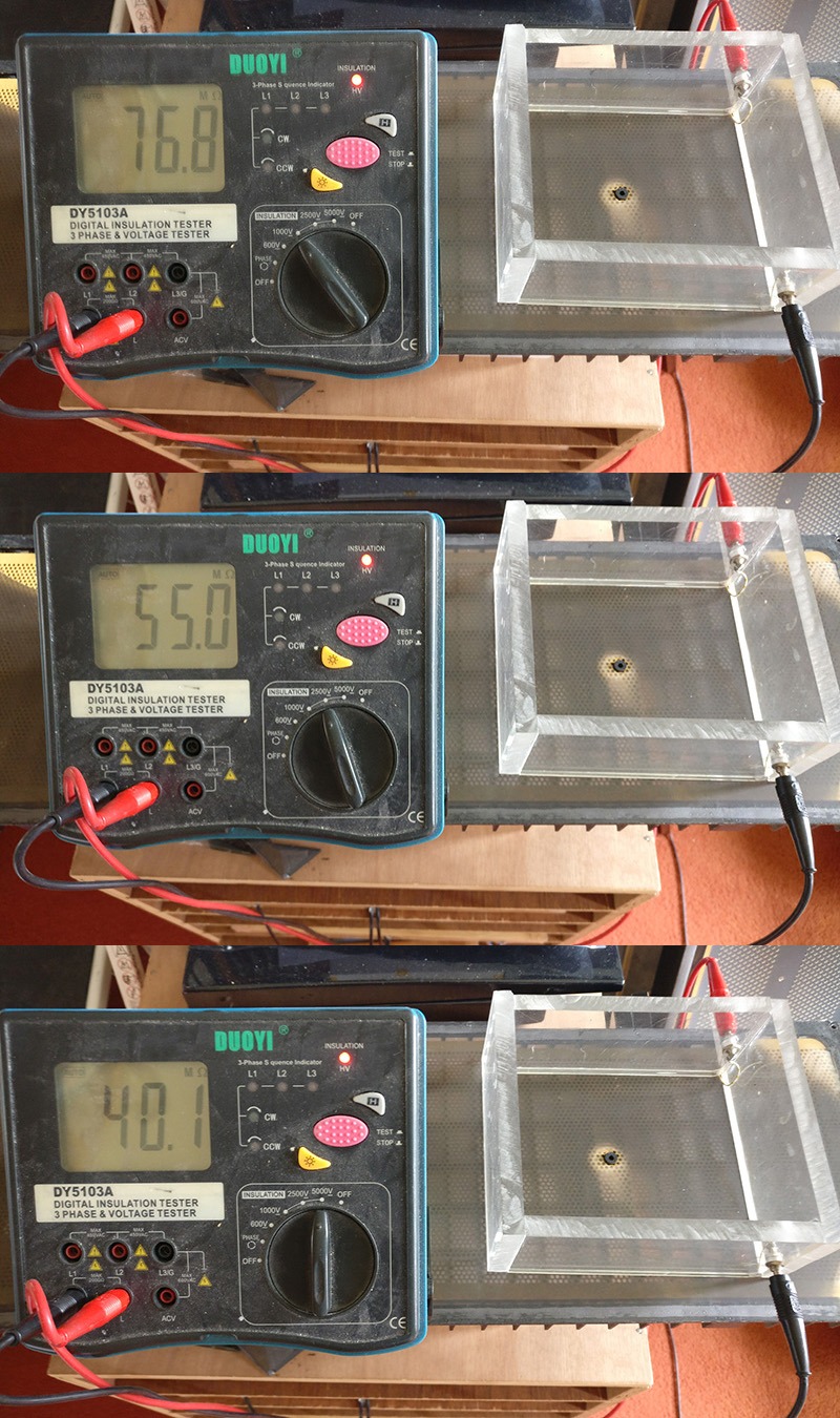

And the resistivity of this coating = 80 - 40 meg ohm per square, measured at 1000-2500-5000 volts
That damping coating is indeed present on the early black panels I've seen. It often turns milky on those old black panels (as you see in the photos above). But doesn't on the newer ones. It could be age or that they changed the formulation slightly. No idea what they were trying to accomplish with it, but it does seem like the negatives of it would outweigh the positives.
Your measurements seem correct as far as my experience with surface resistivity. I use a smaller square (about 2" x 2") and I get 10^7 range ohms per square.
Sheldon
Sheldon
Nice measurements and nice gear!
Your thickness measurement fits perfectly to what Bolserst stated above: 3um Mylar + 3um conductive coating + 4...6um X-damping coating.
And as for the SR measurements, also I got a SR of approx. 50Mohm square on an original Quad63 diaphragm coating (which by Forum's standards seems a bit on the conductive side, a higher SR might be better). Measured with a neat little DIY-diaphragm-glider, and along with a simple Multimeter which ranges up to 2GOhm.

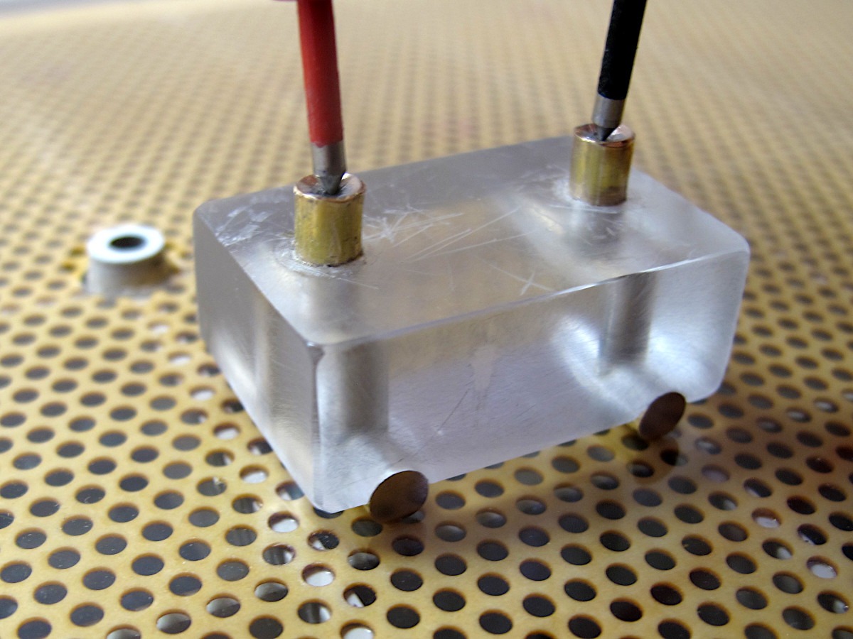

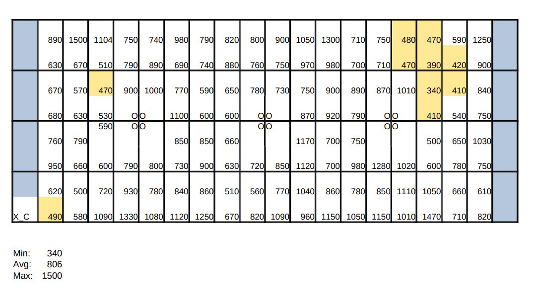

I am currently reworking my Quad63 and have coated the diaphragms with the standard tools and method, and the coating fluid provided by ERaudio (eraudio.com.au). It works very well, and my 3rd diaphragm showed a very neat result after a slight rework. To be sure that I had coated homogeniously all over the surface, I made a 2cm x 2cm probe. So that for each "case" of the diaphragm supporter matrix, I mapped two measurements. The results are approximate and can change by roughly +-25% depending on the pressure on the probe, but hopefully precise enough. And all measurements show a beautiful SR in or very close to the optimum range. I am sure that a next series might show even better homogenity, because I improved my technique from panel to panel.
So, the SR mapping on a Quad63 (coating fluid from ERaudio):
And the 2cm x 2cm probe (shown on a stator to illustrate the half-box-size):
When you apply coating I recommend to do extra coating where the bias voltage is applied. I have also tried another coating with much lower resistivity on the long edges and a extra cm in towards the membrane so approx 2cm or one inch wide conductive layer.
Since the movement of the membrane is almost zero that close to the edge there is no charge migration. The reason why is that even if you are on the high side of the resistivity in some parts, you will get a more even charge. The other reason is that you will get less sparks between the aluminum strip and membrane during charge up. That means less ozone, and this will prolong the life. But be avare to keep the edges absolutely clean after coating process. So an extra cleaning is worth while. When you test a panel in humid environment and look on the bulbs flashing frequency, if you reach on blink in four five minutes you are OK. If one panel is discharging faster than two minutes i would try to fix/clean the leakage path or paths. When you make the holes (3) you must remove the burrs. And again keep the panels clean, and stay away from coat the corners. Try to mimic the originals, thats a good start before you experimenting... ;-)
