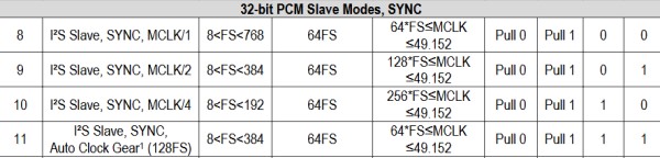

Why not use synchronous mode?
My board was configured in ASYNC not by myself, and just thought about to compare it now. If I want to put external 45.15/49.152 MCLK which HW right mode should i choose, #8? What does it mean #11 SYNC and ACG ?

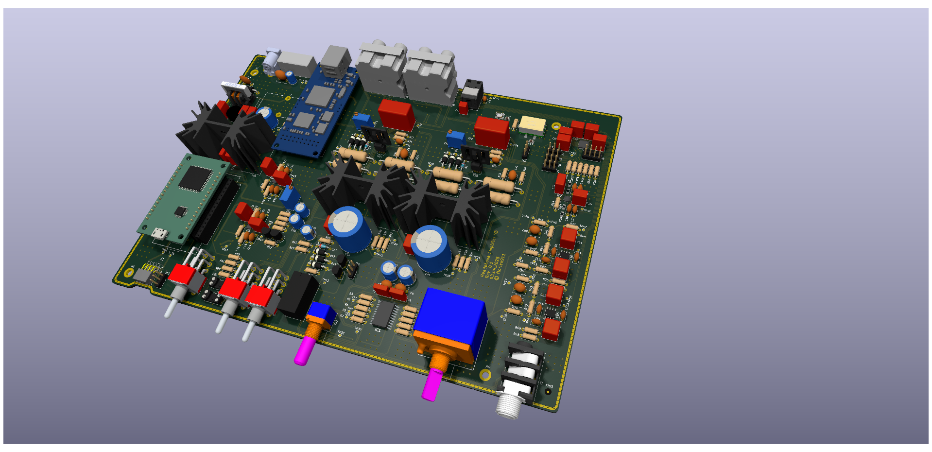

Hello, finally my PCBs arrived and I had time to solder the components.
Pro: Class A amplifier and TPA6120 work as expected with analogue input
Con: So far I didn't get the DAC to work :-(

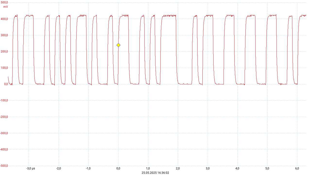

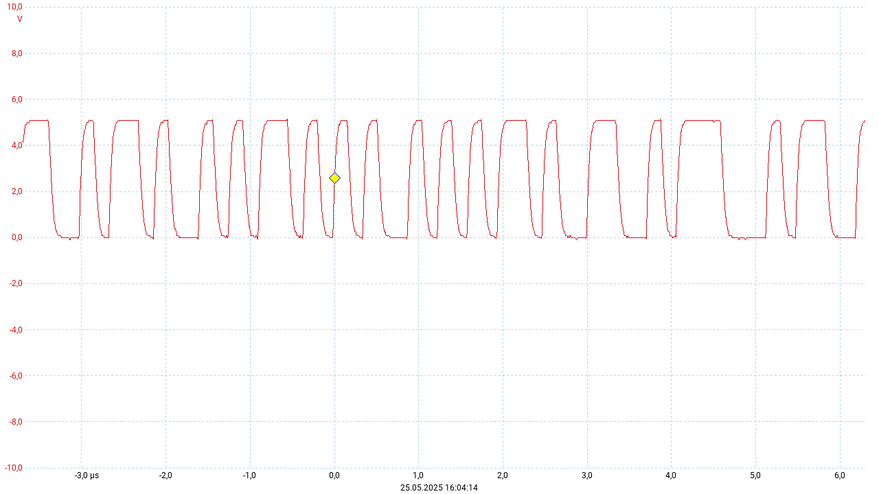

As seen in the schematic I use a FCR684208R as the Toslink receiver, the first one seemed to be faulty, I measured a constant voltage of 4,3V at the output (regardless of the input signal)
I switched the component, this signal seems to be better:

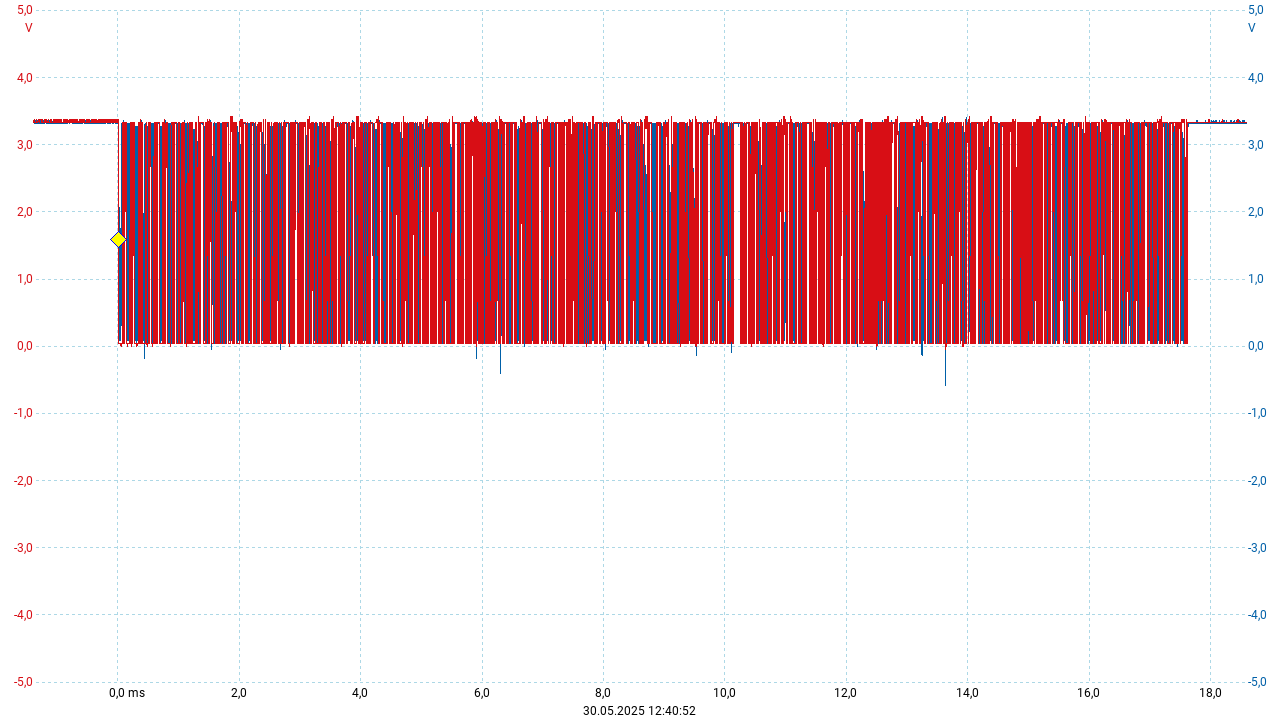

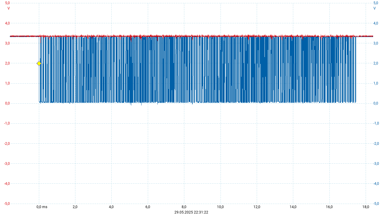

Also no output of the DAC, I tried HW modes #16-18 with both clocks and mute with Pull 1 and 1.
Although I didn't find a clear statement of the SPDIF input voltage, I guessed that the voltage may be too high, so I used a voltage converter to reduce it:
Still no luck.. Have I fried the ES9039? Are there any other ideas what to test? I also ordered the amanero to have an IIS input device, but it hasn't arrived yet.
