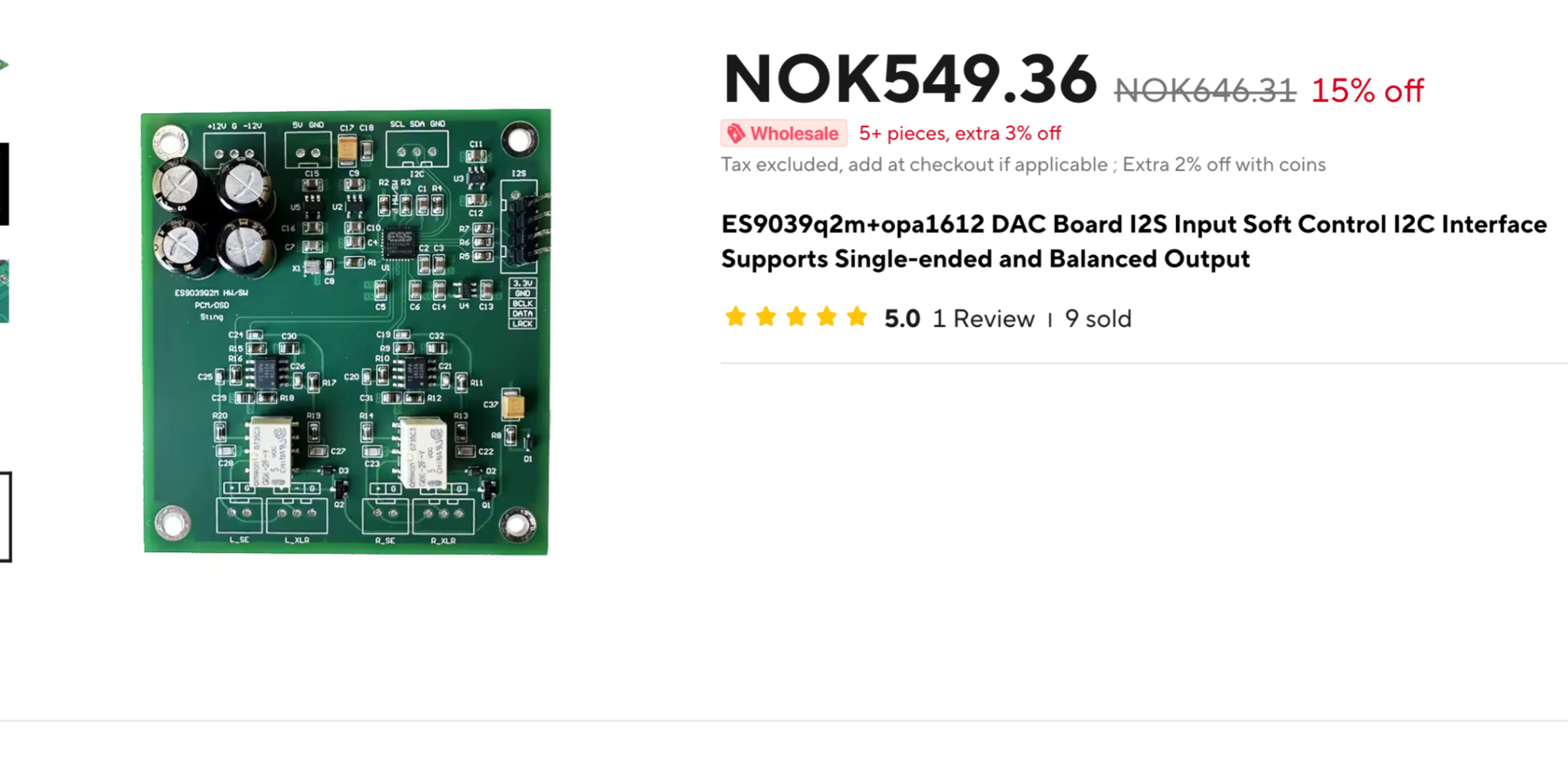

Solved, it was AI mistake in other part of сode to set some registers which should not have been touched at all with errors. Only these register settings are enough to play 3 wire I2S with onboard clock:
Is it necessary to do some kind of restart procedure or something else for the changes to take effect immediately for ex with changing digital filters?
Code:
writeRegister(0x00, 0x80); // Register 0 Bit 7 to 1 Reset digital core (all settings are set to default) - on the off-chance
writeRegister(0x00, 0x02); // Register 0 Bit 1=1 Set DAC_MODE to enable DAC analog output

I have exactly the same board, it works fine in HW mode, but I want to have UI and almost done it with Arduino (even with chosing SPDIF/I2S input). Now solved to run SPDIF in SW mode. It is enough to set just these register settings to play SPDIF with ES9039Q2M:If you would ever need a premade i2s card to measure against, this is made according to the eval. I have used it in hw mode and it measures extremly well with non perfect surrounding components.
Code:
writeRegister(0x39, 0x01); // INPUT SELECTION [0] 1'b1: Automatically determine the input data format
writeRegister(0x59, 0x64); // Select GPIO4 as SPDIF IN
writeRegister(0x2A, 0x08); // GPIO4_SDB Enables GPIO4 input
uint8_t val = readRegister(0x01); // SYS MODE CONFIG > ENABLE_SPDIF_DECODE set only bit 3 to 1
val |= 0x08;
writeRegister(0x01, val);
writeRegister(0x00, 0x02);// SYSTEM CONFIG Register 0 Bit 1=1 Set DAC_MODE to enable DAC analog output
@diyiggy it was here about it
Found easy way to switch between sources. I2S input works fine even with connected active SPDIF signal and with other needed SPDIF settings, just with disabling GPIO4_SDB, so this will be universal code for both inputs, just set register 0x2A to 0x00 anytime to swtich to I2S input without reboot/restart and without CHIP_EN touching.
